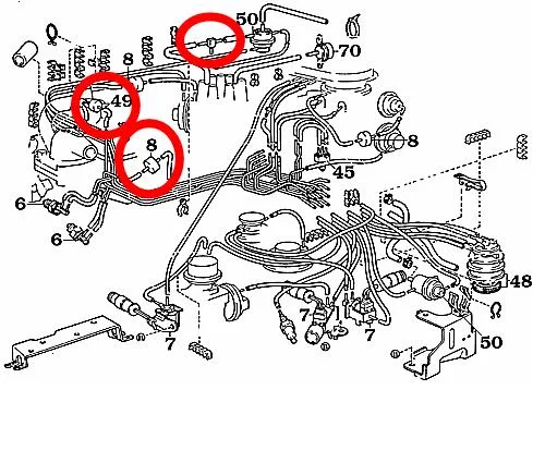

Hello,
While replacing all my vacuum lines, I accidentally broke the blue VTV valve, the check Valve, and a little 3-way vacuum line spliiter or connector, which I can't find online:
Anyone know if there really NEED to be replaced, if I'm not driving at high altitude, really cold weather, etc.? And also, if they do need to be replaced, a good place to get them inexpensively?

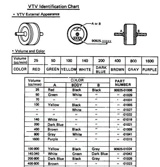

look at the list, they are valves for limiting volume.

Where did you find that chart Beaufort? Just curious as I don't recall seeing it in the FSMs.

it's a page out of the part micros for the fj60.
