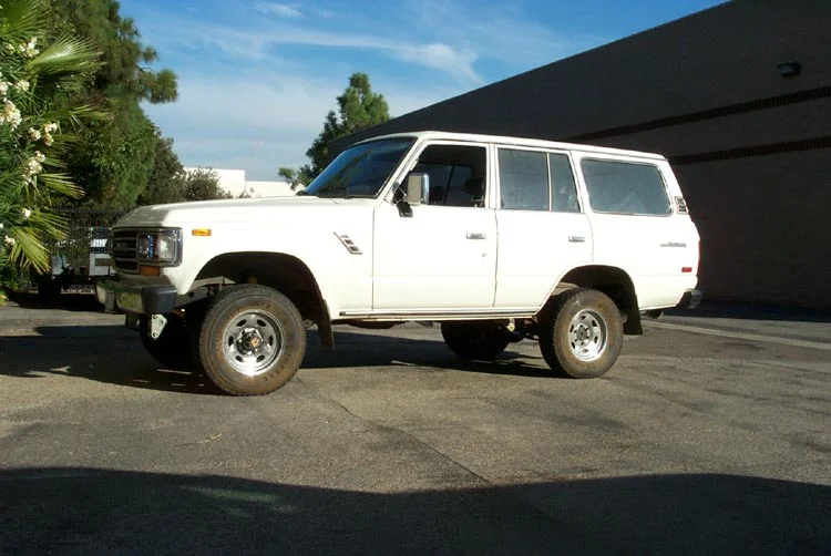

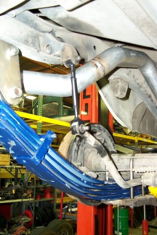

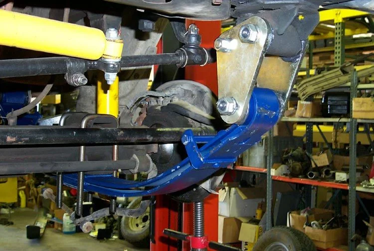

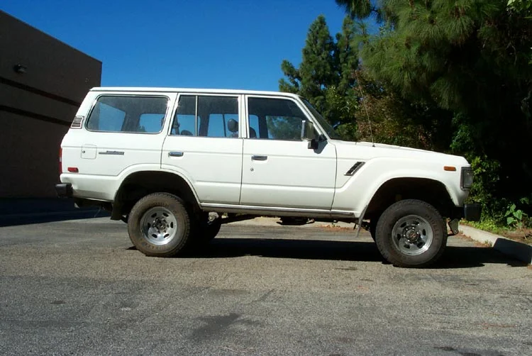

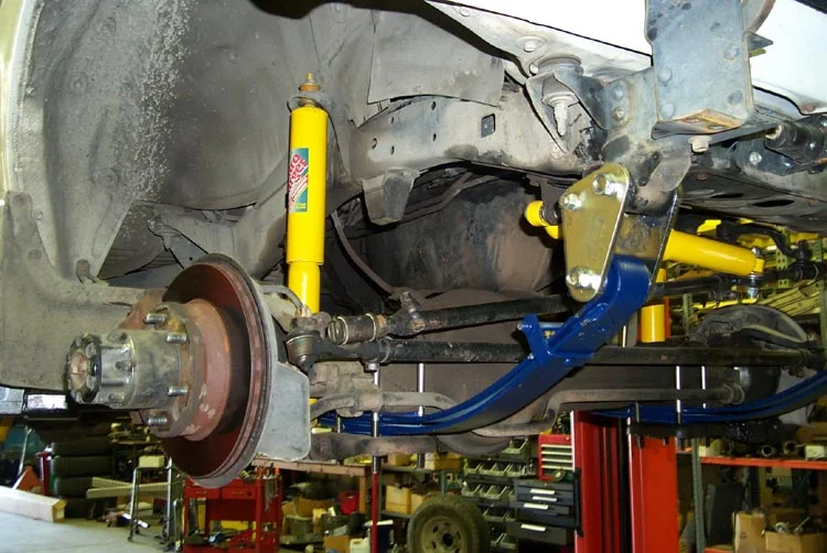

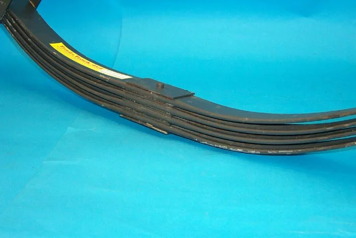

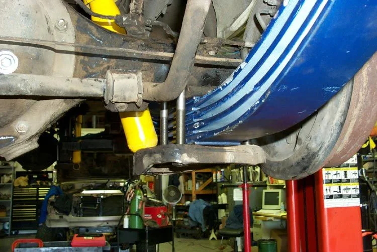

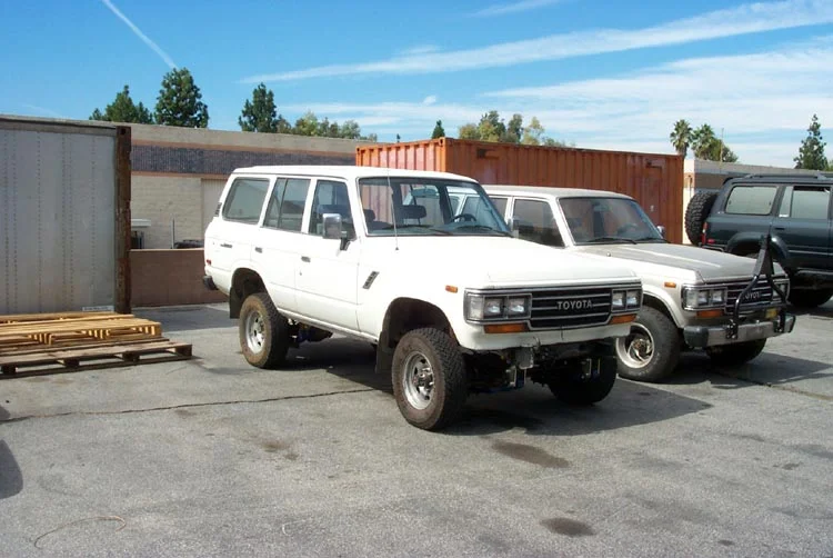

Here are a few shots to calm the mob!
We are still testing the springs, trying different leaf and shock combinations, spacers, shackles, etc. I know it is taking a long time but we want to make sure everything works, fits, and rides great before we start produceing kits for sale.
Thanks,
Steve

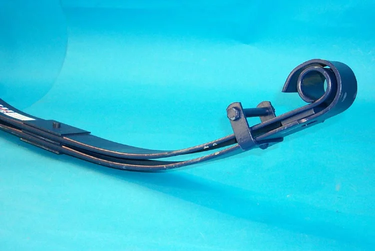

Heres a few more for ya....

last set for today

Are those extended shackles?
Just trying to gauge overall lift with the pictures you posted.
And this doesn't appear like some crazy hi-tech technology. What would deter a stateside spring maker to start to make these upon seeing loss of sales from traditional leaf springs to parabolics?

The shackles are extended, as I mentioned, we were trying different spring combinations. The pictures show a few different lifts actually. We got as much as 6 inches of lift and as low as 2.5 to 3 inches of lift by removing leaves and changing shackles.
I believe the main difficulty in developing these springs is the tapering of the leaves. You can notice that the center of the springs are thicker than the ends of the springs. Parabolics are nothing new to the U.S. market, just new to the Toyota market. A lot of larger commercial trucks are using parabolic springs from what I hear.

The shackles are extended yes, because of the arc of the springs, stock length shackles ending being too short for installation. The pictures show a few different lifts actually. We got as much as 6 inches of lift and as low as 2.5 to 3 inches of lift by removing/adding leaves and changing shackles. We also loaded up the vehicle with different items and people to see what it would sit and ride like.
