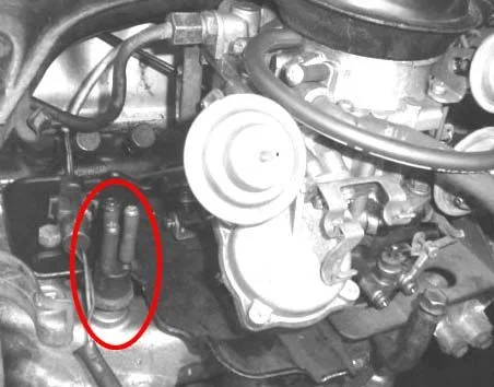

here's a pic
found this pic. this seems to answers my question.
the place where the gas filter went was plugged with a brass fitting that plugged it off. now (i think ) i can complete my desmog! thanks guys!
