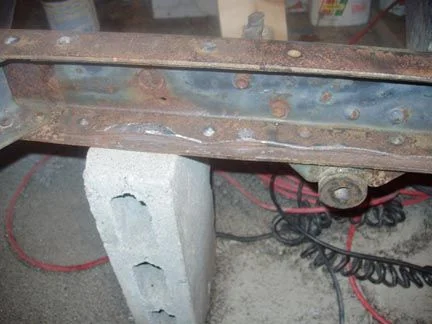

Well after driving my cruiser home I took a really good look at the frame and came to the conclusion that it needs replaced. So I bought an almost rust free cruiser frame from cruiserparts.net. I went and picked up my frame on Friday and started running around picking up some tools and stuff on Saturday. Today was the first day I started doing work.
Today I pressure washed the frame and started wire brushing the paint and rust. I had to buy a new grinder because of course with my luck nobody around here stocks wire brushes for a 4.5in grinder. So I had to down grade to a 4in. I was going to get a 5in but nobody has them in stock. I also picked up one of those cheap sandblasters for $15 from Homedepot. I hope that will make the paint/rust removal go faster. But you know Home Depot they dont stock the sand, so whats the point of selling a sandblaster if you dont sell sand? Luckily I know a place that sells sand they just were closed after I bought the blaster.
My plan is also to do some upgrading as I go. I plan to do an SOA custom bumpers.

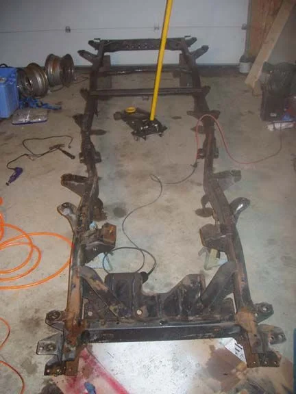

Here are some pictures of the new frame.

be careful with those wire wheels... I had them shoot wires many times. I always wear safety glasses and a shield if possible. with out the shield I have had wires come zinging off and stick in my forehead a few times. If one hit your eye your blind.
If your painting with POR no need to remove all the rust. As the rust will help the por stick better.
Sandblasted is great too for pOR..
Those cheapie snadblaster can really test your patience thou. I have never had luck with a suction sandblaster. They always get clogged.
I used a pressure tank one lately and it was pretty good to use.
If all fails take it to sandblasting business and they will make short work of cleaning it up.

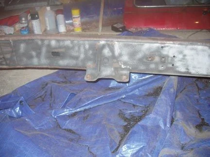

I think you have to rough up the paint pretty good with 36 or 40 grit discs. Then clean it all. Should hold fine. No need to remove all the paint.
In fact since your doing POR, just clean the frame, then rough up the painted areas, knock off excessive rust and spray/brush some Por on. no need to sandblast it all clean. IMOP anyhow.
I think they rust from the inside out more soo. So before you install the frame try to get lots of rust inhibiting oil inside the frame. Spray it in there.

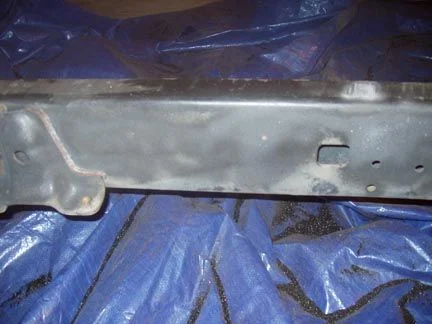

Oh thats good I really didnt want to have to clean the whole frame. I was planning on spraying some POR or something else in the frame. I guess I wont bother with the sandblaster.

I would sandblast the frame if it was all rusty I guess. Or I was going for a show car look. I dunno.... up to you and your wallet.
POR needs a rough finish to stick(it's a really slippery paint) and rust is a good surface for POR. But heavy sandblasted is good too.
I sandblasted my doors with 100% recycled glass, then painted POR-15 on them. It really did stick well.
You can still you the sandblaster. Just sandblasted the areas that have paint lightly. Then they will be rough enough for the POR.

I did some more work tonight. I bought one of the flap sanding discs for my grinder. It worked really well for the first 5-10min until it lost a lot of its grit and pretty much stopped working. So I guess tomorrow after I stop by the Toyota dealer to see if my cruiser is really worth doing this to (my parents, dont ask) I will pick up some sand and try sandblasting. If that doesnt work then I have no clue what to do.

I would love to do this same thing to my 62. I am lucky and everything is in ok condition, but a few more michigan winters could change that. If I take something apart my goal is to make it better, por is good stuff. Go to the website in my signature and you will see some old power wagons. My uncle and I used por 15 and rust bullet on the various ones. They are very similar products, but I like por more.
As for the rust issue, if you have the frame off, you better blast the hole thing. Por will seal off rust, better to get rid of it and do it right.
Be very carful with your lungs during the blasting. Sand is horrable for your lungs, get a resperator.

I bought some sand and started blasting today. It works pretty well. The only problem is my air compressor isnt big enough for this. I blast for 5min let the compressor sit for 10-15min and blast for 5min and repeat. But I cant buy a bigger one. I started by blasting all the way to metal. Then I decided on areas that arent rusty I am just going to do a quick spray over those areas so that they have a good tooth for the por. I dont know what to do on the rear open C channel frame. It has some flaking I will put up some pictures in a little bit.
Up to you.... I have plenty of exfoliation corrosion in those channels. I am going to remove the channels and replace them.
Worth it for the long run. BUT it its minor, you can coat it with paint and get to it in a few years when the money bags are oK. It can be done on the vehicle.
