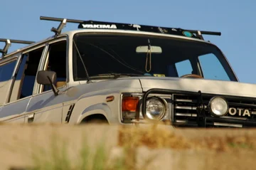

Is it worth it?
My 84 60 is a great vehicle, no doubt about it. But I am tired of worrying about its reliability. Not that its unreliable, but a few things caught my attention and I am wondering if I should sell and strap down some car payments or slowly fix this machine into something great. First of all, my transmission is going (whiny, synchro gone, etc.) My transfer case pushes oil into the tranny, which I have rigged with the feeder hose back into the t.c. There is an annoying exhaust leak that cant be pinned down (you know, tick tick tick) Cant start in morning without choking. Strange sound just behind steering wheel when turning. Power steering pump appears to be leaking slightly. carb blower fan is gone. gas mileage is total crap. Thats all the major stuff. I know this is pretty much standard for cruisers and many of you might say it wouldnt be a cruiser without this stuff, but this is my Daily driver and I am in need of reliable transportation. I am considering selling, paying off some debt, and taking the plunge into car payments. What do you think should be done? Keep it, restore it slowly and hope it doesnt crap out on me at a crucial time, or sell and be hated by you all forever? I know that for the price of a newer truck this could be totally restored into something sweet, but I don't have the time or money right now to work on this truck here and there. I am lost, please help.

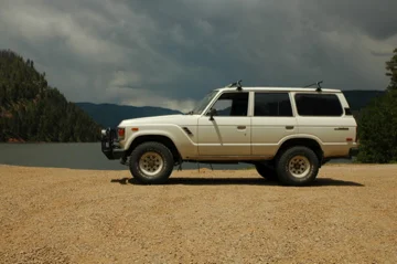

I am located in Durango, Colorado. I suppose I am mechanically inclined, but I guess my problem is I don't have the right tools for doing major work on her. I am 27 and single, so there is a lot of time and money saved right there! I think if I were to keep it, I would want to drop a lot of work in all at once, perhaps new engine and a 5 speed. I love the fact that there is such a community here, thanks for all your ideas, and keep em coming. A 350 huh? I take it that includes fuel-injection (i.e. better gas mileage) How heavy is that engine? As much as 2F? The body is in pretty good shape, minor rust on rear wells, tailgate, etc. I am willing to spend whatever it takes to be able to drive this baby and not worry about every little thing. Any ideas as to exhaust leak? EGR pipe? I have taken it to several mechanics and they all seem to think its a crack in the exhaust manifold, but they cant pin-point it exactly. Looking at my EGR pipe, it is stock and rusted as hell. Regards.
