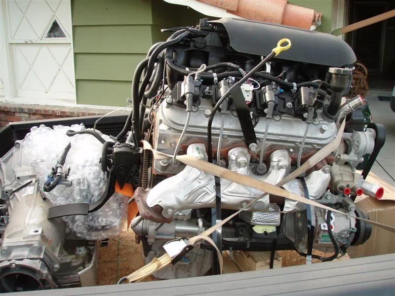

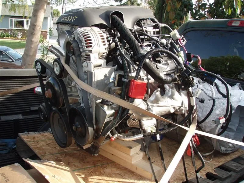

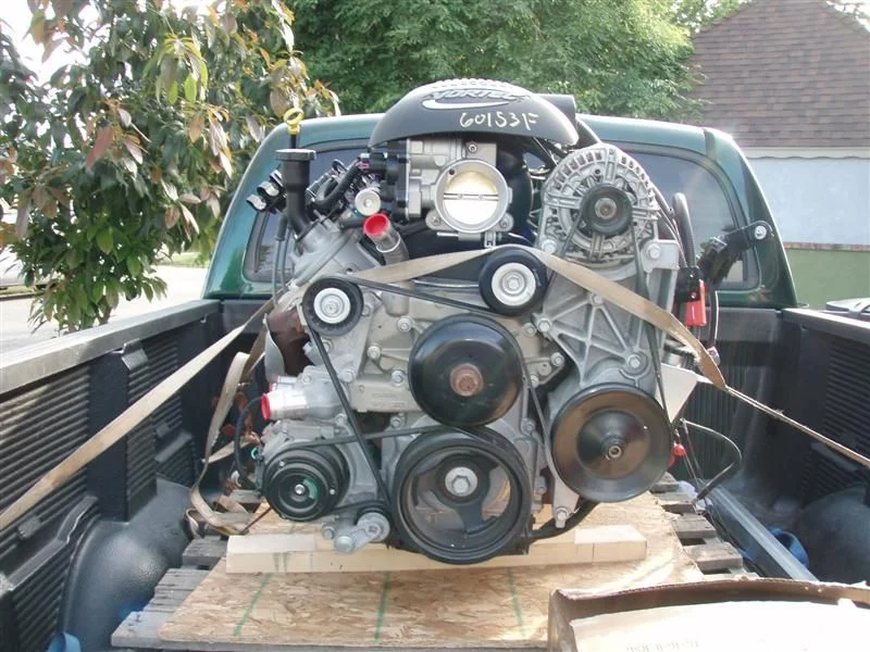

My first ever engine swap.....!!!!!
Ok, so I got me an engine now.
Got the space, some time and some tools ....but thats about it...
Life is grand !!!
Here are some pics of the donor....
I'll post pics as the project snails along

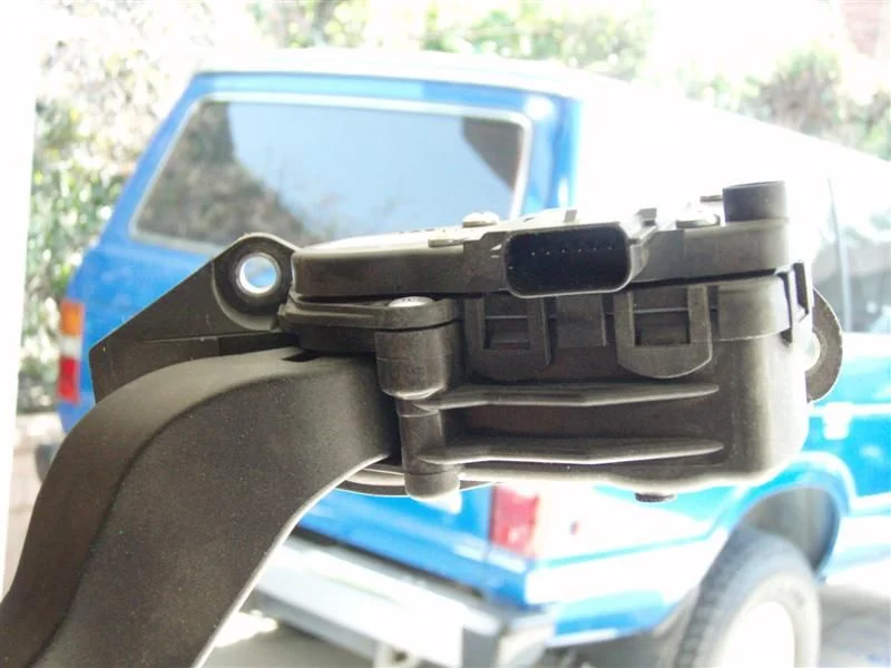

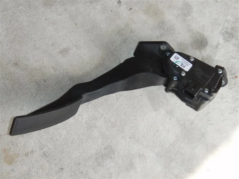

Are you going to run the drive by wire? Or go for the cable setup?

Sorry, Are you staying with the stock throttle body set up? If so you would need to convert your gas pedal setup. If you go with a 99 throttle body you can run a cable actuated pedal. (easier) Sorry about the english, my wife tells me the same thing...

Manuchao, try to go this way- that would be my suggestion...
Ah ok, now I understand... Thanks eh !!
Well, what do you guys think?
The engine I got came with the complete pedal mechanism....but I hear what you and Philos1 are saying loud and clear and yes Im trying to keep this as easy and cheap as I can....

Manu -
Dunno how tall you are, but you can get an extra 3-4" of leg room with a Lokar gas pedal by poking the arm through the original hole for the Yota throttle linkage (obviusly ditching the drive-by-wire, or maybe that would be easier).
I modified the brake pedal & mounted a Lokar '55 Chevy pedal pad to line up with the gas pedal correctly. Then I put a LX470 dead pedal against the kick panel. It's now comfortable to drive since my right knee isn't bent up to where it hits the steering wheel.
For a real subtle look, a Lokar shifter through the stock hole & boot will make most folks think it's still a stick.
By the way - you'll like the 4L60E. But if it came out of the same 4x4 you'll need to change a shaft. AA has them.
My 5.7 turns 2,200 rpm at 75 mph with 4.11s & 33x10.50 MTRs. Better everywhere except when you want complete control over the RPMs, like downhill.
__________________
"His mudder was a mudder".
Tinker is offline   Reply With Quote
Old 04-26-07, 08:52 PM   #28 (permalink)
No way Eh !!!
MANUCHAO's Avatar
Join Date: Nov 2004
Location: c0vina, CA
Posts: 1,067
Pedal Pics
Here are the pics of the pedal...
iaintscared...I'll have to look at the AA website. I believe yah bro. I dont have the catalog....... Yeah it sounds like a lot more mods are in order for this swap.
Dynosoar, if I dont use or can't use the tranny I'll have to go auto and yes you would have first dibs on it...
Shane, it crossed my mind on that other thread but I did not want to address it...(stick my head in the sand and hope it goes away) but you are absolutely right..
I better call and find out....but I already get the feeling that it is a matter of how you interpret the law and also who the refferee will be at the time of checking the actual work.. Thanks for the info on Pierce College.
Im trying to pull the whole engine/tranny/tc together, along with all the smog stuff... ya'll think I'll be able to unplug the smog stuff from the fender and just throw in on top of the engine w/o snapping/damaging anything?....
Engine will probably go for sale some time this year.......
Tinker, thanks for all that info. iaintscared mentioned the Lokar gas pedal and the outputshaft on the A/T. I'll have to look into it some more.
I have seen the Lokar shifter and it does look nice. I also read up on Marks Adapters out of AU and they sell one too specific for the FJ60. Maybe AA carries it, we'll see.......
2,200rpms at 75mph on 4.11 eh... Dang that sounds nice....

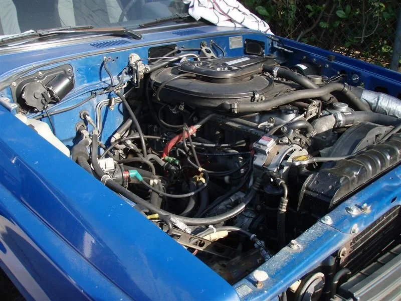

your engine bay looks better than mine. and your doing a swap. haha. how many miles are on the 2f?
