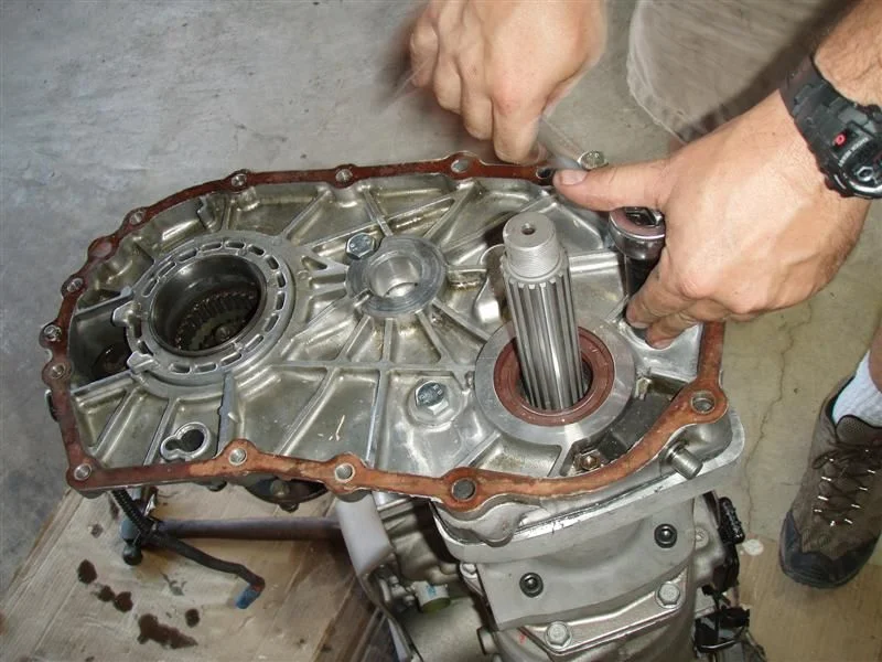

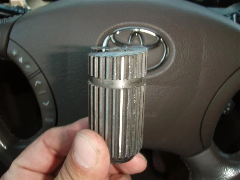

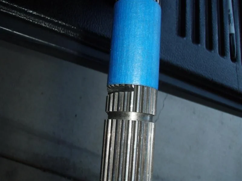

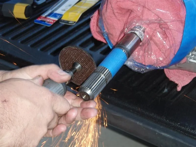

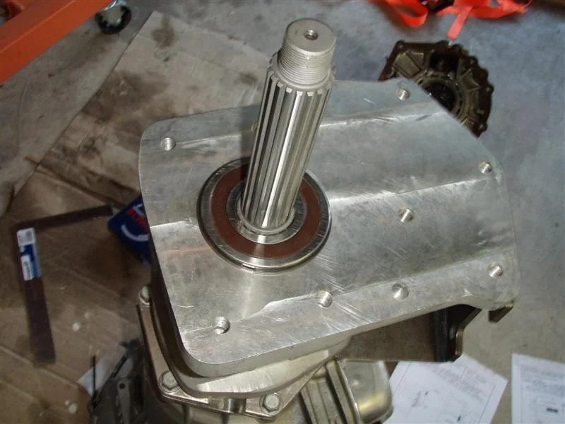

Outputshaft measured 5 ½" long from 4hole adapter ....................
Cutting...............
Cut !!!!
Dynosoar has mad skills when it comes to cutting ....Used a cutting grinding wheel proved to be the fastest and most efficient way to do it...shaft was grind flat and a tad short maybe 1/16".........

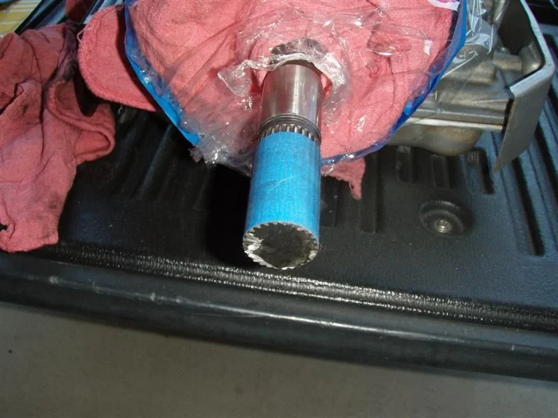

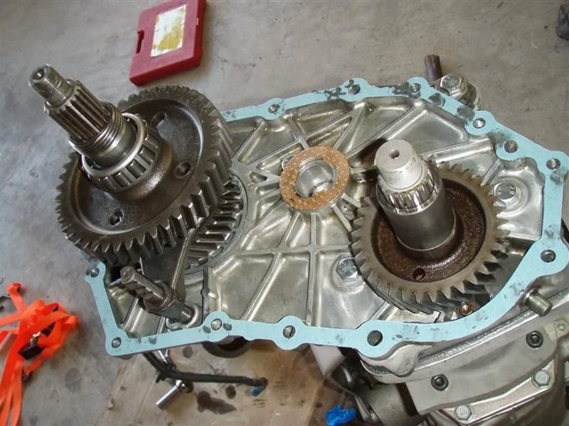

bearing pressed into adapter and spud shaft
Putting it all back together
New seals and silicone....

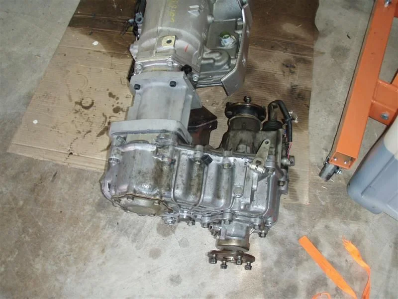

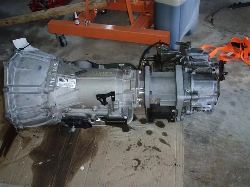

Done...!!
Dynosoar.....thanks for the help eh....yah make it all look to easy....
Notice the clearance (issues to come) on the front drive shaft and tranny oil pan.....
I got my adapter from Downey...they where on back order and ended up with a advance/downey adapters.........
SUGGESTION: get your whole kit from one source....yeah I know Downey and AA swap theirs all the time....however I ended up with missing hardware and some of the bolts where too long and had to be cut ¼".......Im sure one can do without the extra work eh !!!
Onward !!!!

wow. no kidding on the tight clearance with the driveshaft/trans pan! hopefully it all goes well, but IIRC the Tcase side of the shaft is pretty skinny so....
looking good though.

Ditch the shielding on the tranny. It is close but the clearance is there. but man it looks good. I will have to do another thread you are making me look bad!
Yeah, I'll put that out. Hey man, Im just a first timer trying to document as much as I can.....but really Dynosoar is the Sensei here....Im just the little grass hopper learning lots of things....

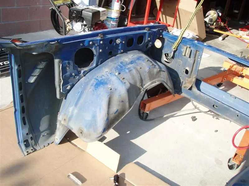

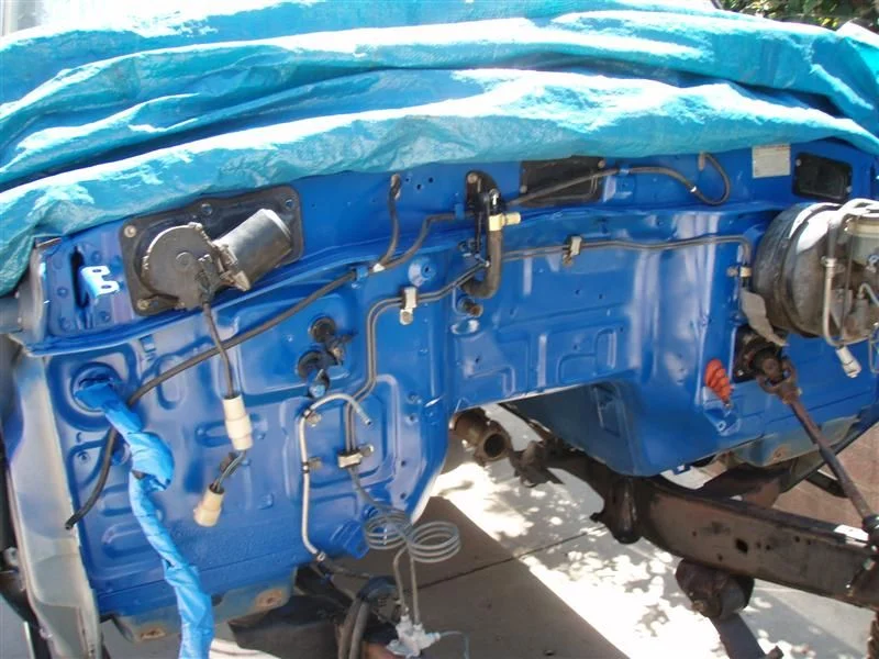

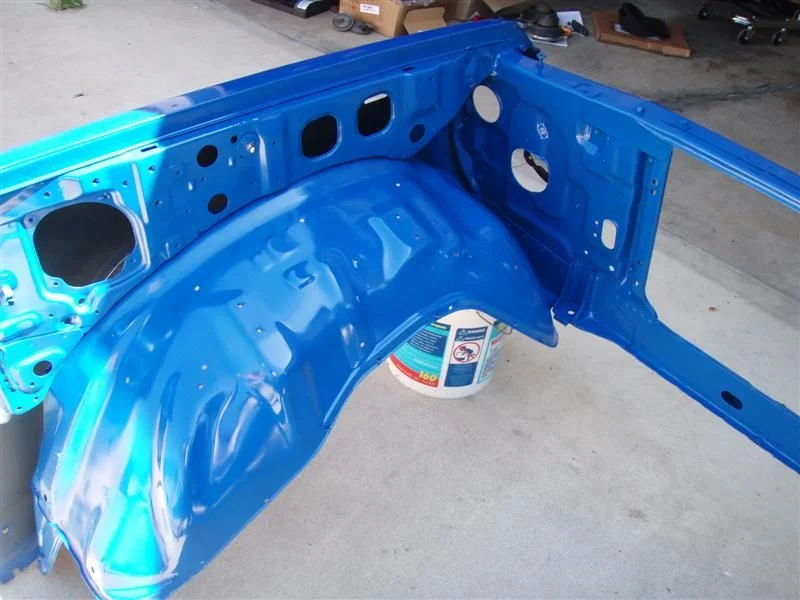

Since Im waiting on my Gear box and exhaust manifolds.. I went ahead and painted the engine bay... Why ??? Cause I can !!! HA !!!
Before and after
__________________
MaNu !!!
'85--FJ60-L59
E-mail: viviendo.de.mar.a.cordillera@gmail.com
manamana tút turút too manamana !!!!
MANUCHAO is online now   Reply With Quote
Old 08-29-07, 04:02 PM   #108
No way Eh !!!
MANUCHAO's Avatar
Join Date: Nov 2004
Location: c0vina, CA
TLCA# N0PE
Posts: 572
I used two spray cans from http://www.paintscratch.com/ and bought the clear coat (3 cans)from Autozone.........
The color match is close but not perfect...since it has 20+ years on it....
The front of the engine bay (where grill goes) will be POR 15 and so will the lower sections of the wheel fenders where the mud flap goes.......and the frame too...
Im stoked about this project things are coming along VERY slow but really good...
I also pulled the housing for the headlights and every single bolt snapped on my so I got to drill them out and tap them....whoohoo
Before and after pics...
Laters,

WOW! the spray can pain job looks great.

Wow that looks GOOD!

Quote:
Originally Posted by iaintscared1969 View Post
Very nice Frank,
NOW YOU ARE LEARNING THE BLING EFFECT!!
Oh so that's what that is eh.......
Well that'll be inner bling..cause that's all Im painting...
Quote:
Originally Posted by mel lowe View Post
The paint looks great......
Are you painting the frame as well?
Quote:
Originally Posted by klinetime574 View Post
That paint job is awesome.
Quote:
Dynosoar
Quote:
Yeah Im doing the front section of the frame, battery tray, skid plate, gear box cover and other small items with POR 15.
Thanks I never thought it would come out this good... (specially out of a spray can)
I had to power wash it and the scrub all the grime off of it before I spray painted it...
Nice little (mod??) project I think I spent about $75 on paint, tape and paper for the paint job...
Im sooo tempted to pull the whole chassis out under the body and do a complete restoration on it...not that it needs it but now I can't help to think this will be a half ass job since Im only doing the front end of the frame..... I really wish the day had 30 hrs instead..
Thanks guys...
