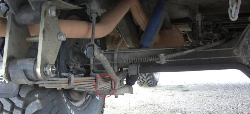

Left Rear leaf is obviously cracked...

Glad that rig went to you and not to them other members that pull the whole cabin out and replace it with a roll cage.... too clean for that .... and If you don't get it scraped or rolled, I wont laugh... just glad your keeping it clean....

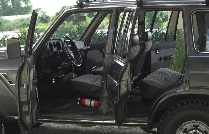

Posts: 2,577
Very nice 62! It will be nicer with the round eyes.
Just noticing the shackles are greasable and appear to be anti-inversion so some suspension work has been done. Maybe I missed that you did it but with cracked springs I would guess not.

BG_TX - If you want more time before the HFS, as a temp fix to the break, I've got my old springs sitting in the garage. I'm headed your direction in the next couple weeks and can drop it off.
Let me know - you're welcome to them if wanted.

Thanks Gas-A-Lot... I want to keep the rig as 'original' in appearance as possible but still capable of some mild off-roading. Most of the mods I plan on adding can easily be removed if I ever need to take it back to near stock condition.
FR4x4 - you are correct, the shackles were added by the previous owner. I am replacing the current shackles with HFS greasable barbell shackles when I tackle the suspension.
Bridges - excellent offer! I really appreciate the gesture but I think if I am going to replace one pack I might as well do them all. I was going to put off the suspension replacement until fall due to the Texas heat but it won't wait that long. I assume it will be installed within the next month providing my buddy (heap owner) is willing to sweat off 30-40 lbs helping me with the job.

That 62 is beautiful. Only 5k? A guy down the street from me was trying to sell his 62 for 5 with tranny issues and quite a bit of rust.

Good Gosh that is a clean rig.
Glad to see wrenching on it is a family event. Makes it easier to buy tools and parts.
