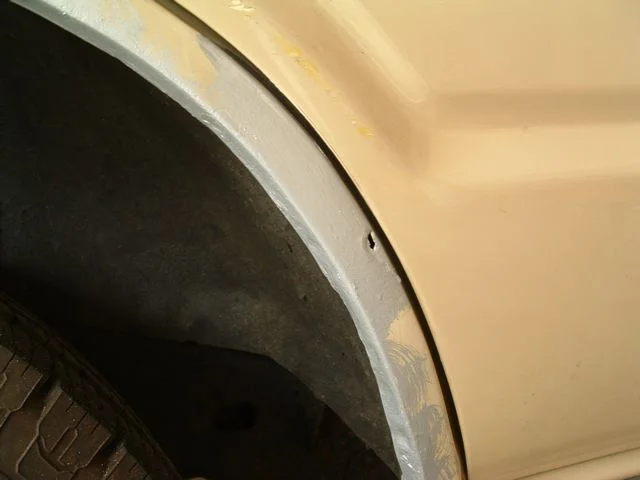

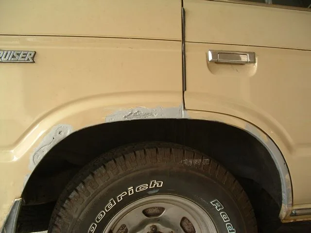

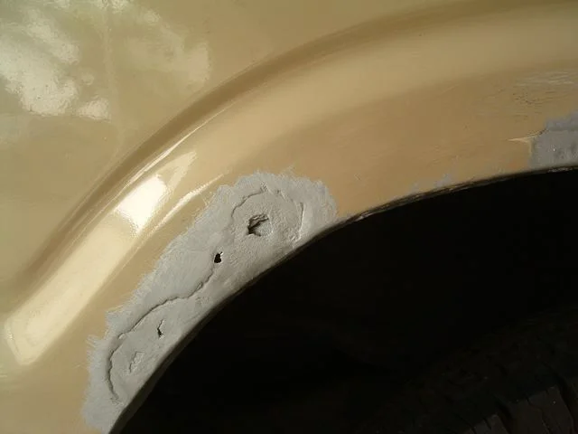

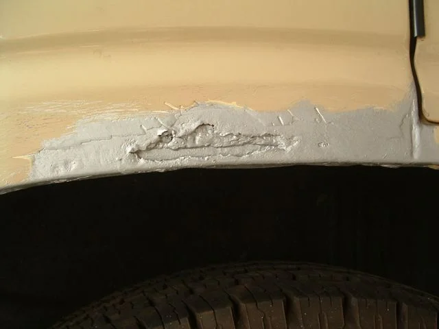

Hi,
Bought an 87 60 from Salt Lake City and brought it back to SoCal.
I finally have some free time to tackle the rust on the rear wheel wells (you could see the bubbles) and it was much worse that I thought.
Scraping the rust off, the PO used bondo? (it's like a thick jelly), and just painted over. Well I didnt know this, and now have some small chunks missing in my rear wheel well.
I RustBulleted there and the other spots with surface rust, but I cant figure what to do next.
Is Bondo a good option?
what about these things they sell at SOR (http://www.sor.com/sor/partpict.tam?...ender%20Flares
I have zero welding, bondo, bodywork-type experience.
What is the best option considering cost?
I dont mind some elbow grease and a long Saturday, but is this something a bodyshop can weld and make beautiful for cheap.
Just wanna know the options to fix the holes that the rust caused, and let my Cruiser breathe in the lovely salt-free SoCAl air.
thanks!

I Posted some PICS
Here is one more pic of a tiny hole. PLEASE SEE THE NEW PICS IN THE ORIGINAL POST.
Whats the best bet to fix all of these. I really cant drop hundreds of dollars here for this one problem, so I am hoping there are other ways under $200 (and thats on the high side).
Also I dont see myself leaving SoCal, so salt on the roads wont be a problem anymore.
Thanks
