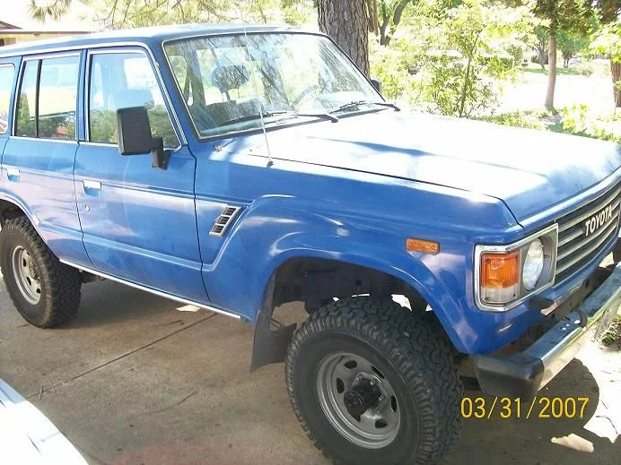

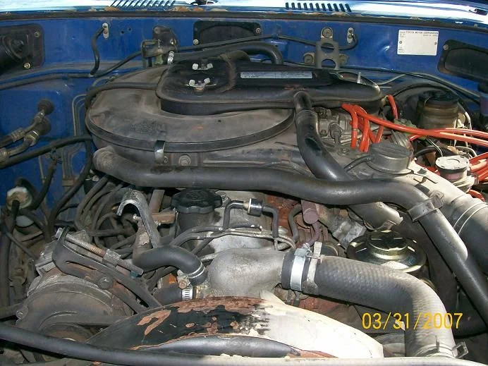

Meet the mistress
A few pic's of the fj with the current 2F.

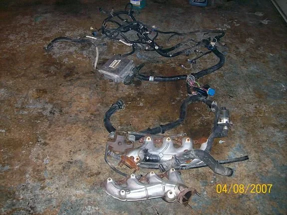

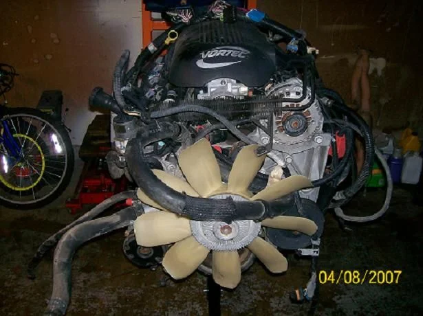

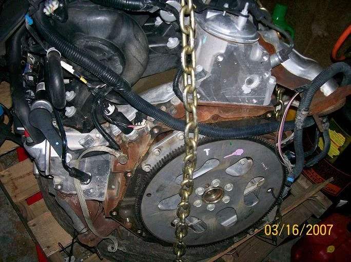

What's under the...
5.3L vortec out of a 2002 Tahoe. And the Downey adapters. AA headers and motor mounts.

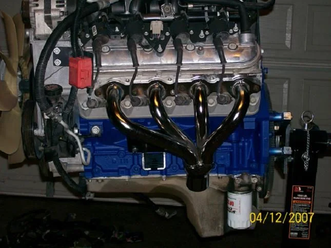

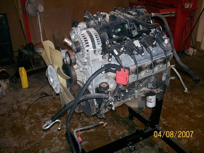

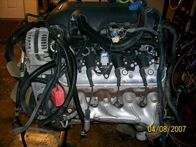

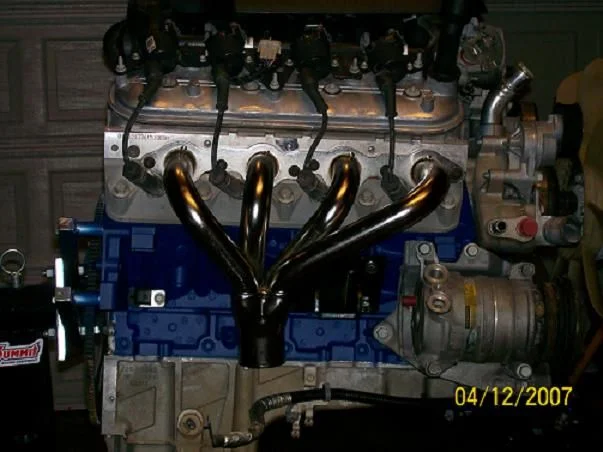

Engine On The Stand
Here's the engine read to strip down. Wiring harness, Exhaust mainifolds and riser are coming off.

Posts: 1,886

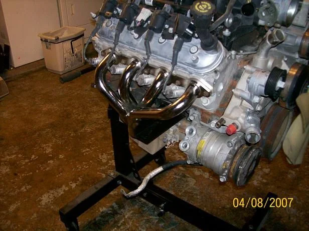

The junk pile and eng. mounts and headers
New headers and AA eng. mounts. D.S cut 1" off.

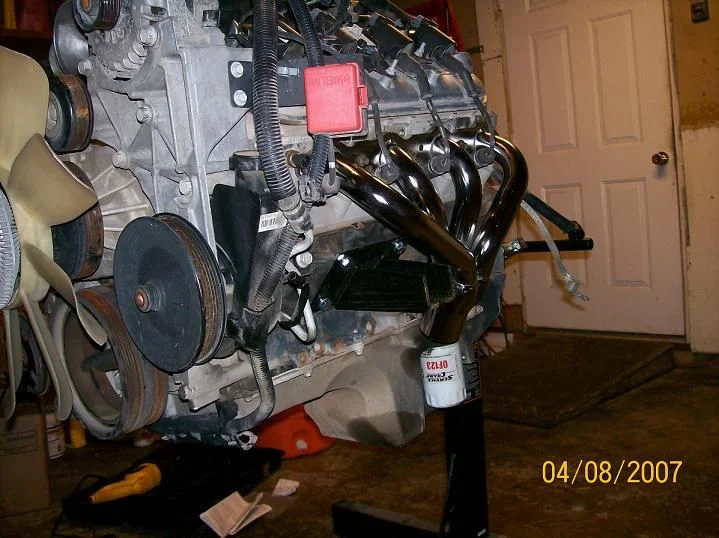

Other side header and mount
P.S header and engine mount. This one had a broken exhaust bolt. Get it out now or forever hold my peace.

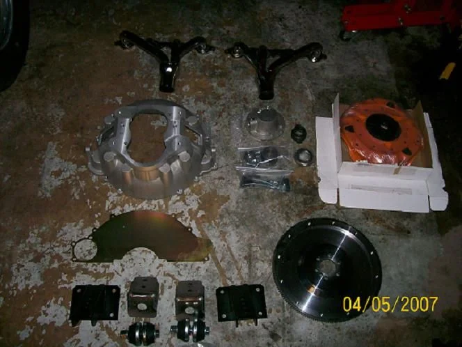

Tonight Bell housing and clutch
Tonight I will get the bell housing and clutch together. Get it ready to mate a 5 speed to it.

OK cleaned it up a little...
After thinking a bit I figured I would clean it up a little...
__________________
Cool place to get all the cruiser crap you could want! http://cruisercrap.com
And if you want a Vortec: Randy@RTCustoms.net
1989 FJ 62 4" Hell Creek Suspension, Bridgestone Duellers 33X12.50, Sliders, HI-Lift, Pioneer equipment Rack, HFS 2.5 Shackles, Defender Light rack, 4 KC Rally 800 series lights,TaskLED, Warn 8k, and 10k, Dual Optima's, Mean Green Alt. 74mm TB, First responder kit, Safari Snorkel, Manaliveoffroad bumpers, Trail Gear Armor, and a whole lotta stickers!
Member: LSLC, DFW and Austin, BSLCA
My Smugmug galleries: http://iaintscared1969.smugmug.com/
iaintscared1969 is offline   Reply With Quote
Old 04-12-07, 06:19 PM   #25 (permalink)
No way Eh !!!
MANUCHAO's Avatar
Join Date: Nov 2004
Location: c0vina, CA
Posts: 1,065
Drooling !!!!!
Nice color !!!

Awesome Project. If You Have Some Extra Money When The Project Is Done, Look Into A Magnus Supercharger. I Have Installed Them On 6.0's And 5.3's And 1 4.8. Holy Cow. You Want Some Bottom End Torque That Is Extremely Driveable This Is The Best Supercharger On The Market For A Vortec Motor. Magnus Will Actually Give You A 3 Year 36k Warranty On The Motor For And Extra $300. About 6k Installed. 4100 For Kit.n Just A Suggestion.

I would!! I have always liked the chargers. Put one on my 454. Big torque mean sound and just looks GOOD!

Quote:
HA! this conversion is taking all my "extra money"!! Besides, I'm not THAT power hungry.....I'm just super pleased with the blue bling!

Needs hose wraps now
Now all you need is a dress up kit in stainless and blue for the hoses. Gotta make it match.
