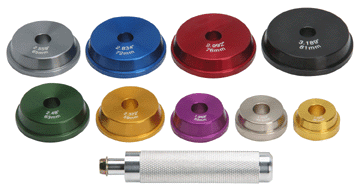

You can get a race & seal driver like this on from harbor freight, other online places or your local parts place. (Lisle and KD sell them). If you take the plunge be sure to go for the set that goes up to 3.18" so you'll the big ones for rear axle seals, etc.

I used loaner fron Autozone. Looks just like the one above. no color, just
aluminum.
