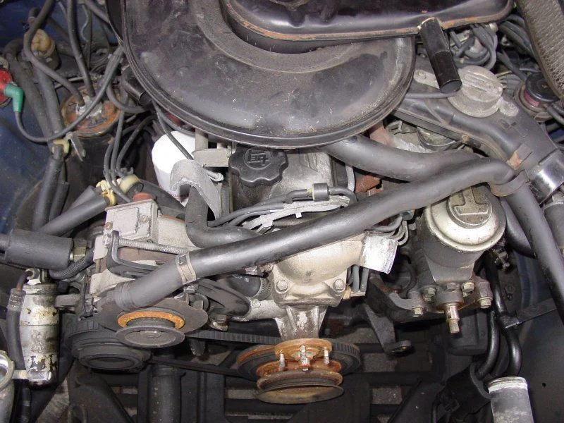

Missing Parts - Can you tell me what I need just by looking at this picture?
OK - I am buying an 1987 FJ60 (detailed elsewhere) and the current owner has removed various parts from the engine, I can see that it needs a smog pump, fan, fan shroud, radiator hoses and a pulley. What else am I missing? I do not know the 2F engine well enough to just look at it and say - A HA!
So, i thought I'd turn it into a Where's Waldo for all you regulars!
I am trying to get my arms around how much all this stuff is going to cost me....any hints on the best place to get this stuff or upgrades I can make are more than welcome!!!!!
Sorry I only have the one good picture....
Thanks in advance...

Fan clutch and blade and shroud
power steering pully
smog pump
alternator belt
ps/smog pump belt
i'll have to look again
upper rad hose
i see a missing smog hose from the air cleaner to pump.
you dont have the cold air intake hose to the air box
