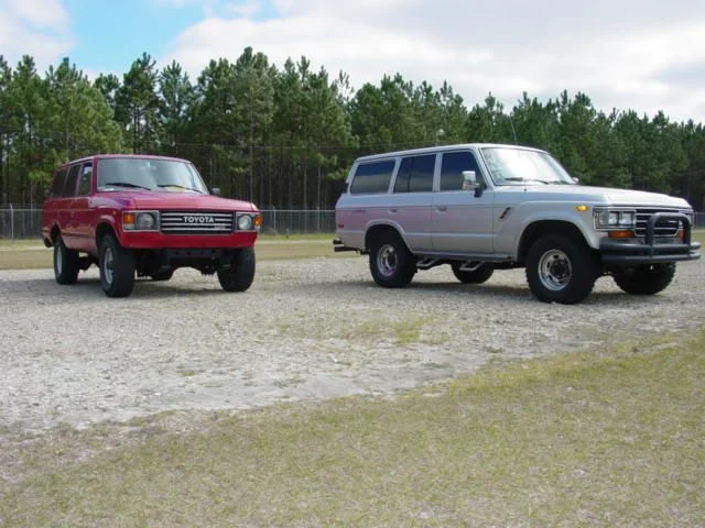

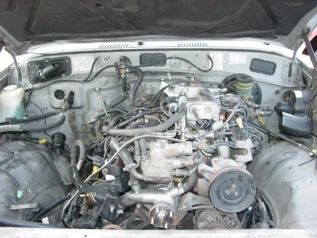

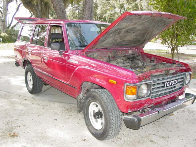

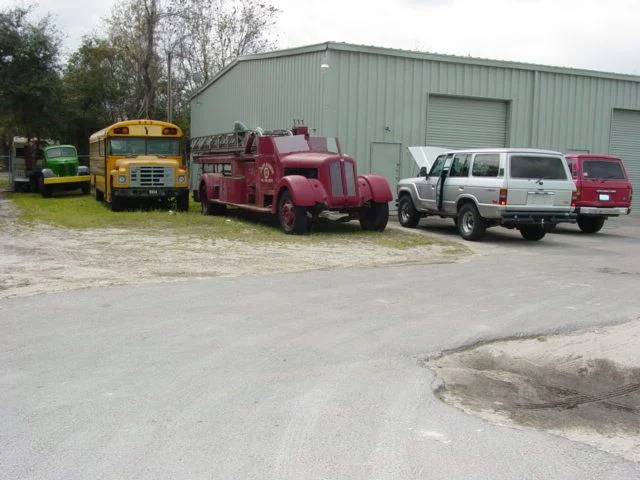

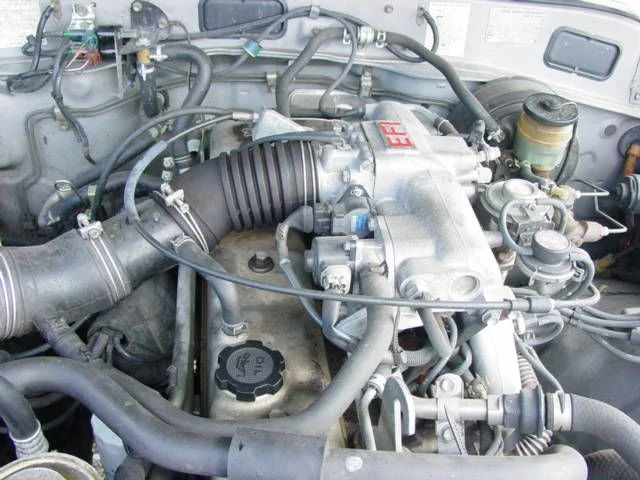

I am pulling the 3fe/a440 from my clean 62 and installing the 3b/h42 from my RUSTY bj along with a Garrett/Mercedes t3 turbocharger.
I am building a dedicated family daily driver.
3b diy turbo question - IH8MUD.com Forum
Here are some pics:

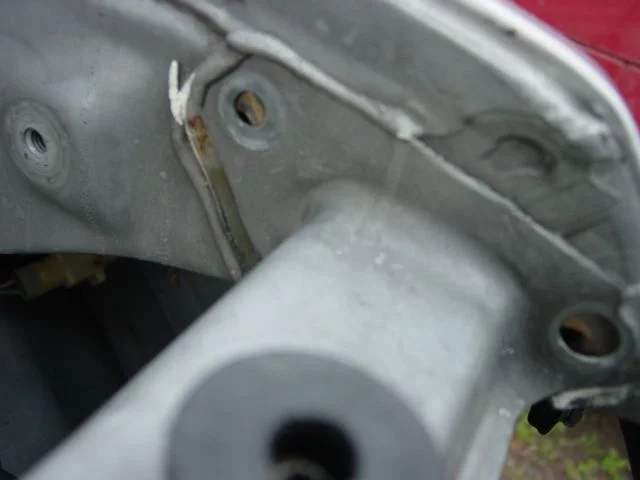

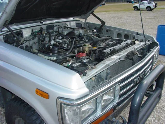

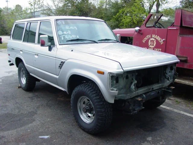

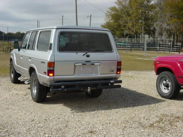

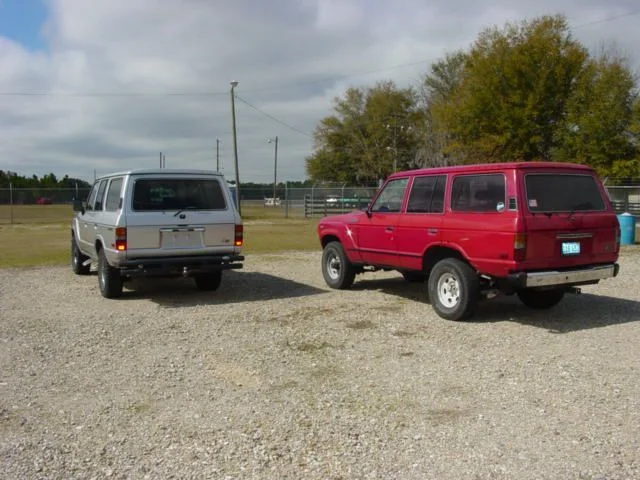

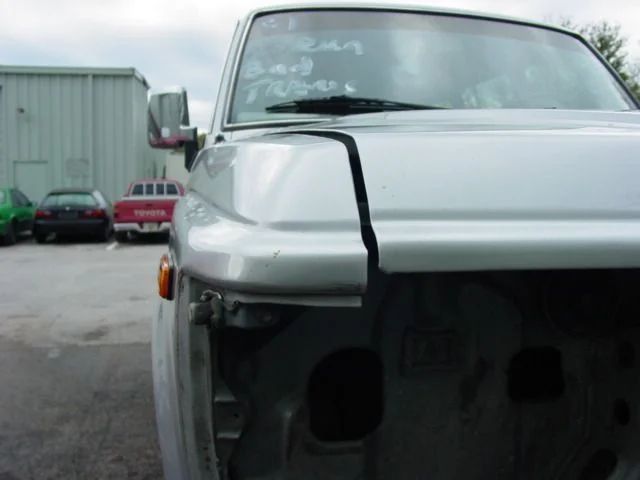

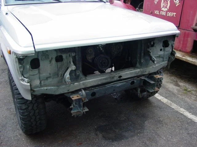

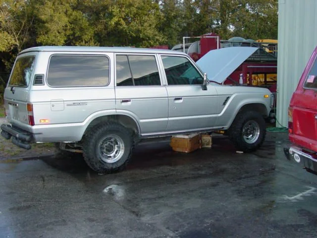

The bj has some serious rust issues and a great drive train.
The fj has a seriously nice everything except the transmission and side steps.
NO RUST!!!!!!
It has been in my North Central Florida its whole life.
I am the third owner.
The two previous owners kept it in TIP TOP condition.
It has always been garaged.

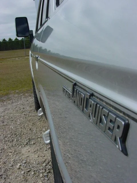

The steps are the 1st to be removed.

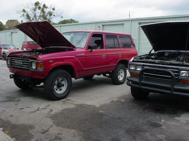

bj pics

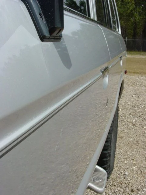

were those steps factory? never seen those before.

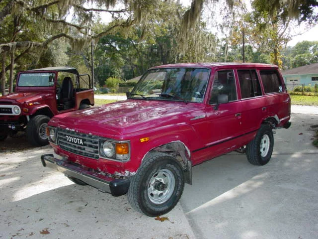

koop is offline   Reply With Quote

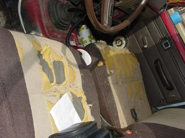

Old 02-26-07, 09:07 AM   #7 (permalink)
North Florida Cruiserhead
mel lowe's Avatar
Join Date: May 2005
Location: The Sunshine State
TLCA# 19409
Posts: 2,034

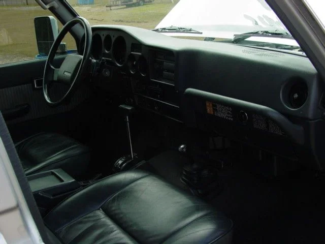

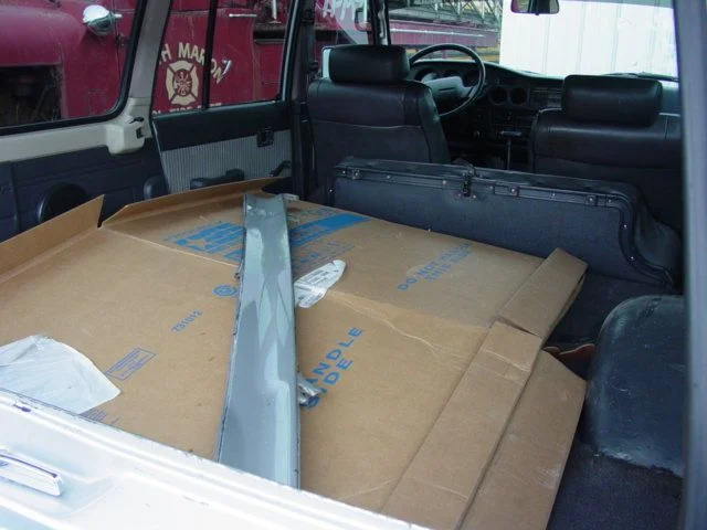

62 leather interior w/ heated drivers seat
Note the manual windows and locks. The rig was built 2/88.

Old 02-26-07, 09:12 AM   #8 (permalink)
mel lowe's Avatar
Join Date: May 2005
TLCA# 19409
Posts: 2,034
Quote:
after market
similar units can be found on ebay
__________________
82 Fj60 - 2F, 37"s, Toybox, Daily Driver, 62 Frame, Lights, Grill and Roof
http://nfcruiserheads.org/forum
mel lowe is offline   Reply With Quote

How do the steps mount? Would you be willing to part with them? I could use some for the moment.

Steps are gone.

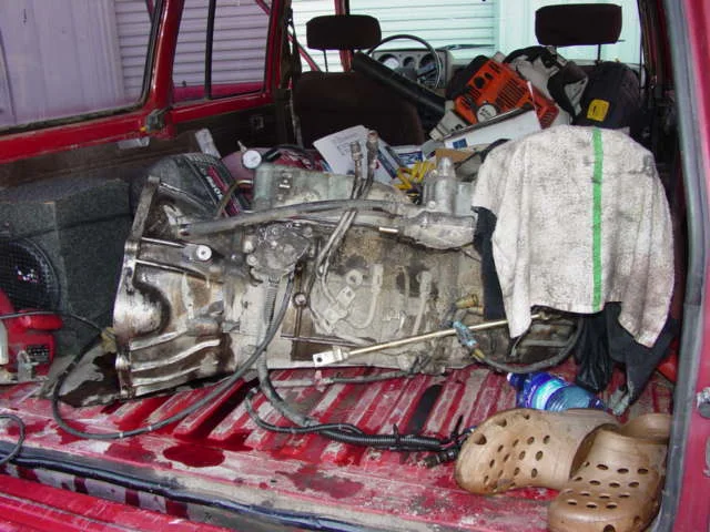

h42 is being transfered form the 60

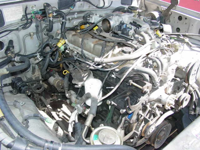

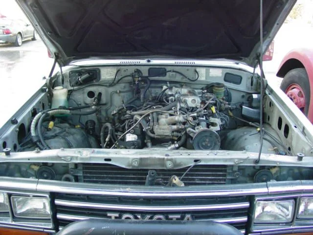

Old 02-28-07, 12:05 AM   #13 (permalink)
mel lowe's Avatar
Join Date: May 2005
TLCA# 19409
Posts: 2,034
[QUOTE=lowtideride;1894024]Looks like fun man...keep us posted.
-Al[/QUOTE
Lemme know if you need the radiator core support from the 60.
It is perfect. :EDIT: it is not so "perfect" sorry AL

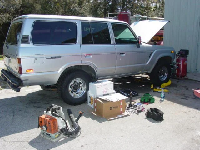

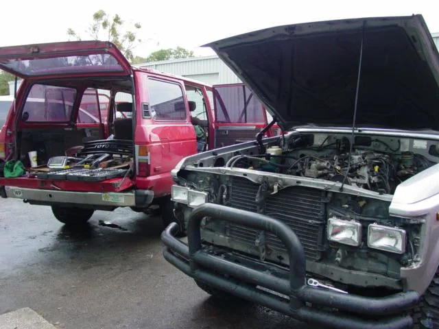

So far the conversion has been a blast.
I am working out side and the weather is great.
Today I ripped in to the 62 @ full speed for 5 hours.
I managed to get this all done with my basic tools from sears/walmart.

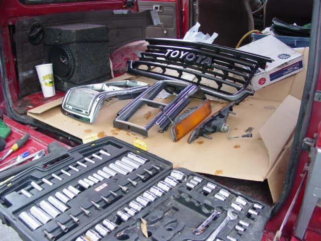

I removed:
spare tire and bracket
skid plates
heat shields ( to be reinstalled)
hitch
drive shafts
battery/ tray
radiator
air cleaner
transfer controls
starter
complete exhaust
gas tank
transmission and cross member
transfer
fan/shroud
cpu
harness
__________________

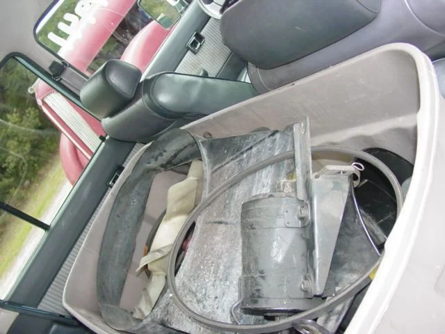

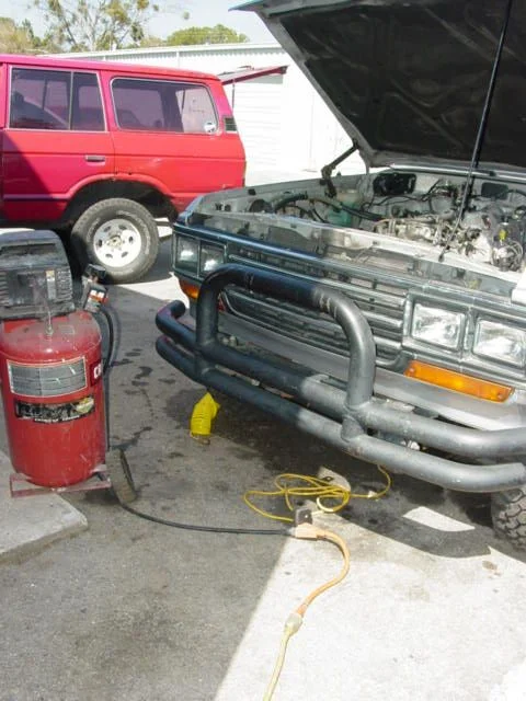

My compressor lost a wheel
DOH!

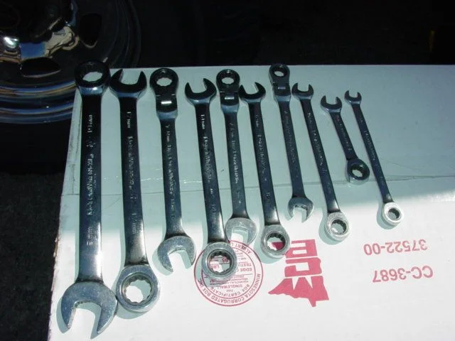

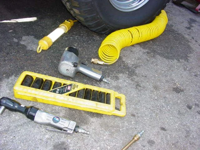

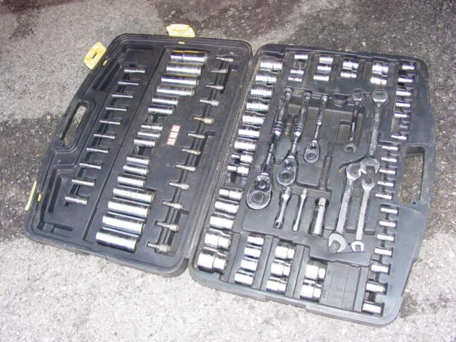

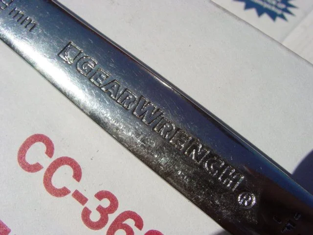

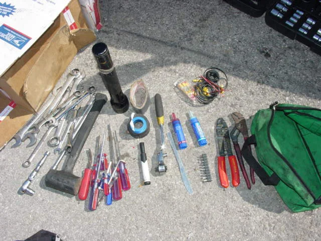

You gotta get a set of "Gear Wrenches"
Dont get the imitations..... they don't work so well.
I am able to cut work time with these tools.
Although I have never broken one,
Sears, Napa or Lowes will warranty them if needed.
I have a few flex ends, stubbies and most popular metric sizes for my cruiser.

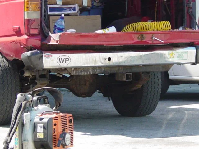

more pics
note blower
keeping the work area clean

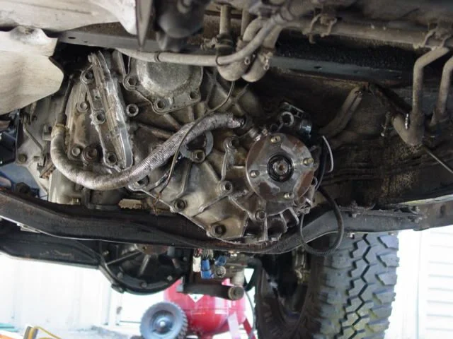

Old 02-28-07, 12:16 AM   #17 (permalink)
mel lowe's Avatar
Join Date: May 2005
TLCA# 19409
Posts: 2,034

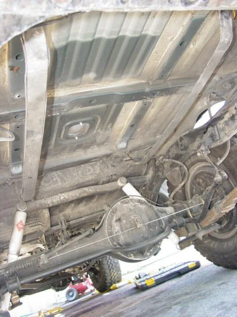

more pics

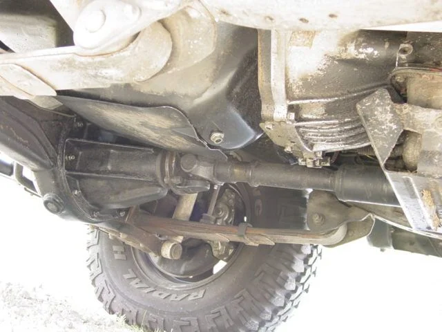

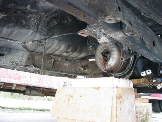

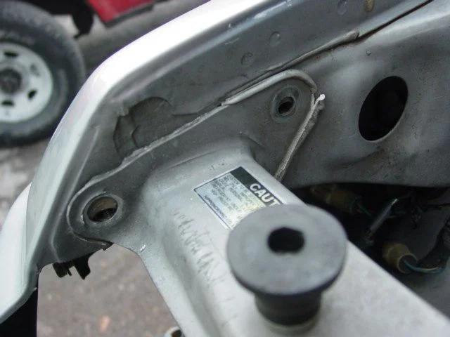

I learned today to unbolt the converter BEFORE dropping the trans.
I damaged it while removing the transmission. (see pic)

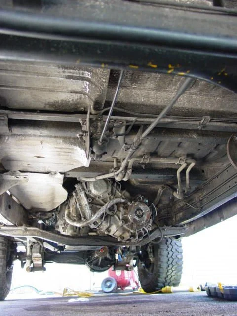

Old 02-28-07, 12:21 AM   #18 (permalink)
mel lowe's Avatar
Join Date: May 2005
TLCA# 19409
Posts: 2,034

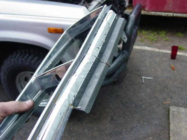

more pics from today

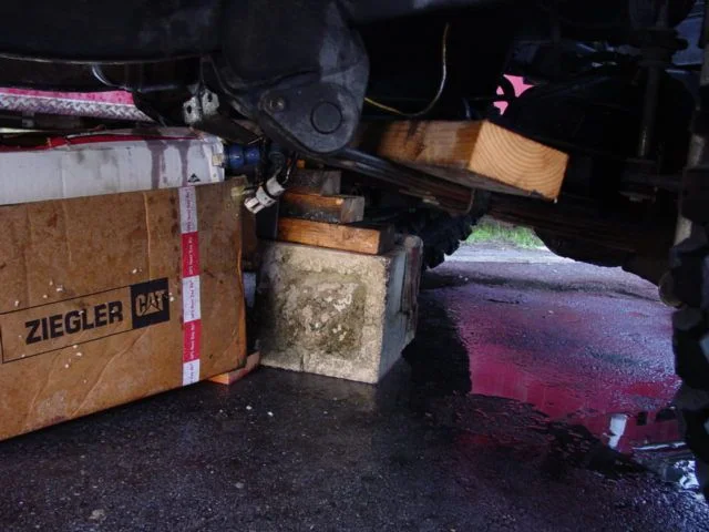

I used a 2x4 between the front springs to support the rear of the engine.

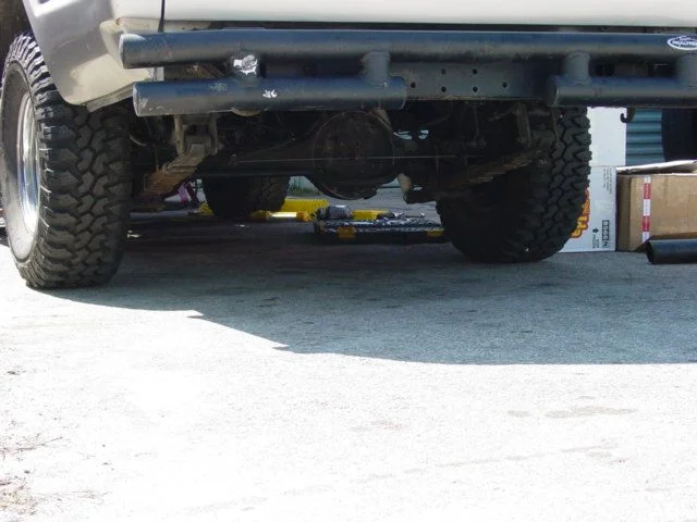

I also stuffed a cinder block and some 2x4 chunks under the pan
Nothing fancy here

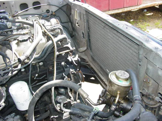

The auto was freaking HEAVY!
I gained about 1" of lift when I removed it today.
Note hose job on parking area... gotta keep it clean
The 3fe is ready to be picked.
here is the donor diesel from my 60 sans turbo
http://www.youtube.com/watch?v=9wrghzbYBz8

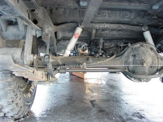

I am NOT going to install the draw tie from the 60 on the 62.
It is too rusty.
note "lcr4wd" decal - thanks Steve for your dedication to the site

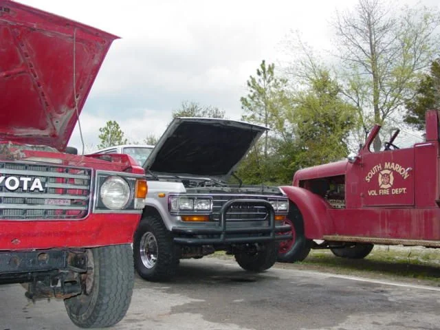

I took your advice and began removing the core support.
Once again, FLORENCE is sleeping on the job.

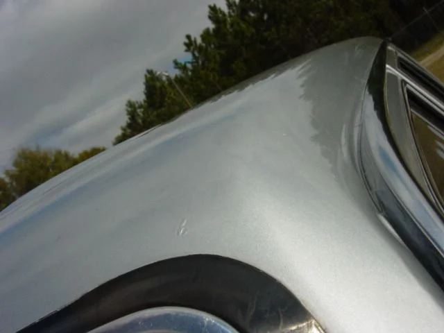

more pics
No tornados to report........although
it has been rainig cats and dogs.
I am still working outside...... weather depending.
Note my drivers headlight bucket, the po broke it.
"Thanks lowtideride for the new headlight pieces"

few more pics from today

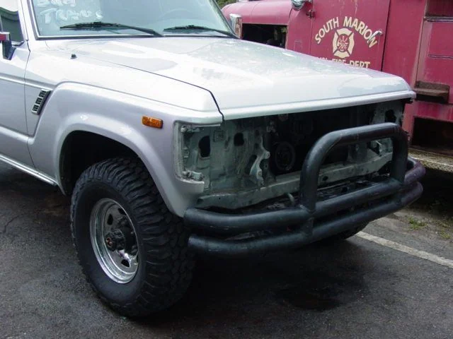

Hopefully, I'll be able to get the body panels aligned, once the mechanicals have been swapped.
