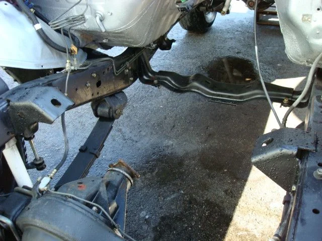

Kudos Frank!

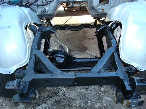

The 3b motor mounts are welded on the 62 frame. The transmision mounts will
be welded on tomorrow.
The entire frame and mounts will be painted semi gloss rustoluem black.
The axles will be painted semi gloss black when I rebuild the knuckles.
Thanks Ishobie for the 3b ac bracket.
I almost have all the parts needed to add ac and ps to the diesel conversion.

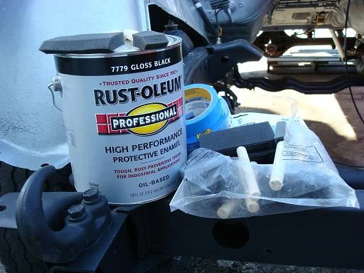

LTR- thanks for the tip...... Gloss black it is.....
I picked up a gallon at lowes for $25.
I think I have seen it at Wal Mart for $20 or so.

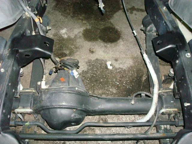

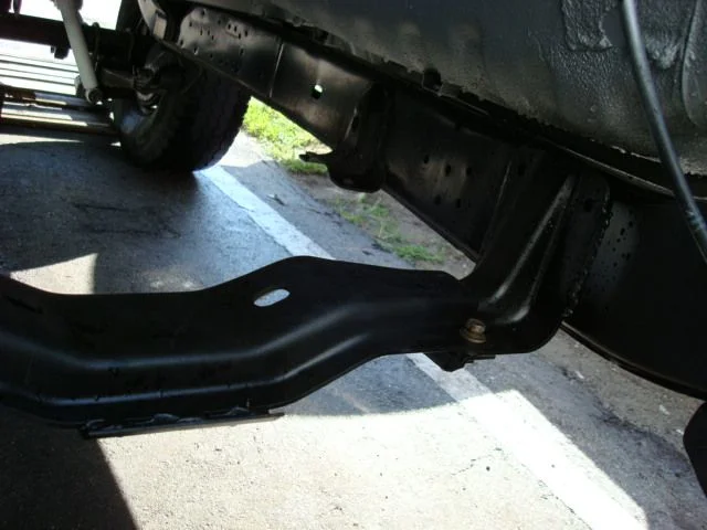

It has been a busy summer...... i.e. no time to wrench on the crusier.

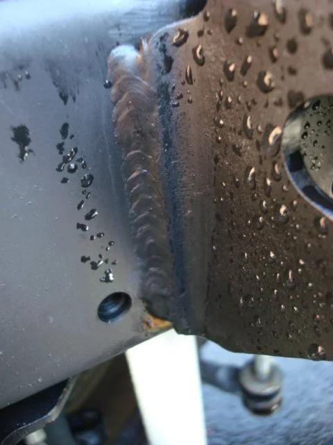

Frank has done a fine job of welding the transmission and motor mounts.
KUDO's Frank..... 1k Thanks
I left the oem 62 transmission mounts in place.
I wasn't sure if I needed them for a future h55 conversion.
It is really coming along, I can now paint the frame and begin putting everything back together.

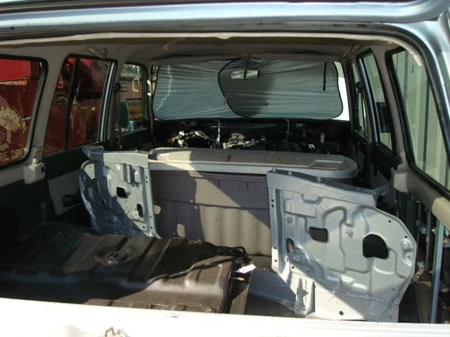

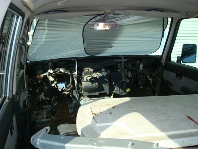

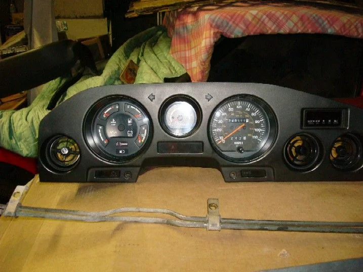

Gunnar installed the clutch bucket while I attended my Grand dads funeral.
He also hooked up the clutch master.
Thanks dude!

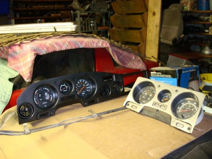

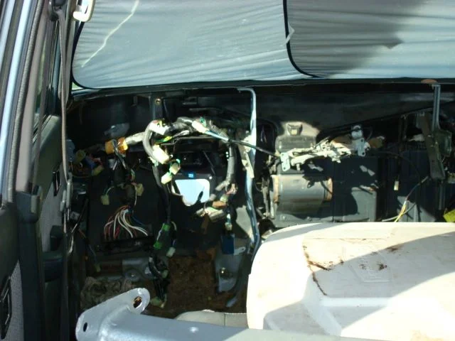

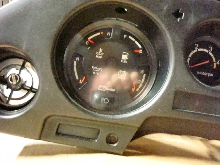

While the dash is out, the bj60 gauges are being installed in the 62 cluster.
I will be cutting of pieces off the 62 harness not used in the conversion.

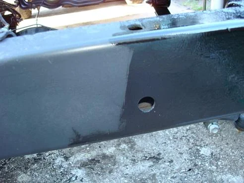

I started painting the frame today.
Because of other obligations, I didn't get as much done as I would have liked.
No need for $pensive frame coatings, oil based Rustoleum works very very well.
I hope to finish the job in the morning.

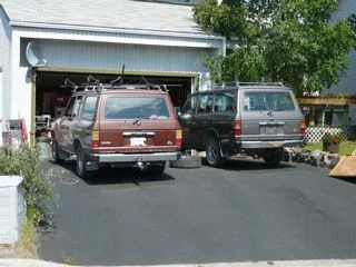

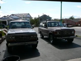

Looks like a great project. I just picked up a F62 and plan on doing the same thing you are doing with my rusty BJ60.
Are you putting the round lights on your FJ62?
How much for the turbo for the 3B?
Here are the cruisers:

warrior737- Sweet rigs!
I am keeping the square lights.

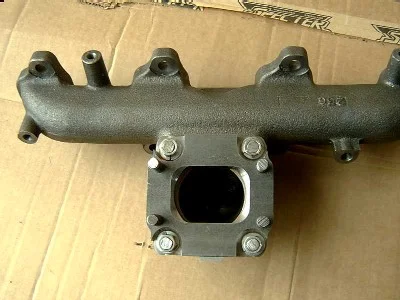

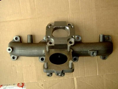

http://forum.ih8mud.com/diesel-tech-24-volts-systems/131284-3b-diy-turbo-question.html
My bud Richard pulled the turbo from his 85 300d Mercedes.
I paid him $100 for the huffer.
An adapter or turbonetics conversion turbine housing is also required to put the Garrett on the 13bt manifold.
http://forum.ih8mud.com/showthread.p...=13b-t+garrett see post #6
Thanks BrownBear for the info/photos.
The turbonetics housing requires a custom wastegate, so I probably won't go this route.
I am not sure of the cost the conversion housing vs the adapter.
http://www.turboneticsinc.com/pa_turbhous.htm
from the bottom of the page
Toyota CT-26 Turbine Housings - Accepts Turbonetics T3/T4 CHRA
A/R TRIM STYLE PART NO.
Stock Stock Supra 7MGT 20535-1

Quote:
Originally Posted by Tapage View Post
awesome manifold dude .. ! that s***t is beauty !
That's my pictures
Manifold came from G and S, not Sor. Just happened to set it on a SOR box...
The adapter is the cheapest option. 70 bucks or so, then you can run any T3 garrett. The housing would be nicer than an adapter, but $$

Quote:
Originally Posted by lowtideride View Post
Saweeeet. There is these fine foam rollers that I found at Ace that are yellow and about 2.5 inches wide. You can get the paint on thick enough that the roll marks go away and it looks like its been powder coated.
Awesome job man. Hopefully we can park our Fj62s together someday...
Add a little mineral spirits and it does the same. Roll it on and it self levels.
But don't use too much or it will not be thick enough...

Quote:
Originally Posted by brownbear View Post
That's my pictures
if it had the opportunity to get one for the 12H-T other history.

The bj gauges were used in the 62 dash.
The 62's gauge face was retained with the bj gauges behind it.
All the sending units from the bj will be swapped.
The bj 4k tach was swapped over.
The 62 speedometer was retained.
Bottom picture shows the left over parts. (note km speedo and 62 tach)
The yellow circled warning lights will be installed into the 62.
