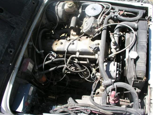

Turbo 2F with propane injection
I know of this guy by my house that has a FJ40 with a SOA and 39" pitbull rockers. He currently has a header with a weber 32/36 but he wants more power and is seriously considering making the 2F turbo with propane injection.
Has any one seen a turbo 2f before? How does propane injection work?
I can't wait to see how it turns out

check out what I found in google http://www.me.umn.edu/~vandeven/turbo2f.htm
no horse power or torque numbers tho

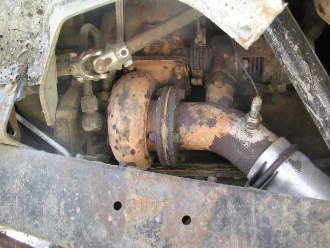

5 years or so.. not a single issue with the turbo..
ignition issues yes.. carb issues yep.. Nothing that a bit of tinkering has not solved yet tho..
All in all it is a very consistent system..

how much boost have you set . ?

up to 12 lbs..

whats your setup? have you tested on the dyno? Should I do this to my daily driver FJ60, I would love to hear the blowoff

no blowoff valve.. it is a draw through system so it does not need it.
impco 425 fed T04 through stock manifolds.
Easy actually.

Mace,
I that a roll-cage under your hood? Never seen one.

it supports the front coilovers..
Be a bummer if the shocks flexed into the motor

Where did you get the turbo?
D'Animal is offline   Reply With Quote
Old 04-25-07, 07:11 PM   #24 (permalink)
what he said
Mace's Avatar
Join Date: Feb 2002
Location: Las Vegas
TLCA# Something
Posts: 13,100
The turbo is just a Garret T04. Nothin special.

thats great Mace!
pyro gauge? would be real interesting to find out the EGT's on that setup.
edit... i see the post pyro sensor ...
do you have a muffler or just let the turbo take up the exaust noise?

That is not a Pyro. It is an O2 sensor. No clue on the EGT's but the motor runs VERY cool..
No muffler on this rig. just a 3" straight pipe.

so if it's a carbureted blow-through system, what's with the o2 sensor?

It is a carbed draw through system. And I have a digital controller for the propane system (closed loop propane )
Plus I am running a Rich/lean gauge for tuning..
