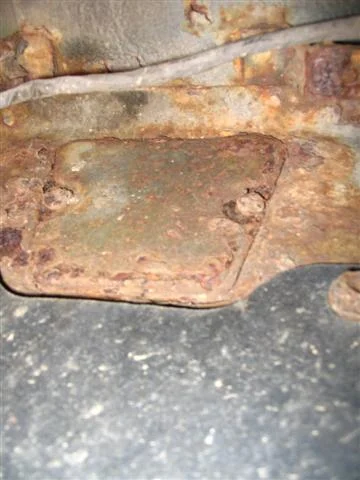

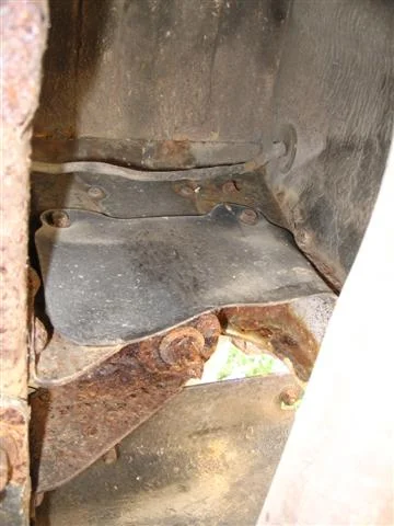

Got some time in today and I found the access panel for the furthest rear cab mounting bolts. If you get under the truck and look from the front at the bolt and then look above it you may (or may not see depending on how much rust/dirt there is packed up under there) see two philips head srews holding a cover plate on. I have not gotten mine off yet because I wanted to soak it in PB blaster before I strip the heads off. I may just drill the heads and then replace with socket head cap srews, we'll see how it goes. Anywhoo heres what it looks like. Can you say RUSTY!

Wow that helps a lot Bahndo I couldnt figure out where those were. I got mine the majority of the way off, then as i lifted the body i just unscrewed them. Also instead of unbolting all the rusty bolts I just cut them off with an oxy/mapp torch. I think that saved me a lot of time.

Wow! I thought mine was bad .
Thanks for picture!
