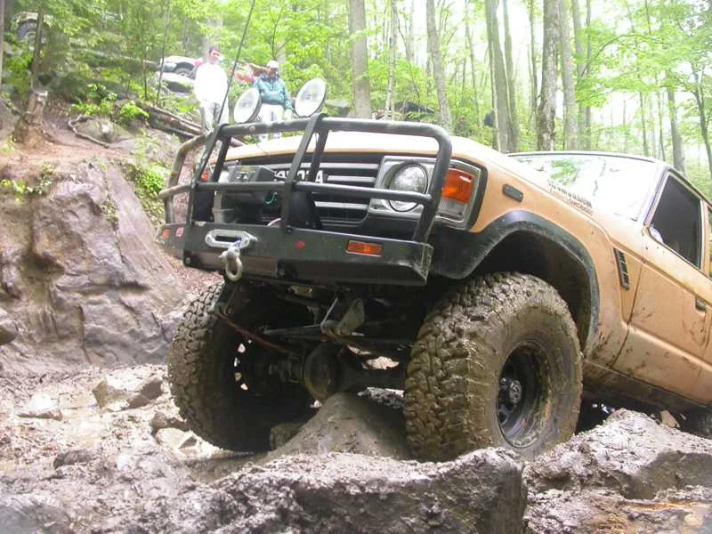

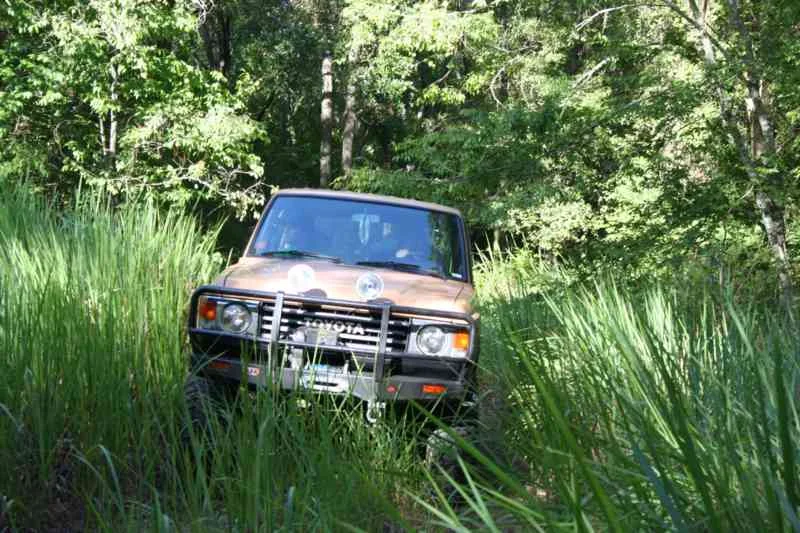

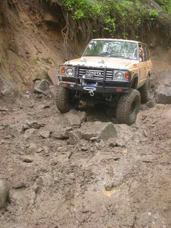

Here is a few....its a tight fit. I even had to clock the winch forward a bit but it cleared everything with 1/8inch to spare on all sides. The only problem is relocating your lights if you have any, and the CB tab I moved to the outside of the bar.
let me know if you have a questions...
-Al
