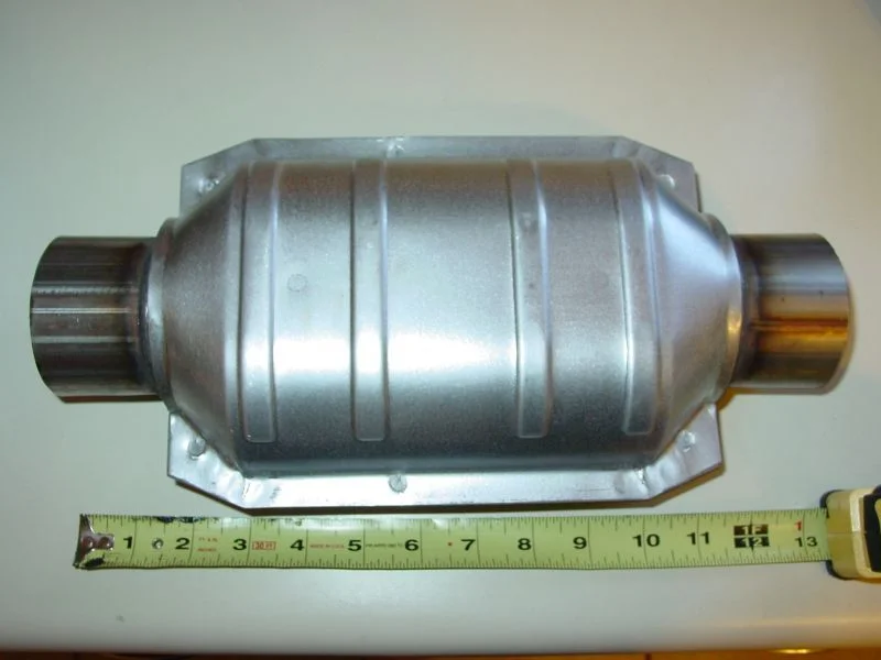

Single 2.5 inlet/outlet Magnaflow Catalytic converter from Summit Racing
MPE-94106CA UNIVERSAL CATALYTIC CONVERTER $65.95, in stock location under heat shield

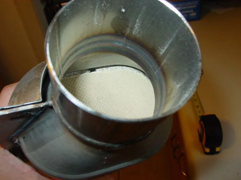

Here's the cat I mentioned in the earlier post.

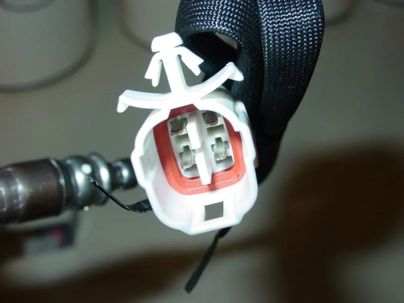

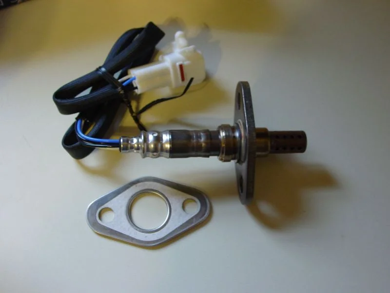

Denso O2 sensor detail (see earlier post above)
