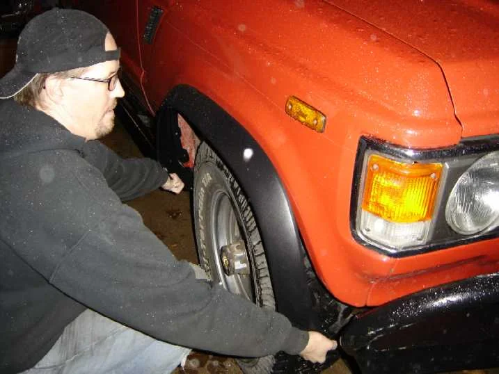

well with a little cutting an fanagling...... i do believe these flares will work,NO PROBLEM!
i'll post a couple pics in the morning .
the flares i picked up were off a 93-95 pathfinder, but i believe any p/f from 87-93 is what your going to want to look for.
the 93 and newer flares have a notch cut for mud flaps.

if you go looking for these in a bone yard your gonna want to look for 4dr pathfinder flares.
like i said, with alittle trimming of the flare. i think these are the deal.
they seemed to fit real well.
enjoy!

Damn, those look about perfect! Now how is it that a 60 looks so much better than a pathfinder.....?

some slight rotation of the flare and BAM!!!!! a real nice fit,cut the ends after mounting.......

Holy old thread! I put some Pathfinder junkyard flares on this year. They worked out ok, not superb, but it keeps some of the mud off the rig and off me, and the Highway Patrol don't bother me. I'm happy with them. I did have to screw them on from the outside, so there is no turning back now. Rust got most of my fender lip so I was left with few options.
Post some pix! Thanks

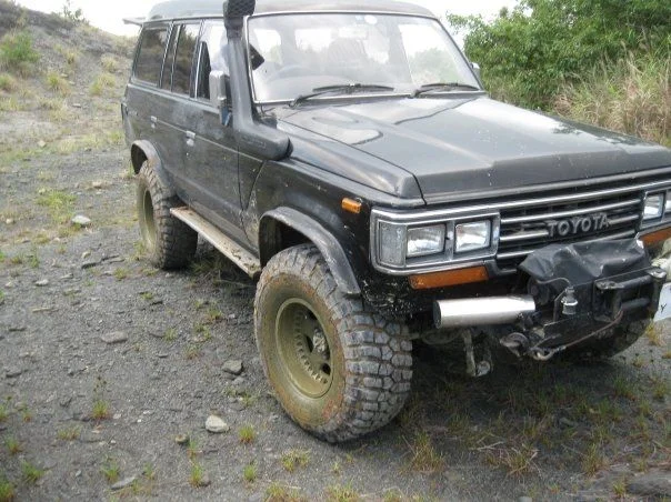

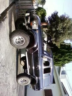

i used sme flexible rubber universal fit type from jc whitney or somewhere like like, maybe jegs or summit. work well, easily custom fit, and dont get broken or ripped off because of rubbing (they are flexible)Name:  before SOA.jpg

Cool I'm going to go that route. Thjey should get "the man" off my back
