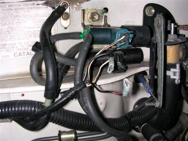

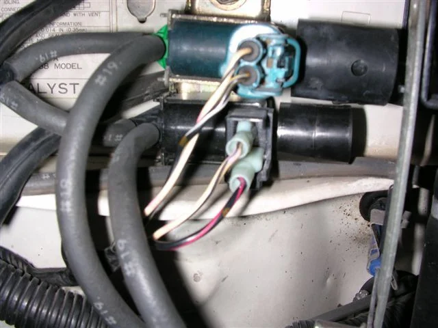

Pics
Here ya go. I don't understand why some have a problem with "messing with the wiring harness" when all you have to do is crimp on two new spade lugs. For around $20, to have a Toyota part doing what it is designed to do is worth it. Mac valves? Who needs them is my thinking.

The reason i went with the MAC valves is that its barely any more expensive (cost me $35 for 2 valves, fittings, and mufflers) and i was hoping to find an alternative that would last longer than the yota valves. If the toyota valves were all that great there wouldnt be umpteen threads about replacing them on this board.

Killer. Thanks a bunch. Looks pretty straightforward. I think my local dealer told me 430 for the new solenoids. I should have them tomorrow, and I will put them in Sat. AM and let you know how it turns out.

I am actually going to do this tonight after work. I will post up pics of the final product. Boy, 430 for new parts, or 20 bucks for the other Toy part, which does the same thing...wow.

Done. Almost pissed me off it was so easy. 430 for the dealer assembly, 22 for the other part. Crazily rediculous. Overhanger, you are my hero.

Did you replace both valves with the same part number?

I "think" so. The lower one on the firewall is the disengage solenoid and the one that goes bad since it is almost always on. Start with that one - I'd bet the upper one is just fine and will be for as long as you have the Cruiser.
Quote:
Originally Posted by hightide
Originally Posted by overhanger
from a 90-1 Celica for the AC idle up, list price is $17.60 part # is 88690
2B340
Is it the same part number for both valves? I dont know wich one is the "bad" one so might as well replace both.

I only replaced the bottom one. I ordered 2, but they only ordered 1 for some reason. Works like a charm. I will be ordering another in the next little bit here as a backup...
