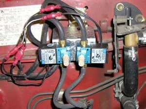

If people would like a couple pictures of the mac valves setup i can snap a couple, my setup is kinda ghetto fab but it works like a charm. Might be nice to be able to visualize how it works.
-Matt

Quote:
-Matt
I added picutres to my original post. Dont know if they are ghetto like yours.

Quote:
kkt
No, yours is very pretty, mine are ziptied to the stock bracket that is rotated 180 degrees towards the passenger side so it hangs down low enough to clear the hood, and the autoparts store i went to only had 1/4 inch NPT nipples so ive got a little peice of 1/4 in hose then a plastic 1/4 inch to 1/8 adapter then the stock vacuum line. Very, Very, VERY ghetto. Works perfect though .
-Matt

finally broke down and used the MAC valves previously posted. Got tired of waiting on the Celica solenoid valve to materialize from parts purgatory. Learned a few lessons.
1) Don't buy your vacuum hoses from Advance Auto Supply. Get 'em from Toyota/SOR/Man-A-Fre. They fit better and it doesn't take much of a leak to kill the whole system.
2) Toyota didn't want anybody to jimmy-rig their solenoids. They managed to put enough things in the way so that the bracket has to stick out about 3" from the firewall for everything to fit.
total price: $55 for valves, fittings, 2 sets of vacuum hoses, metal for bracket, wiring connectors.
But it works!!!
Pics included.
