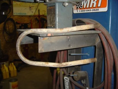

I used a local spring shop in town and have had no issues with mine, however I did have to bend one of mine to compensate for the rotated axel housing (cut & turn) on the front axel closest to the diff.
Not unlike this photo.
