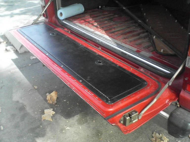

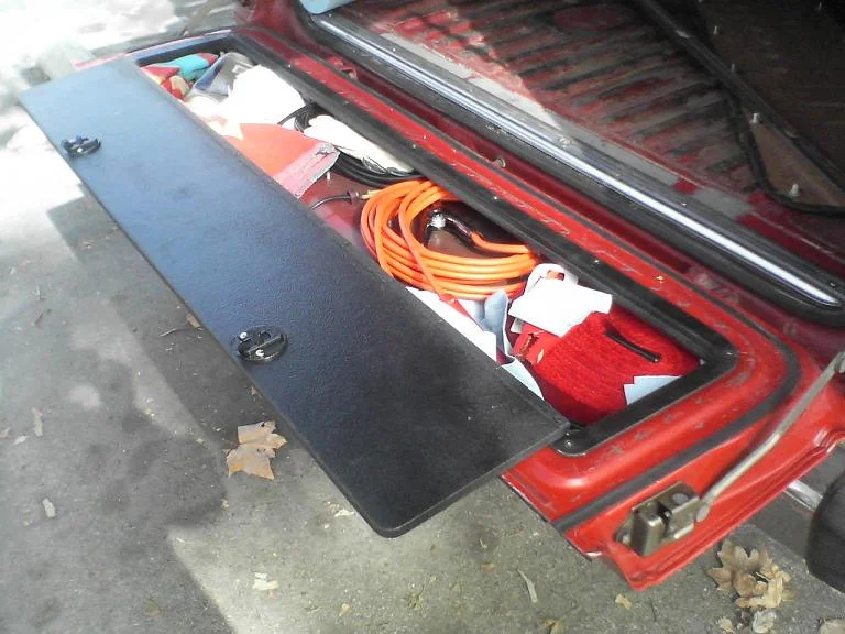

TOOK ABOUT JUST UNDER 2.5 HOURS...+ SOME CLEANING... NO SOUND DYNOMAT THOUGH..... I do luv it. Great storrage and now I can corner like a porshe... Well sort of Last night I tried to corner like I robbed a bank and coul feel the tires trying to come off the wheels.... Also jerked abit instead of drifting....
LOL oh and now that my tailgate weighs more... the rear swings more.... can you say boat effect?

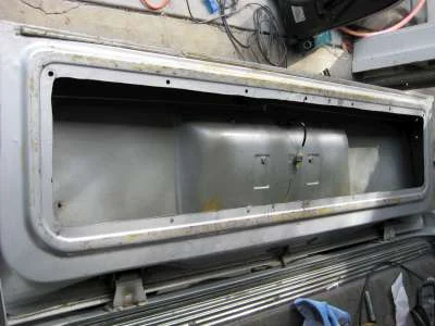

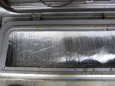

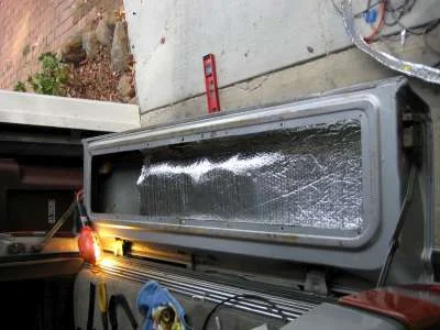

Got mine mostly in and tried to get shots of the process. Next is to find some deadening material and I'm gtg for the winter.
screwdrivers are pointing at a couple hidden spotwelds here.. was hard to guess at what was underneath so I took it slow

My tailgate lid arrived today!! Very stoked! It is more substantial than I thought it would be. Has a bit of weight to it. Feels very solid.
Thanks Kevin, Great job!!

Some pics of the install process for the tailgate. Thanks Kevin! (Note my new signature line).
In my excitement to get cutting, I had to be sure to remind myself to not cut any of the latch or punch through to the metal on the other side. I used a jig saw to cut, and up on some wood blocks to raise the blade (per KMR's instructions - yes, I actually read them). Then used a grinder to clean it up a bit.
I took some small vacuum hose, cut it lengthwise, and put it around the wimpy wire for the license plate light. Taped it down w/ some foil tape.
The silver lining stuff is basically bubble wrap w/ foil on either side. I bought it at Home Depot in the insulation section, it's inexpensive (maybe $20 - $25?). You can't see it, but I folded it down at the bottom, so it covers both the inner and outer portion of the tailgate to form a little pocket.
Will add more of the installed product if anyone is interested.
