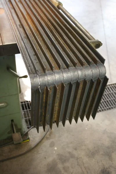

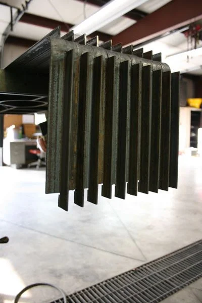

Big day today, made some progress!

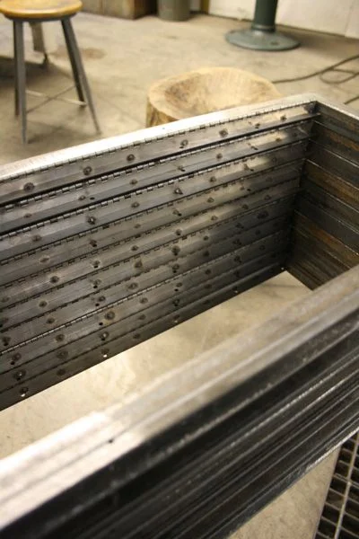

I was feeling quite proud of myself until I saw this photo and realized that it does not really look that impressive.

CaliCruiser is offline   Reply With Quote
Old 10-07-07, 07:14 AM   #197 (permalink)
Supporting Vendor
kevinmrowland's Avatar
Join Date: Sep 2005
Location: Scottsville, NY
TLCA# 14896
Posts: 1,428
Thanks, lets hope I can make them look like more of something today.
I have not been able to notice any rattling and I have not been at all careful while packing it. The box itself is not likely to rattle because the coating I put on it has some dampening properties.
I do think it is imperative that sound deadening be applied to the inside of the tailgate. Not only to clean it up, but to make sure the contents do not rattle against the outer body skin. There is really no reason not to, access is so east once the inner panel has been cut out.
With sound deadening on the body panel and rubber coating on the lid, your stuff is basically in a padded envelope.

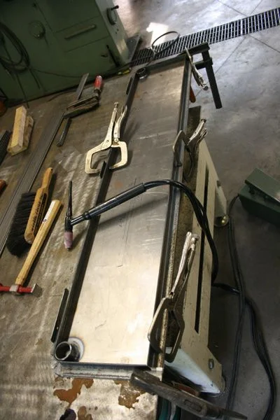

Well, got a bit further today. My plan was to get the labor intensive stuff done and finish them off in the evenings during the week. I did just that, but 10 is too many for one weekend!
Went well but I will not do it like that again.

My paint supplier at work hooked me up with an undercoat/chip guard spray setup today and I did some experiments this evening. The spray pattern super consistent, sprays a perfect texture every time.
It was a lot easier than the aresol rubberized cans I have been using, but my first impression is that the coating from the cans is more durable.
The new spray setup is really pretty, but my inclination is to go with durable over pretty, but I will see how the samples hold up under some tests tomorrow.

Well, while the undercoat setup from my paint dealer sure was pretty, it was just not as strong as the Castle coating.
I have been severely abusing the Castle stuff and it has been holding up very well, so even though the spray pattern can be a bit inconsistent, I am going to stick with what held up to my tests.
That can of Castle undercoat I posted on page 4 is the most durable thing I have found that is available to regular shops. Anybody looking for a good aresol can rubberized undercoating should give that a shot, blows all the big names out of the water.
