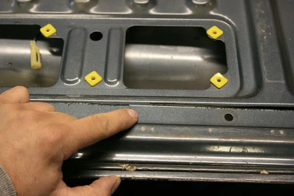

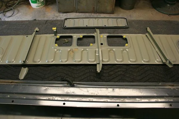

I dug out my spare tailgate today to make an example out of it. Poor tailgate
So you can see that once the carpet is pulled off there is a very easy cut line to follow.

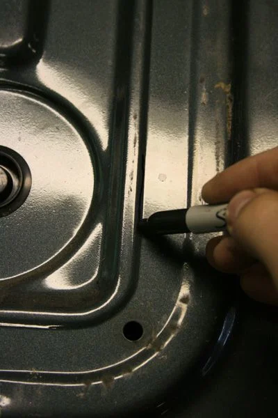

Drill a starter hole.

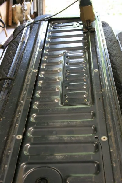

You can see where the 3 ribs are spot welded in, with a normal length jigsaw blade you can cut right through them if you go slow.

Cut along the line making sure to remove the entire raised portion.

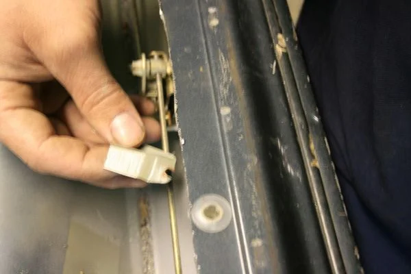

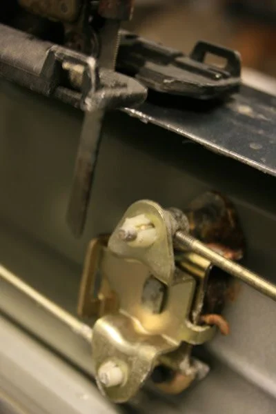

There is one section that you can not cut with the jig saw, if you do you will cut into the latch. I just use a cutoff wheel for that little bit, or you could block up the jig saw a bit, or use a shorter blade.
If you remove the inspection cover you can see the problem area.
I've attached a pic that shows the interference as well.

Once the center is pulled out, remove the ends of the ribs by tweaking them back and forth until the spot weld breaks.
And then you have a big hole in your tailgate with a pile of scrap metal next to it.
