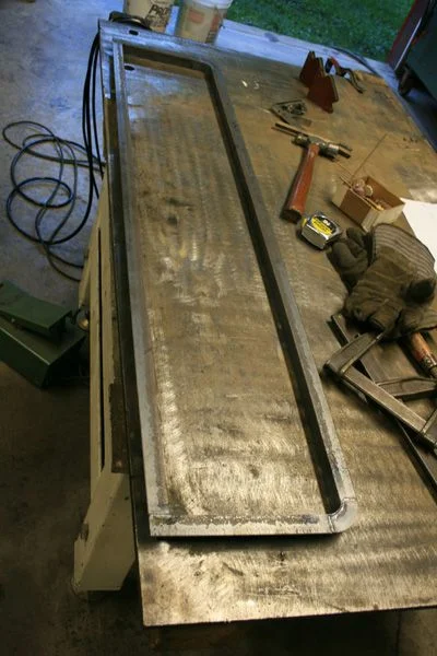

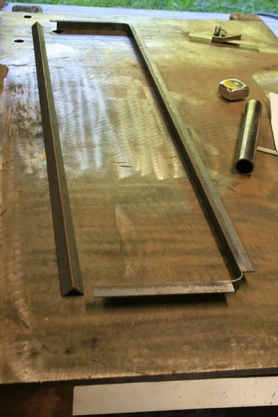

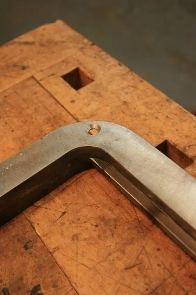

Got more steel and made a bit of progress last night. The laser parts should be here today so it can get welded together.
1985HZJ60 ROTW Questions? Check out my Vendor Forum.

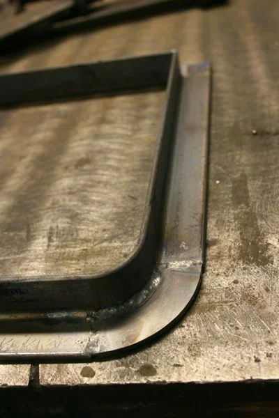

And a little bit more.
Laser parts came in today and I welded the frame together.

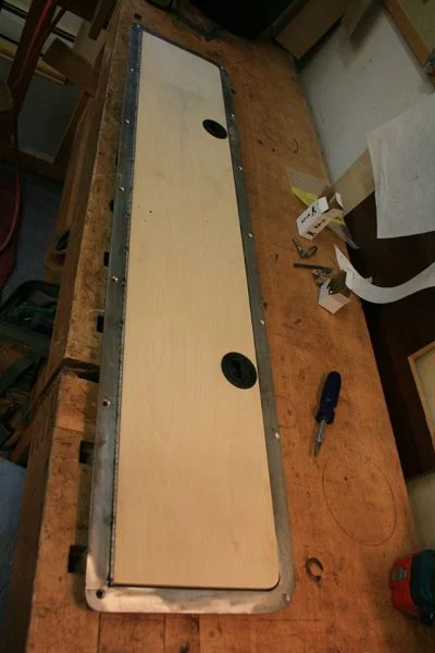

Originally Posted by haryv View Post
What a super nice project. If its produced what wood could you make it out of?
I was thinking something nice like teak, maple or some other fine wood. I Might ask my wife for this as a christmas present if its ever produced.

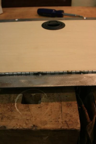

Strength-Weight-Cost.
To use hardwood the panels would need to be considerably thicker in order to retain their stability, and even then they would move seasonally. The lightest, strongest, most bang for your buck option is plywood. Ply is obviously available in many grades, even teak if you so desire, but even just the standard cabinet grade birch ply is already quite expensive.
Through the course of testing them, I have come to the conclusion that natural plywood is not advisable on the tailgate because of the abuse it needs to stand up to. While I like the natural side panels, I am not yet sold on their durability. They have a marine spar varnish on them, but they still show the dirt more than the nice durable undercoat on the tailgate.

The aluminum is more than twice as expensive and less than half as strong. Not only that, but it takes much longer to fabricate as well. To get the same strength out of aluminum I would be close to the weight of the steel and not nearly as low profile. The plywood is dimensionally stable, much stronger than an affordable plastic composite of the same thickness and is fully sealed with an appropriate coating.
The box itself is quite easy to remove which can facilitate re-coating it if necessary. The inside face of the tailgate gets considerably less exposure to road salts and moisture than other parts. So even though I hate rust as well, I have to pick the battles my wallet can tolerate.
Now a stainless steel frame, THAT would be nice..........

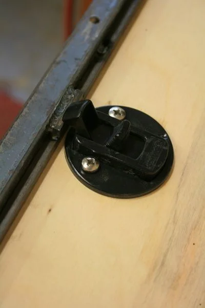

that is a wicked cool storage box! beautiful work too! also curious about price. where did you get the flush mount handles at?
mcmaster.com page 2905, look under recessed ring pull to open latch

One new tailgate box almost ready for paint.
this one is nicer than mine..........maybe I should just keep it.

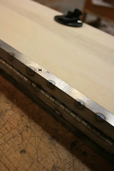

Couple detail shots to show the back of the latch and a finished corner bend. Hope that answers some of the construction questions.
