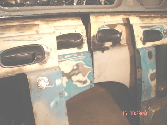

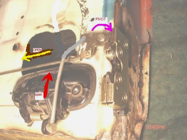

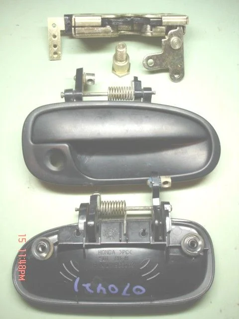

Do you want to reuse the stock handles? If so, you can do it just like on Buck's LV or you can find some other type of handle like I did. I used some flush handles from a 90's Honda Civic & Bearclaw latches. You'll have to add the keyed lock mech for the driver door. I didn't use that or the push pull lock option cuz mine are tube type doors. I was able to reuse/ modify all the stock levers & hdwe:
