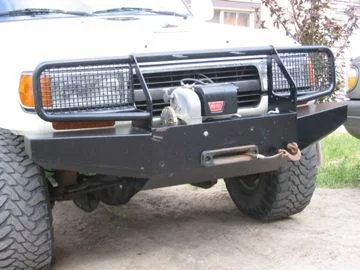

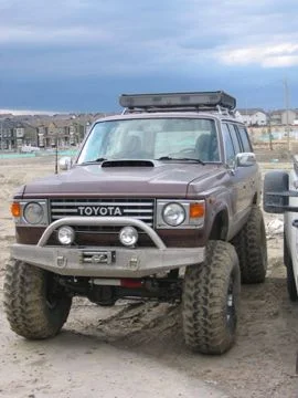

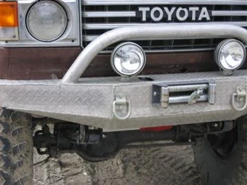

i mounted a steel box off the frame rails to bolt my winch to and the used it as a skeleton to bolt a 1/4" checkerplate alloy bumper on top of. this avoids rust and keeps it lighter, some pics of the 60 and the 80 with 8274.
