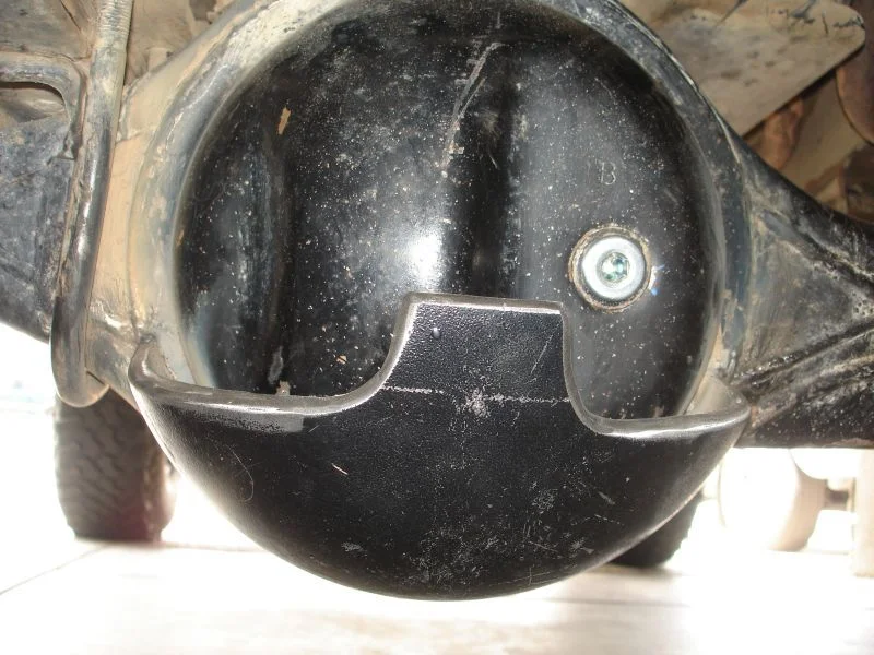

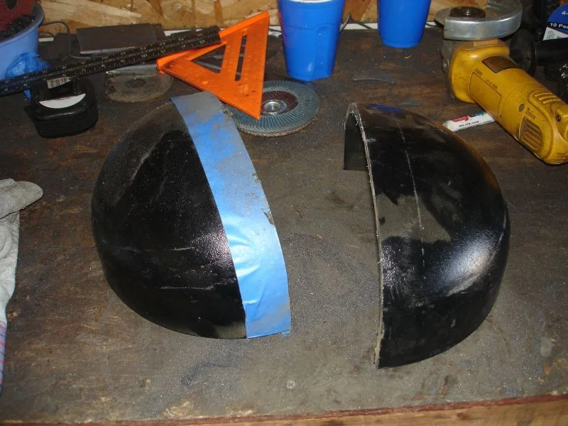

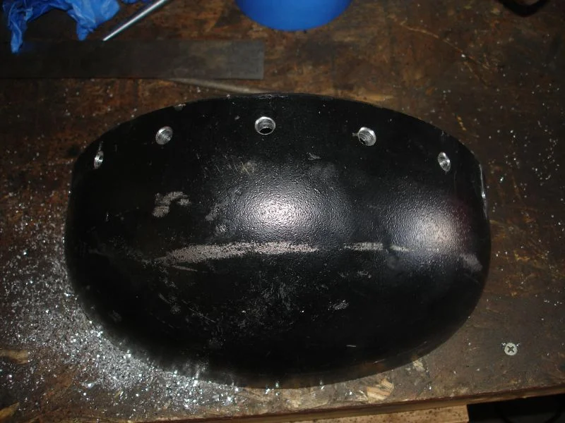

I picked up a 10in pipe cap to use as a diff guard...came out pretty well.
It was a little deeper than I liked, so I chopped some of the back half off, and added to flare with the plasma.
In hind site, I kind of wish that I hadnt added the swoops...Not that its really gonna matter either way, but the additional protection would have been a bit better IMO.
K
