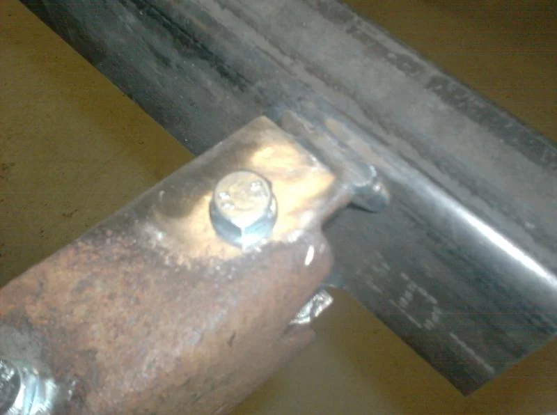

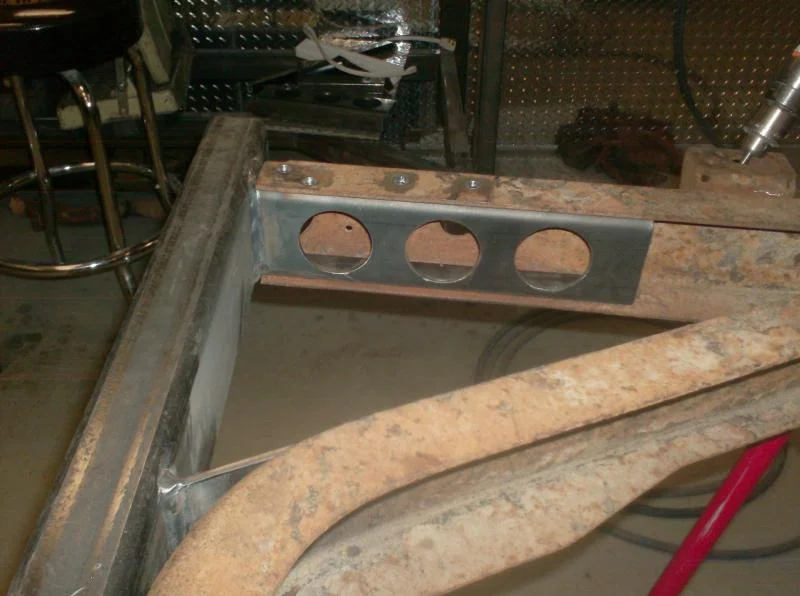

I decided to weld shut the two factory rivet holes at the end of the rails and drill a single hole for a bolt in that area

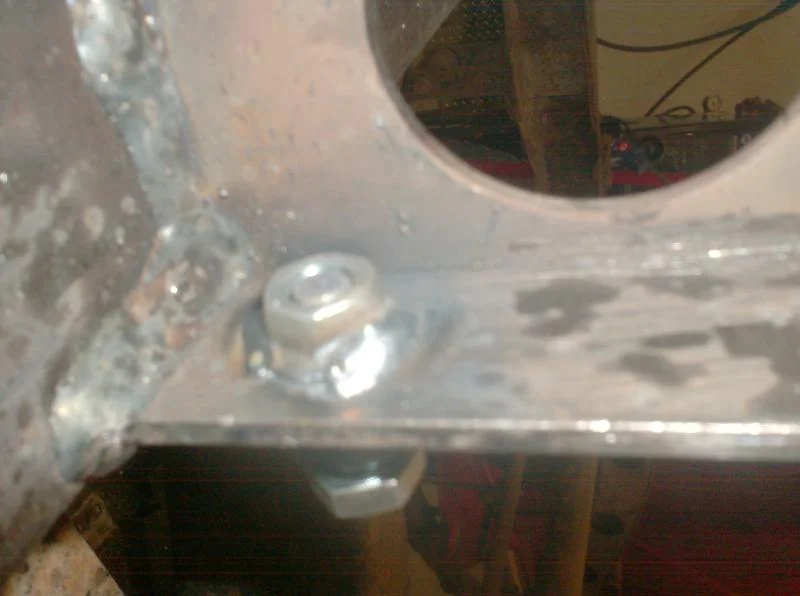

And in places where the nut would be difficult to access, I welded them in place.
