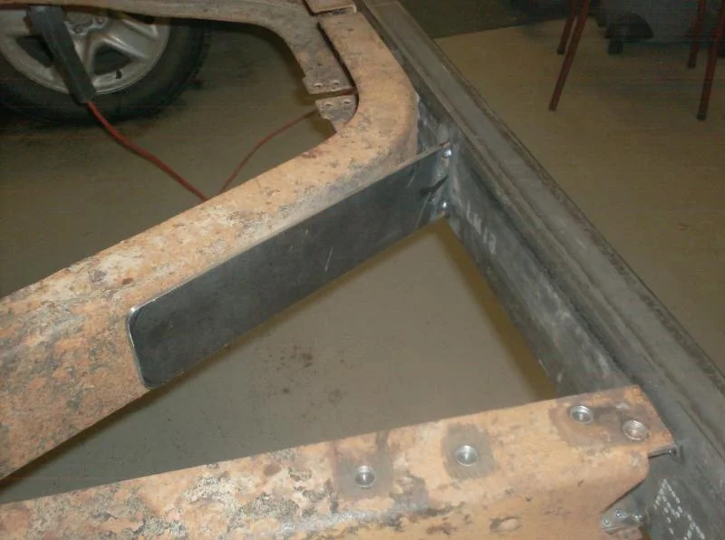

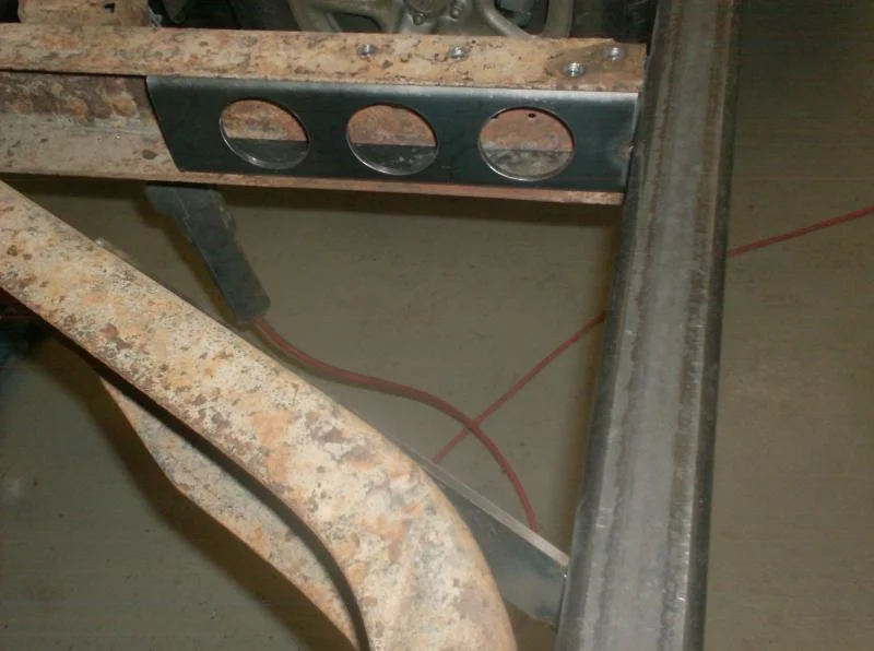

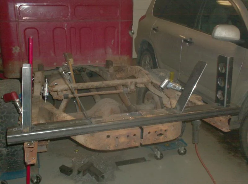

I tack welded everything in place - I'll take it to work and have one of the welders finish it off with better equipment and skill. Then I'll match drill the bolt holes in the frame doubler and flat bar using existing holes in the frame where possible.
