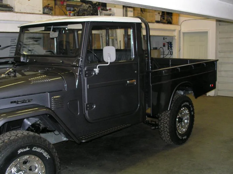

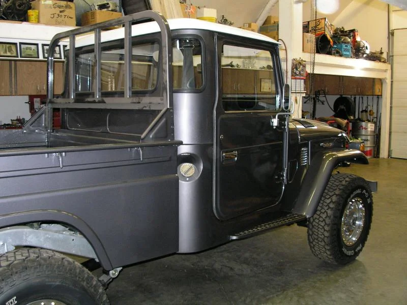

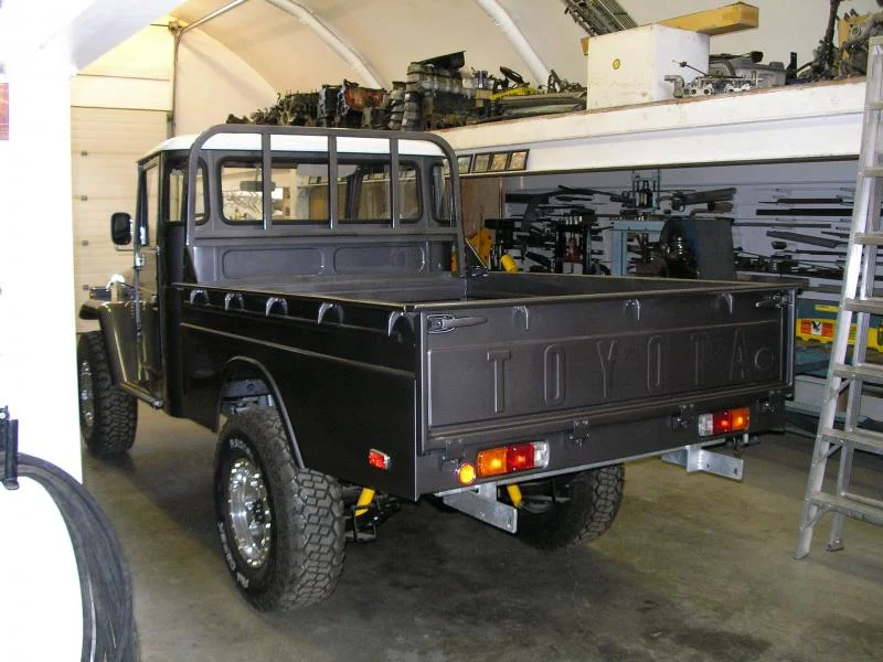

This is one of the sets I did for a friend of mine - finished and painted. He paints them himself. Note the wheel arch - they are the 1/2" lasered piece bolted from behind, ground down to mimic the factory bevel and feathered in with filler. I think parts of the tailgate were mine as well.
