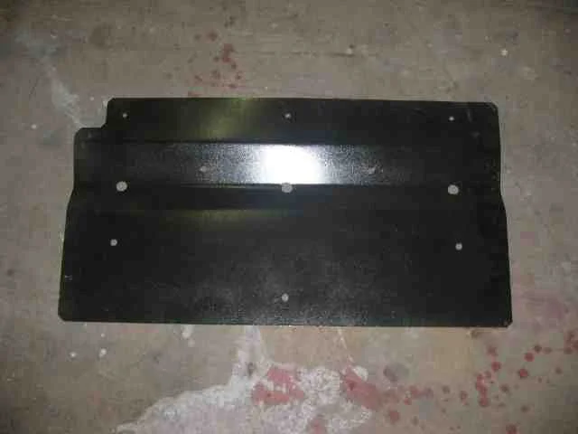

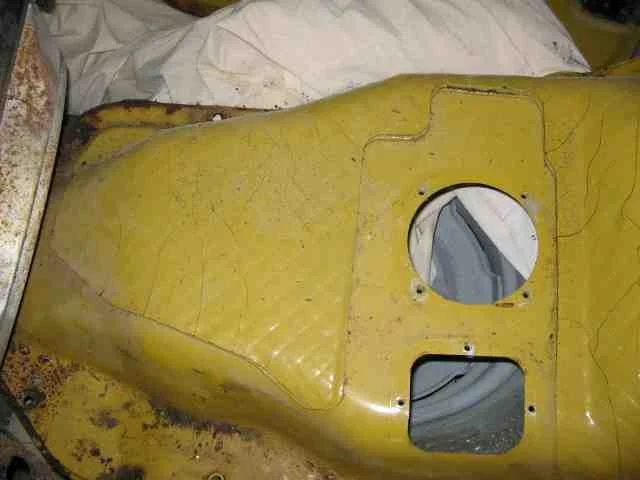

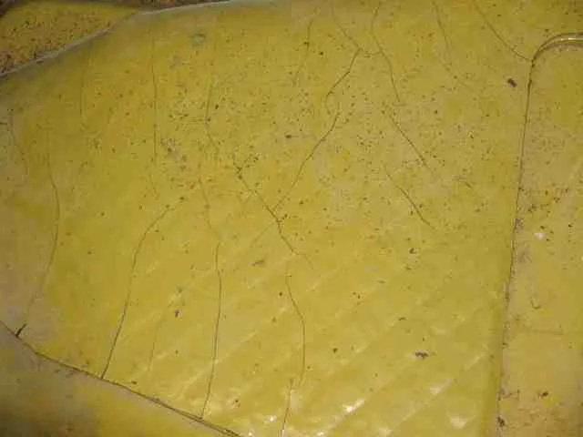

sound deadening
I was wondering(since I now have the digital camera) how one removes the sound deadening stuff, which incidentally is in pretty damn good shape.

I did it with big flat screwdriver and a hammer. I didn't have other Idea, it worked, no mayor destruction!

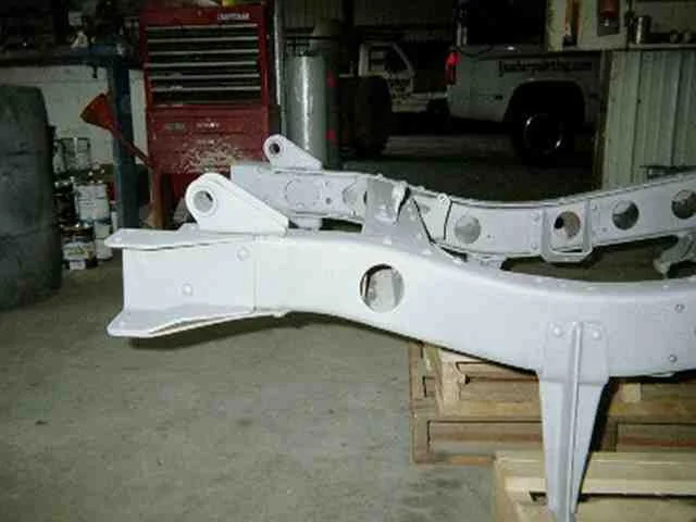

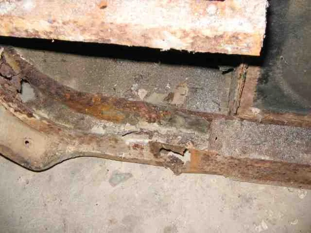

rear channel assembly
I have been swamped with work and was wondering if this could or could not be repaired.

Quote:
It looks like standard rust...cut it out and weld in fresh. I belive a few places sell a weld in replacement but I could be wrong. I will be doing that this winter since I decided to keep the body mostly stock. looks like you're moving along now though

that would be your c-channel
Yes people do make replacements, check Real Steel Cruiser Parts (on ebay) , CCOT, others...

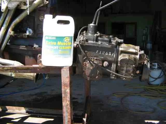

Sunday i finally got in some cleaning work on the 40. We pulled the engine on Fri, and Sun, my father in law and myself cleaned the motor with one of my powerwashers with extra muscle.
A very good and efficient cleaner.

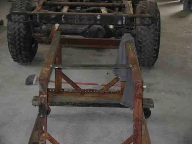

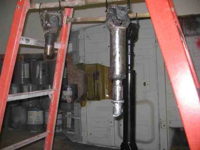

progress

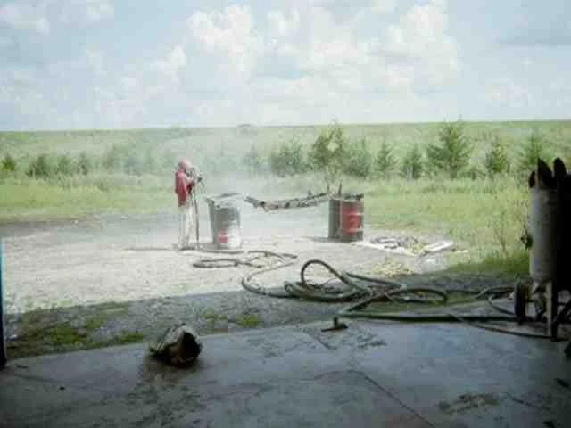

I have not vanished. Just busy.
I found some pics of some during and pre-blasting of my frame etc.
These are pre digital pics.
At the moment I have a rolling chassis, all backwards, but that is another story. Re-doing happens on Sat.
im back!

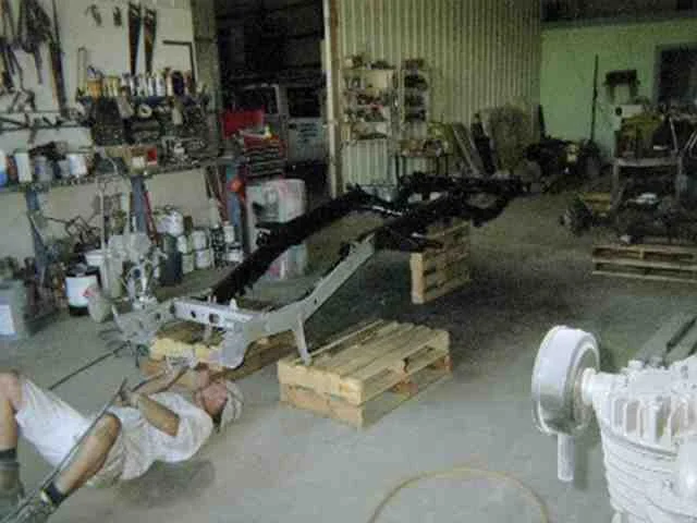

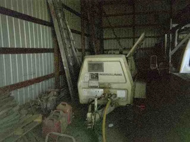

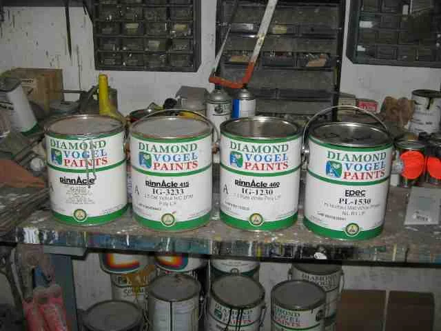

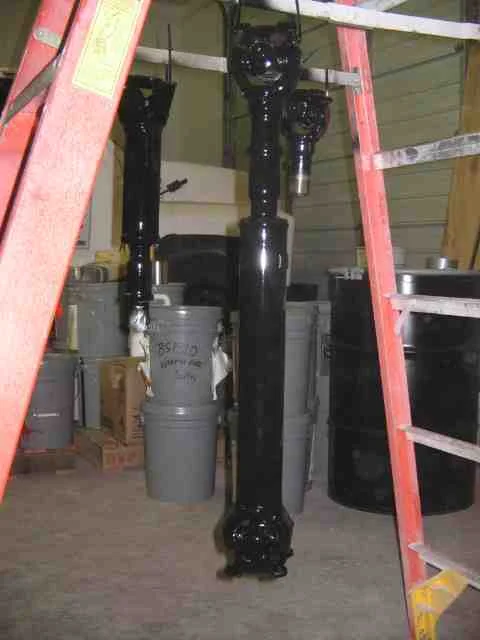

Here is the ammo, and paint process.
I chose a 2 component urethane primer and finish. We have done salt trucks with this paint system, and in my opinion, bulletproof.
Then again , I am equipped to do this phase of the project. I can see where rust-bullet, por 15 etc. would be the choice.

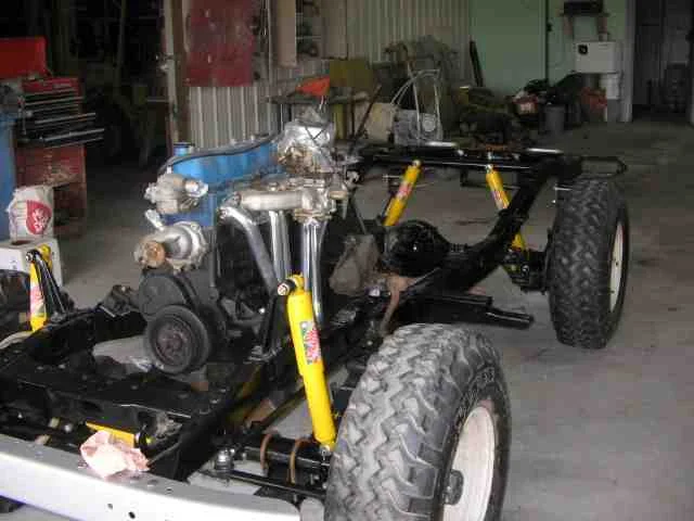

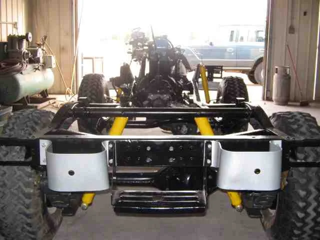

rolling chassis
Have some shots of the rolling chassis. And I answered a thread or became a questioner as well about the rear motor mounts. Just wanted to share . bolt size difference etc.

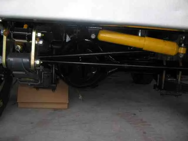

side view
2 more shots of the chassis before I go have lunch with the Mrs.....

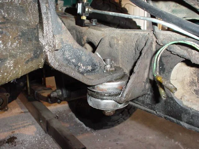

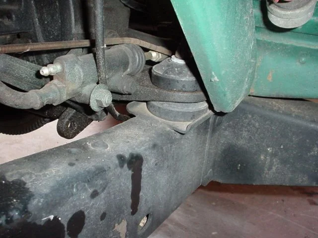

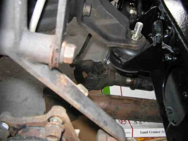

wondering if anyone has THAT much room with their castle nuts and rear motor mount. I did read the way to shorten up the distance is with washers.
I can't find anymor old pics I took prior to plucking the engine.....
Hammer and chisle and putty knife. Remove when it is cold and brittle. Comes right off.
I actually did that awhile back. I did not post any pics for quite some time.
But you are right I waited for cold.....

propane torch/heat gun
Quote:
Just warm the metal from the back side a little bit, careful with the open flame technique, might be good to get the parts into a warm area overnight so it is flexible. I did mine during the summer. It will peel off with little effort. the chisel technique leaves chunks and scratches up the metal. Clean up with some solvent or paint thinner.
Isn't there suppose to be a second rubber mount and washer under the castle nut on top of the steel mount?
http://www.sor.com/sor/cat040.tam?xa...x=cat040%2Etam
Kevin

Posts: 6,599
Well...this is what my schtuff looks like...pass side, then driver's side
Ed

Quote:
Ed
My driver side looks like that, passenger side similar. Looks like you have a large washer? I think I have a wrong size bolt according to the rear motor mount thread. But which hole do I slip the cotter pin thru? Nice pic by the way.

back at it
Well, alot has transpired over the last, since last nov.
I split from the family biz and started my own , and it has taken off tremendously. Meanwhile myself and father in law have been tinkering with the 40. I have some shots of the drive shafts I did in a durable rattle can paint from Diamond Vogel.
I also have procurred a body man(me supplying paint of course). I wanted to ship the whole thing to Proffits. Logistics are impossible, so I am going to call Jeremiah and order the body parts I need.
here are some shots...

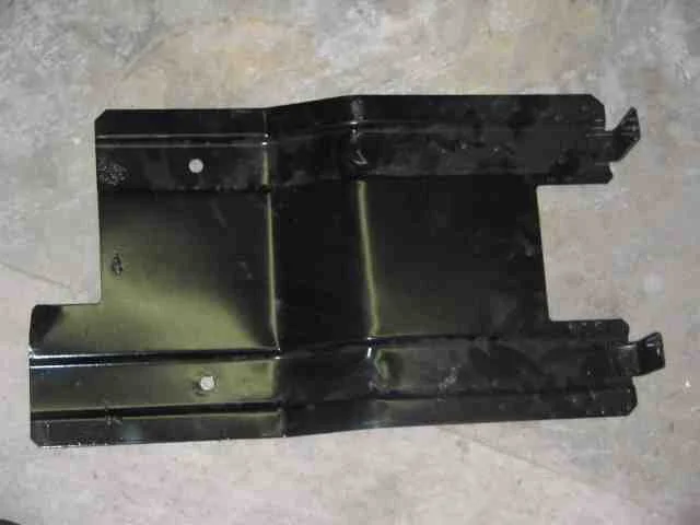

still chuggin along
I have been stagnant for awhile with the 40 . Here are a few pics, and questions. Need to know where the skid plates go(can't find em in my pics). First and 3rd pics
Also when I removed the shield below the radiator(2nd pic) the 2 bolts on the side of the frame(where shield attaches) crumbled. Was thinking about using oversized washers there , or possibly getting a new one/used one.

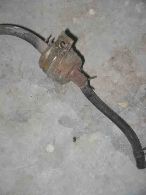

In line fuel bracket

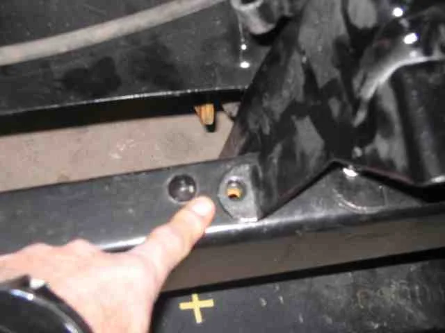

can't seem to find this bracket. Noticed yesterday on a different thread the same deal with an inline fuel bracket not there, and it just hanging there. I have pics of the bracket connected to the battery pedestal. Maybe someone can show me a pic of the bracket.
