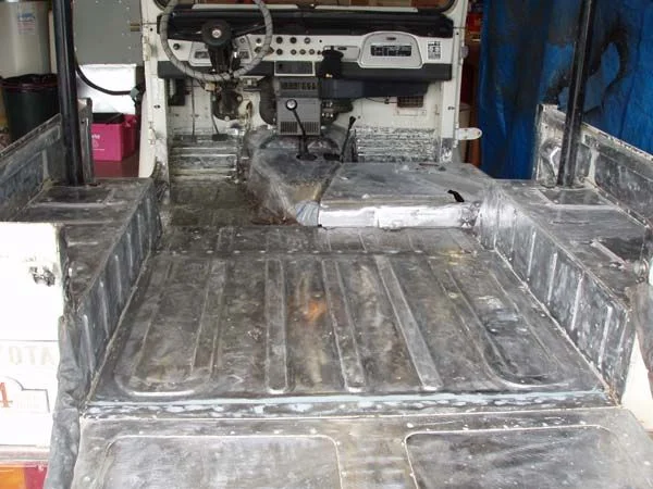

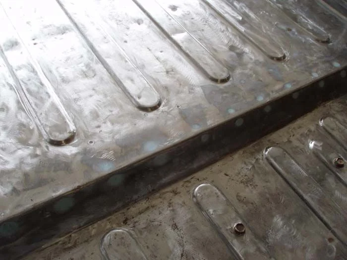

pics before I paint
I finished sanding and bondoing. I will shoot the liner without the tranny cover or fuel tank cover in place ( I will mask off the tramnny. I do want the gas tank well shot. I will then put it back together after it is shot & cured

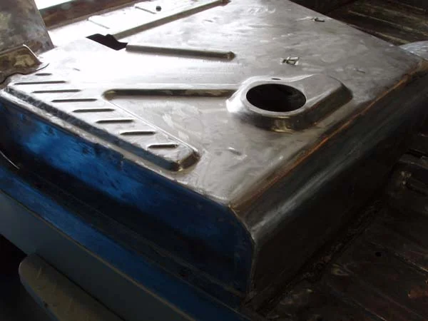

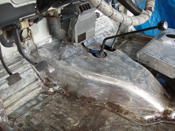

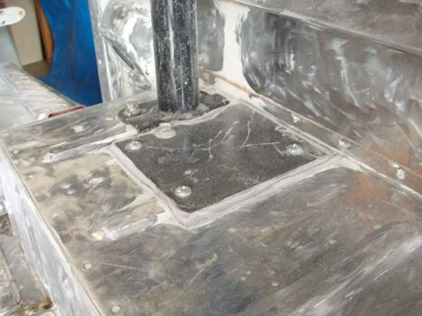

more
pics

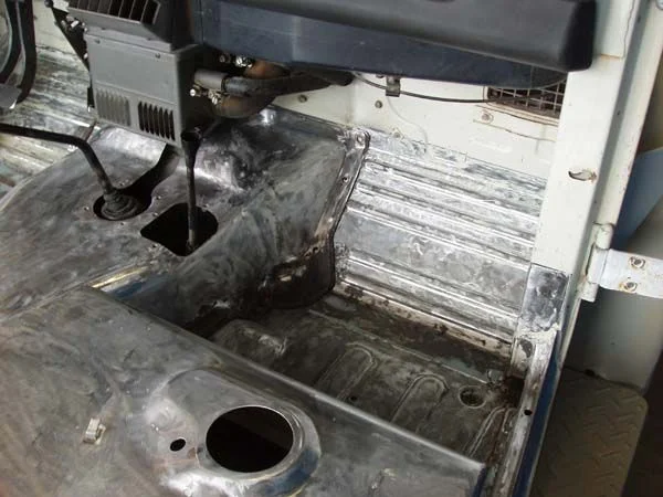

I would use something on the rust to encapsulate or kill it. It looks like you may have used bondo directly over some of the rust. If so, it wil eventually lift and blister. It may continue to look fine on the top side (bed liner) but underneath it will continue to eat away at the metal.
Again, I'd either use a chemical product to kill or enapsulate the rust or have those area sand-blasted to remove all traces of the rust before applying the bed liner.
Also, my experience with bed liners like herculiner or durabak is that its not necessary to fill small imperfections like spot welds, etc. The liner will do that for you and probably bonds to the metal better anyway.
Another caution is that most of the thicker type liners want a sanded but somewhat rough surface for a better mechanical bond. I've generally final sanded with 180-220 grit if applying the thicker liners.
If you are using dup-a-color (sp?) then you will need to have a very good and smooth prepped surface because it won't hide much if any imperfections underneath it.

nice work, BUT I would consider redoing that patch panel work on the pic near the rollbar, do you have access to a welder? if you patched a panel in there and then smoothed it with a minor thickness of bondo I think it would be a cleaner fix....

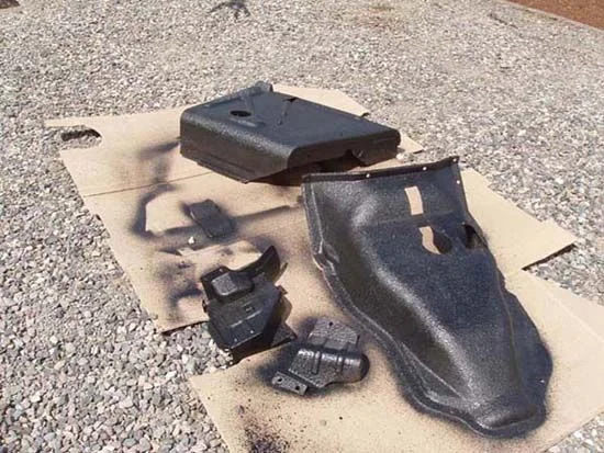

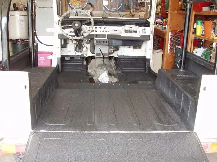

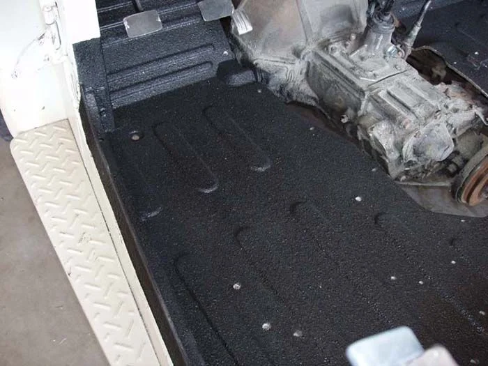

Shot the tub yesterday!
Pics

Posts: 1,259

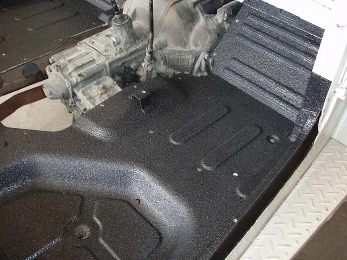

More
pics

Looks good.
What did you use for the liner?

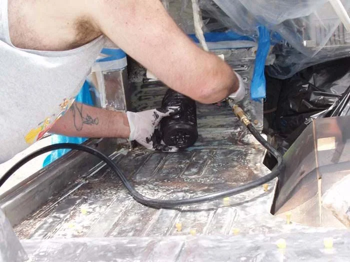

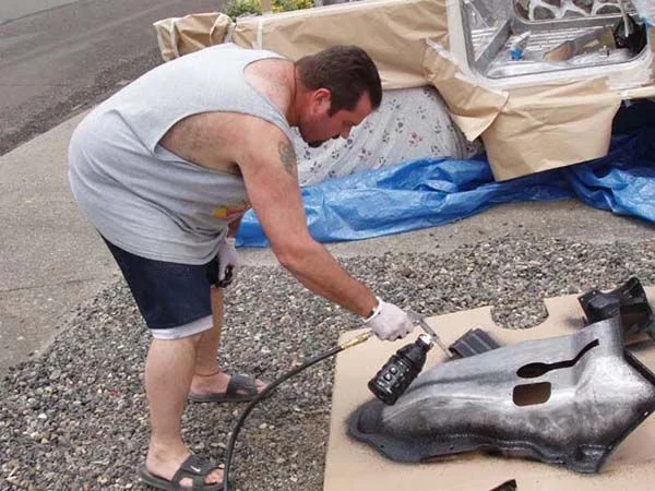

1 more
pics. Note I plugged the bolt holes with Golf tees and foam ear plugs.. Worked fantastic!

Posts: 1,259
I used Dupli-Color truck bed coating . 1 gallon was $46.00. I used 1 1/2 gallons

What liner did you use? Where did you get the gun to spray with? Great tip to use golf tees and ear plugs. I am writing that down for when I spray mine.

Posts: 1,259
I got the Schutz gun at an auto body supply place for 20.00. The jug is a Gatorade bottle. I ran 45 psi to shoot it. I had to thin the coating slightly with acetone so it wouldn't glob and spray chunks. I will let it dry 1 more day before I put the stuff back in it.

Looks great... I have a quick question.... Can you guess about how thick you put this stuff on??? I've seen a few threads w/ folks talking about how thick they thought they "needed" and how many coats. I'm not sure how much that matters unless you really beat on it. You put one coat, correct???
Anyone got their $0.02?

Posts: 1,259
I did 2 generous coats. I would guess that it's about .040 thick or so. I may need to put thicker coats down in the bed area if it starts to wear. The majority of the work was stripping down to the metal. Shooting was the easy part.

nice work on the liner.. after reading this i think i will have to put some kind of truck bed liner or rhino or whatever the hell we have in new zealand on the deck of my 40... doin a ground up resto...
does this deck liner crap act as a body deadener/noise reduction agent aswell?
well done on the job....

It's hard to tell if the sound has been deadened yet as I am running with the top off. I'm sure this winter when the top goes back on I'll be able to tell.

I used the same stuff, Duplicolor, and my only regret is not painting over it.
It has held up really well, but looks dusty all the time...because it is. You sure did a helluva lot of nice prep work!

I do think a top coat of enamel would make it hold less dust and be easier to clean.
