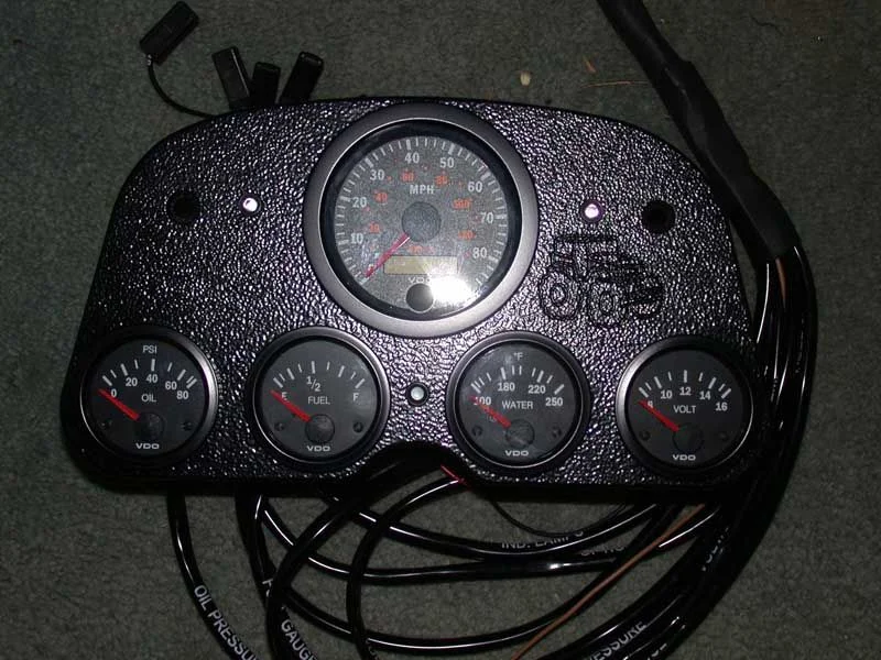

Where did you buy your 3/8 Aluminum instrument cluster? Or did you make it?
The company that offered that bezel and another style of bezel which I also own went out of business about 5-6 years ago. I think the FJ40 engraved into the bezel was a signature of sorts for their company. They did some fine FJ40 mods and offered some nice custom items.

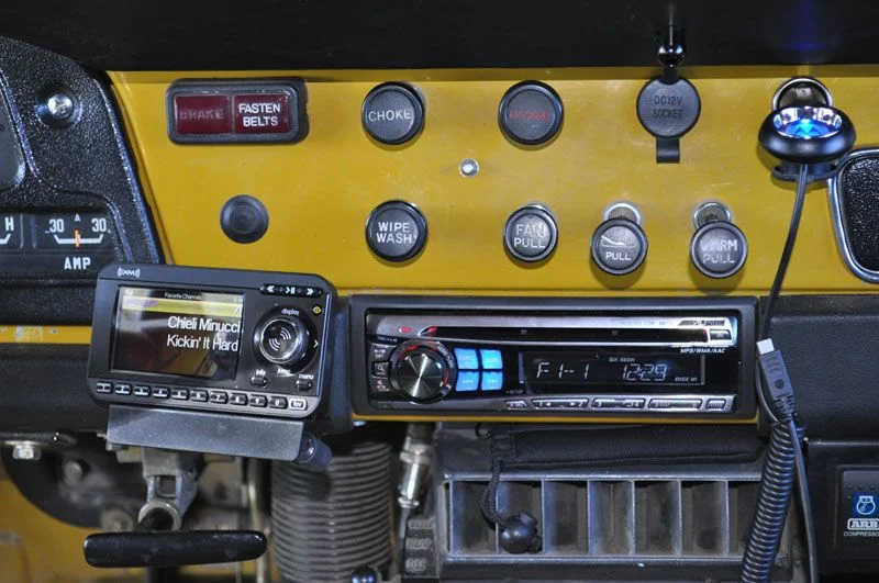

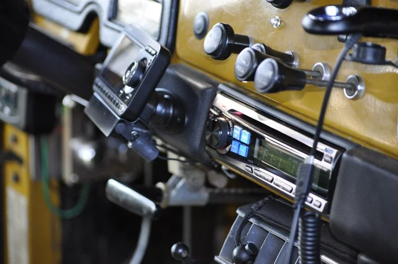

I just realized that I never posted a photo of the new instrument bezel with VDO gauges in this ROTW.

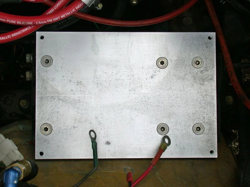

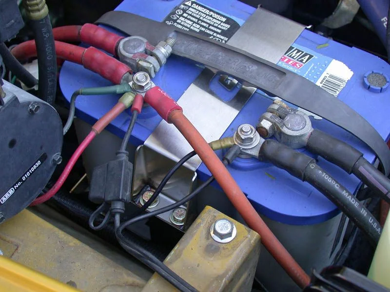

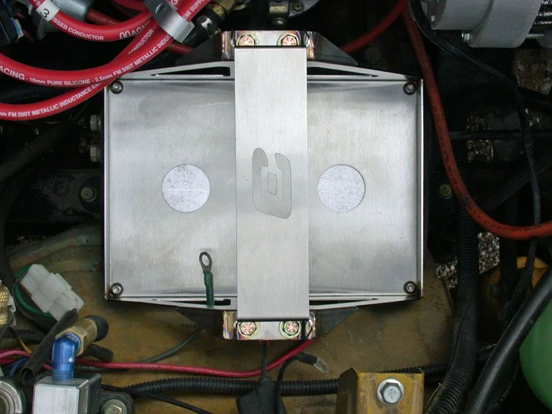

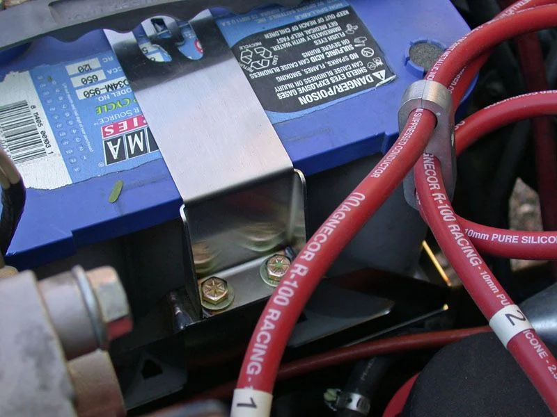

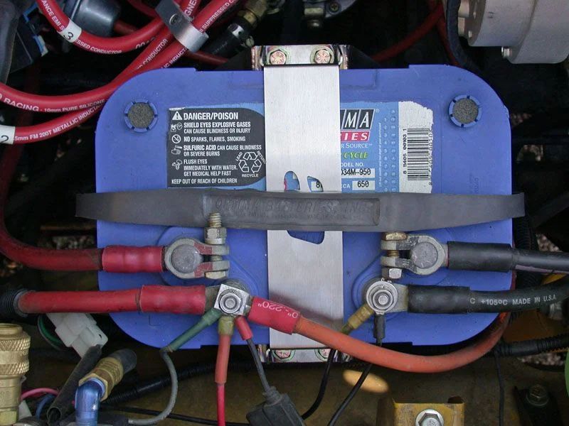

SS Optima Battery Tray
Just got this Stainless Steel Optima Battery Tray from Camburg Engineering. I first had to make an interface plate and had a piece of .250 6061T651 looking for a new home. Getting 6 flathead screws spot on was aided by 4 threaded transfer pins. This battery tray is over 2 inches shorter than the factory tray. Eventually, I will get the Aluminum plate powder coated.

A couple more photos.

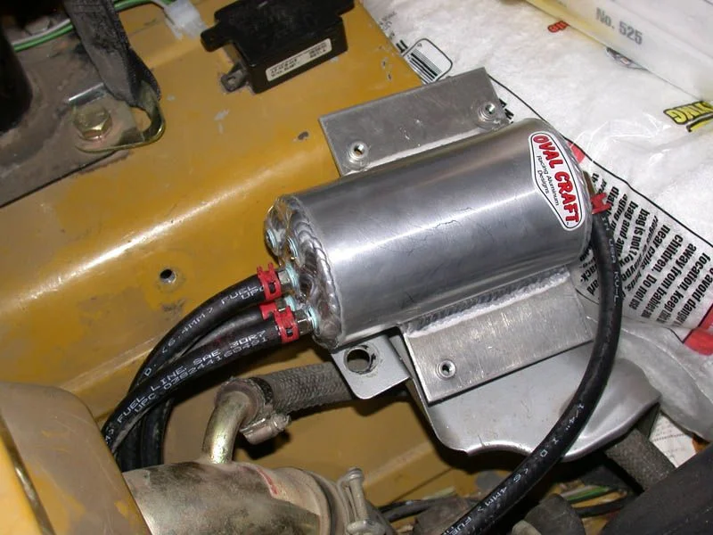

Vapor Recovery Tank
Here is the thread for my Vapor Recovery Tank replacement.

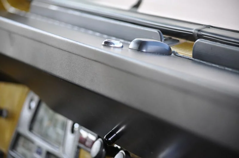

Fantastic detail work. Really like the antenna set-up.

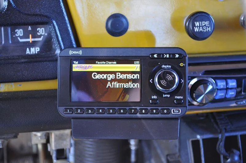

Here are some photos of the new Alpine deck and XM Radio. XM Radio works great with excellent reception wherever I've gone. I also installed the FM modulator which dramatically improves the signal to the Alpine deck.
EDIT: 1/20/09
Well I went wheeling in the mountains today and found that there were a number of times that I lost the XM radio signal for a short period (no more than 5 minutes). Clearly there are situations that degrade or block reception of the XM radio signal. I'm still glad I installed the XM radio.

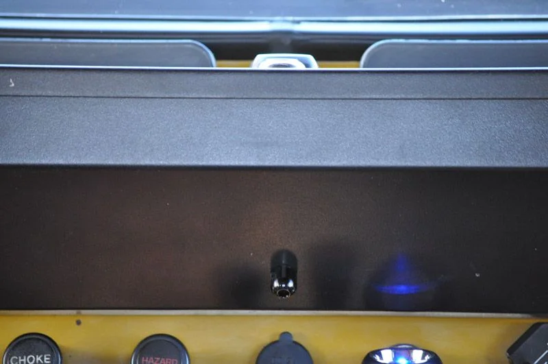

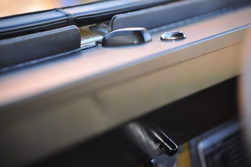

Here are some photos of the XM antenna and the LED dash light I installed in the Dash Box. The LED has about a 120 degree light dispersion and I can see my control switches at night. The light output is consistent with the LEDs I installed in the instrument panel. I decided to align the dash light with the center of the dash box as the light illuminated the instrument panel if I aligned it with the center of the dash switches.
