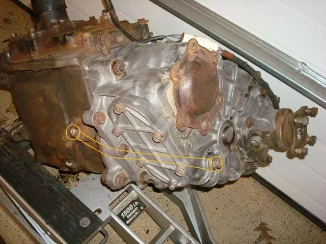

Is this where bypass hose would go if I purchased one?
see yellow line in picture.

Correct
