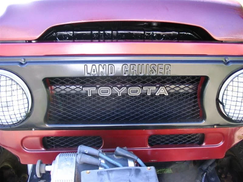

| Got a LC stamped fiberglass bezel! So, I decided after all my research and efforts, the affordable, obtainable fiberglass bezel was the best route for me to go if I really wanted a stamped bezel on my FJ.
So, with the help of Tim over at Landcruiser Specialties, I ordered this bezel. The price was great and shipping fast and he was super helpful on the phone answering my questions about 'glass bezels.
here is 'the' coveted stamp
here is the front
here is the back
here is a closer view of the 'glass
since there is not much written on these forums about fiberglass bezels, I will take this thread to document the process of prepping, priming, painting, modding and mounting as they are not ready to mount as is as you see it here right out of the box.
though I like the chrome look on my current bezel as it matches some of the other chrome pieces, I think I will end up doing this one in matt black as I like it over glossy (since I cannot likely pull off a chrome look on 'glass). I will not likely paint the stamped LAND CRUISER a different color as I want it to be kind of subliminal. |

| so I just spent about 45 minutes prepping the bezel. I sanded it down using 400 grit paper. took out some high spots from the mold and buffed it all out for the primer. 45 minutes seems plenty enough to prep the bezel.
next, I took about 30 minutes drilling holes and laying up for mock-up. I used a dremmel tool on the highest RPM's to drill a starter hole and then used a reaming bit to expand out each hole 1 at a time to get to the right size... lay it up... drill and ream the next. then, sanded and reprepped around the holes.
BUT, I did notice 1 thing that caught me off guard with this bezel. when I laid it up to mock-up, I noticed it did not cover as much space. in the end I measured and the old stock bezel is 10.25"x39.25" and this one is 9.75"x39". .5" in difference on tall side. not sure why as it is made from a mold, so I will call Tim to check on that issue. It still covers everything, but still....
photos to come... |

I so suck at painting, I had to do it 2x as my first coat ran a bit. In the end, turned out pretty nice I would say. I used a flat matt black rattle can enamel.
All in all, I am happy with the product, quality, price, etc. My only issue is that wierd size descrepency... not bad, but it needs to be larger and taller mold made to make a bezel that covers more as the original does. I would reccomend it, just be aware of that. it is actually stronger and more firm and stout than I expected. nicer as well as I expected it to be much more raw than it was. |
