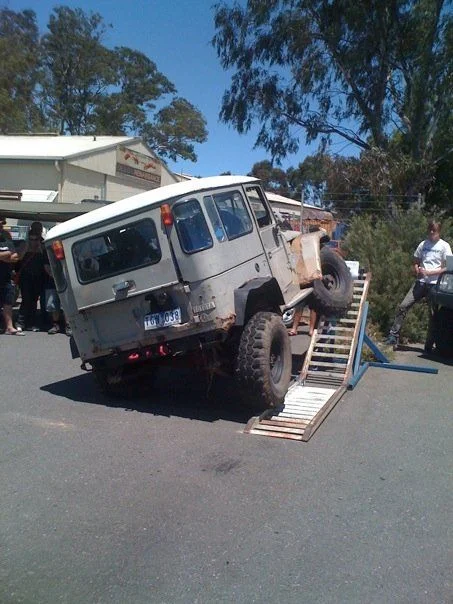

not "ultimate", but my old hack setup worked well this weekend. no wheeling pics yet, but it did ok on the 30 degree ramp.
more important than outright flex is having flex balanced front to rear. my old setup had great rear flex, and little front flex... wheeling this new setup is so much better, the body sits level through almost anything,

So bear with me here cuz I'm not trying to . Bad_Religion_AU, are those stock height 55 springs that you've modified, or are they lifted 55 springs? If they're lifted, what lift size? Also, where did you get the longer leafs that you put back in? Thanks!

standard (good condition) 55 springs.
the rears are standard 55 pack minus the overload spring. next trip out i'll probably try one more leaf in the pack because the rear is a touch softer than the front.
fronts are from the same 55.
tbe fronts are made up of a combo of the longest leafs from the standard 40 pack that came out, and the 55 pack.
