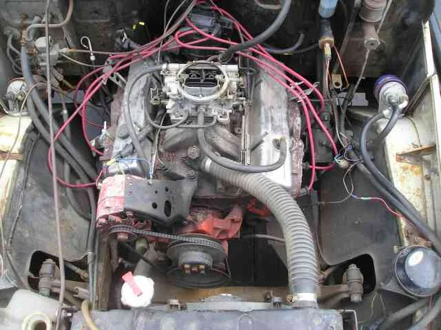

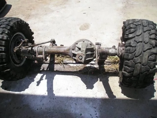

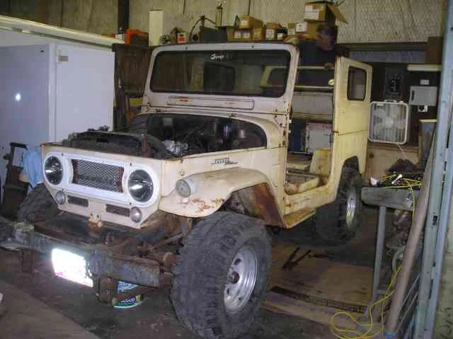

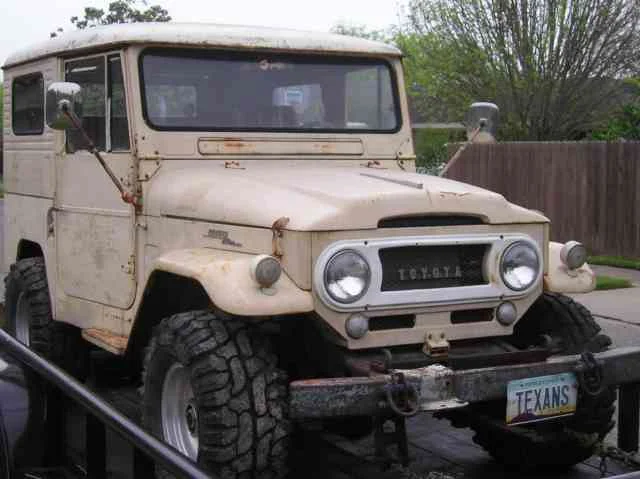

This is her right after I bought it.

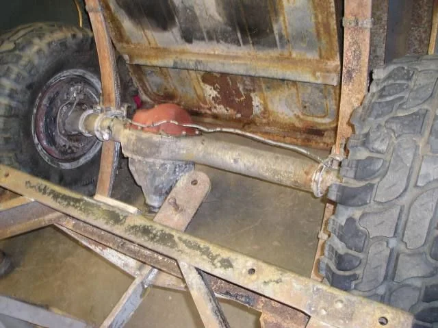

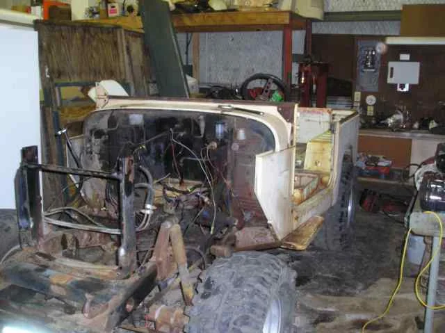

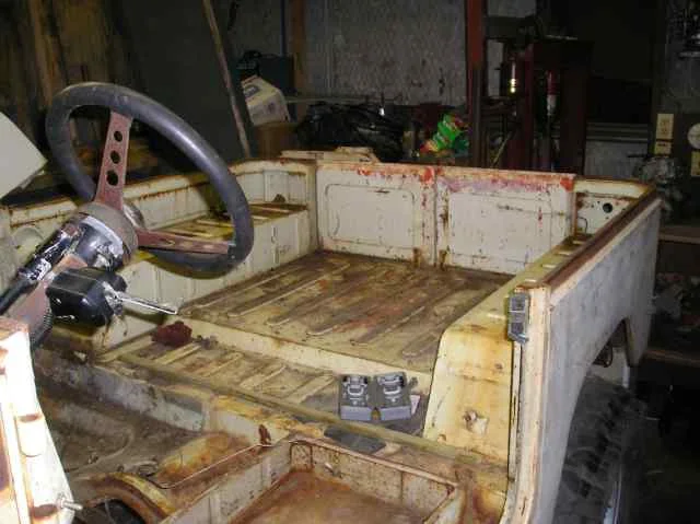

Then we just started taking her apart.

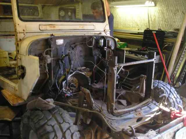

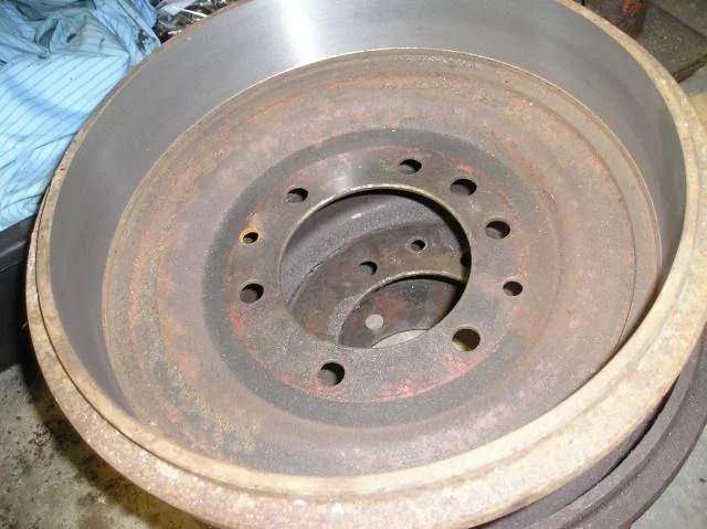

Still taking her apart.....

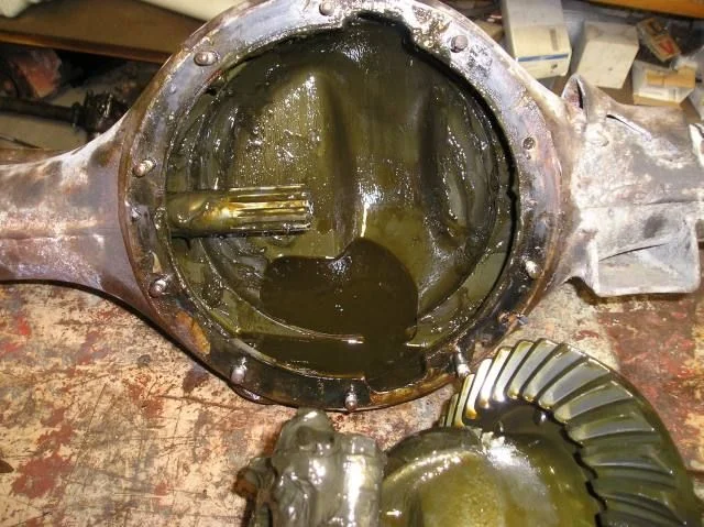

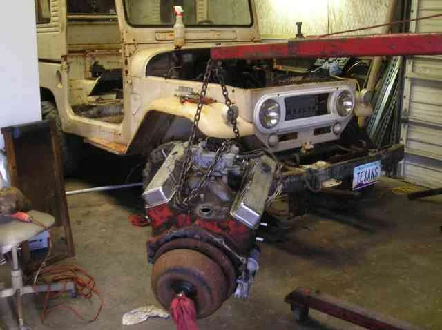

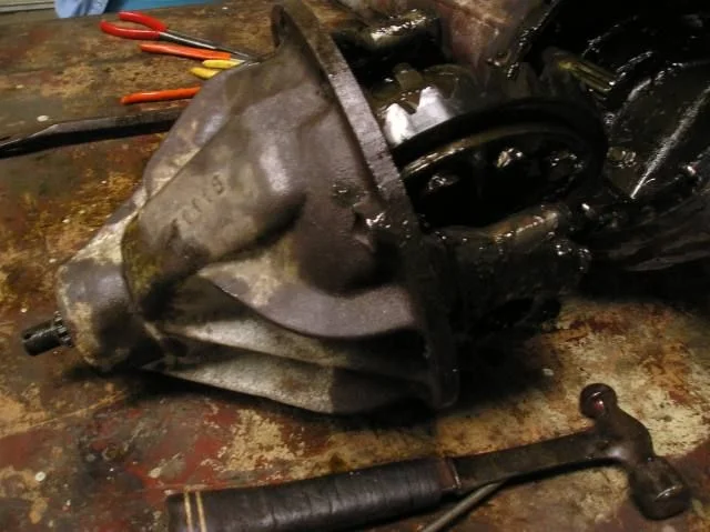

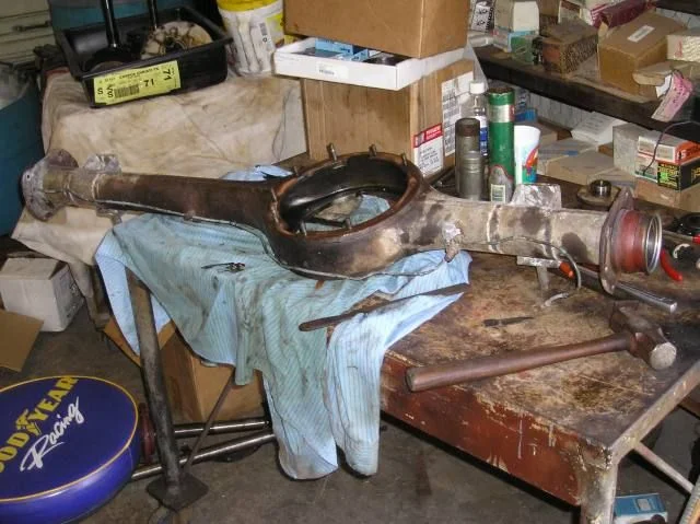

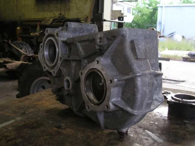

Then we got the body, tranny, t-case off.
- See the body in the back -
And yes it did come with those Thornturds, but their gone now.

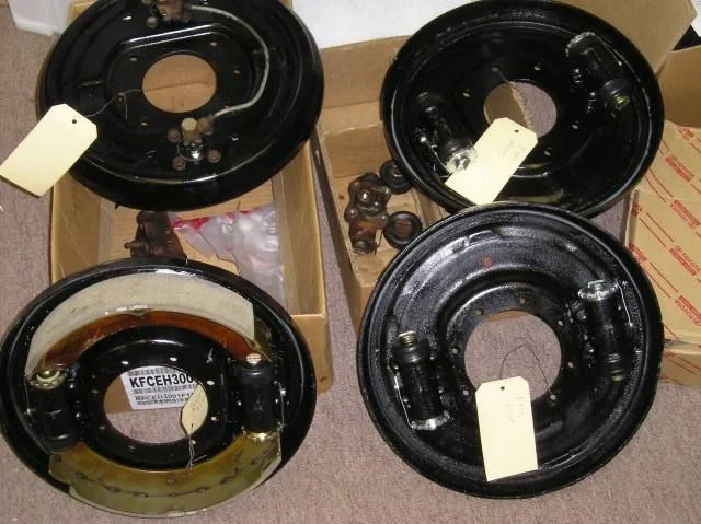

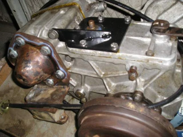

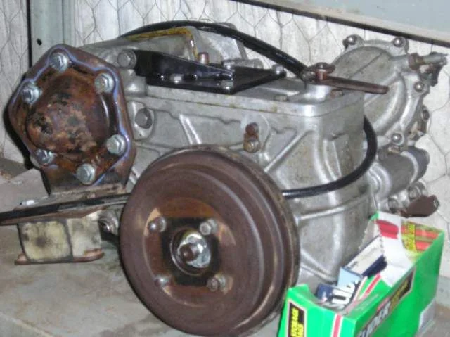

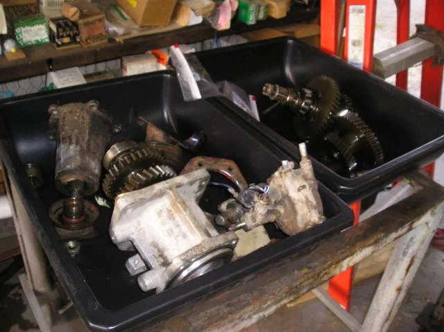

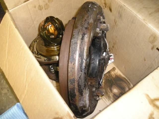

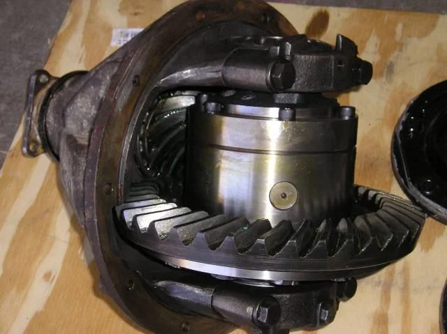

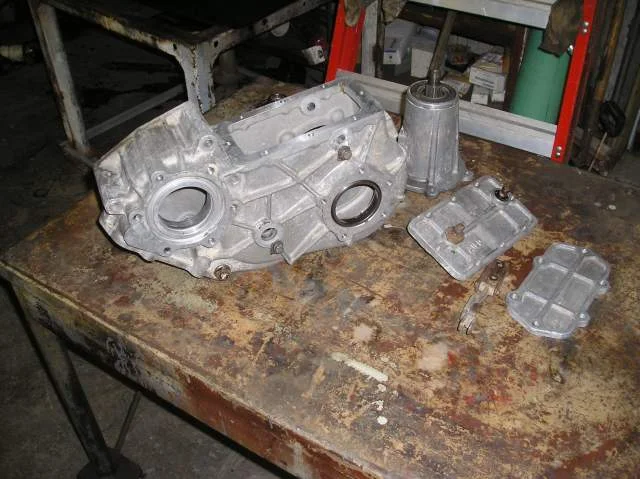

Then we started rebuilding the T - case....

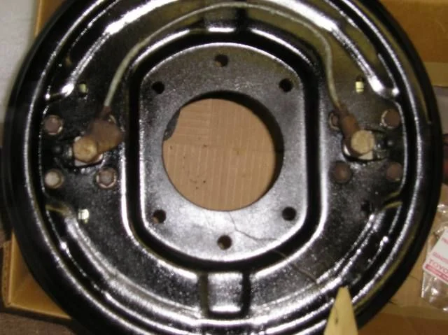

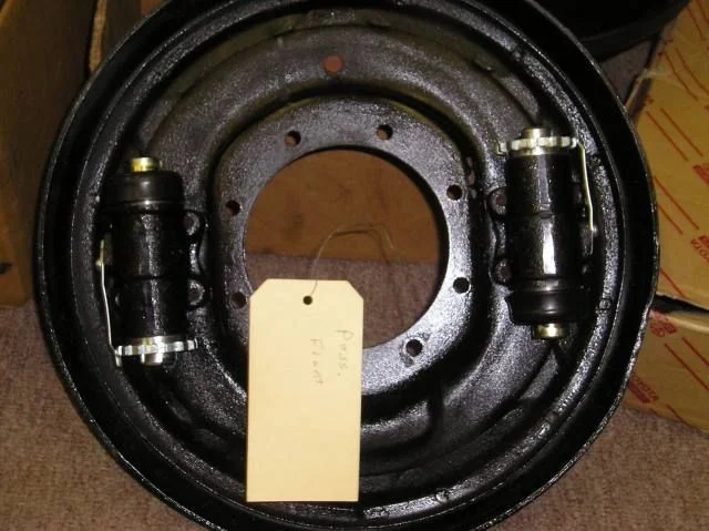

Finishing up the T- Case....

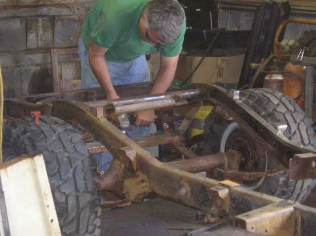

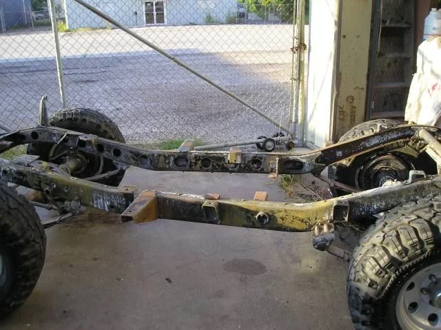

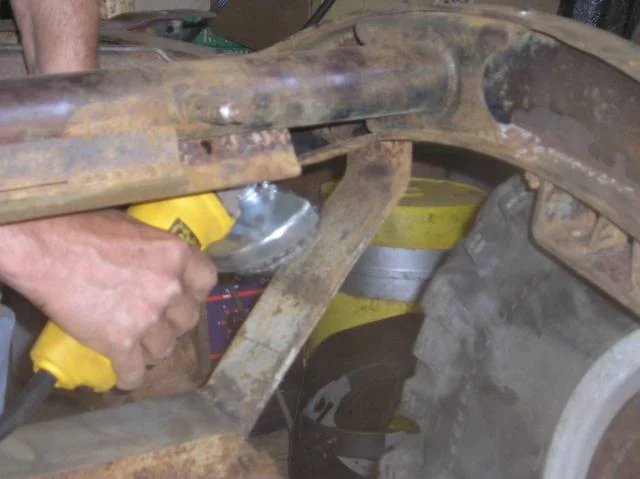

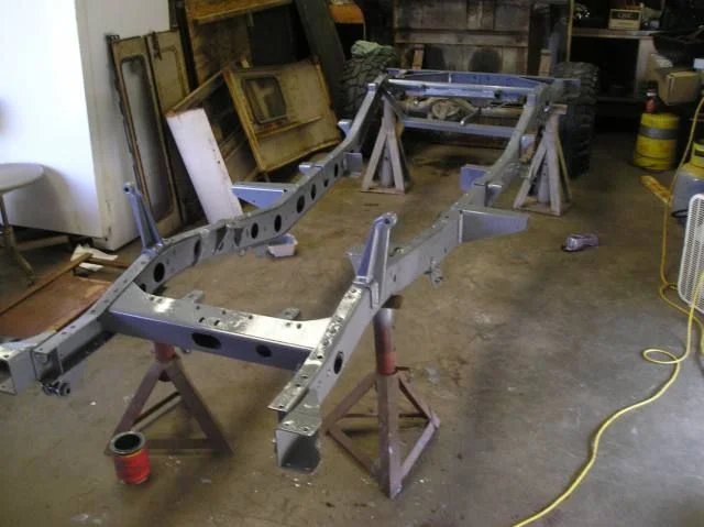

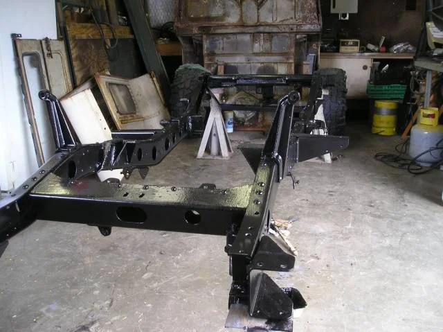

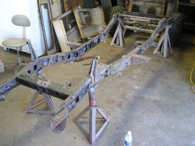

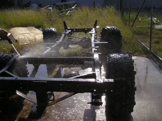

Next we started with the frame.
We got it down to just frame, axles, and springs and then started preping it.
Edit: I guess I should have been more specific in what I meant by prep.
First grinded all the surface rust off I could with wire wheel.
Then rolled a couple shops down and got to use my buddy's steam cleaner on it.

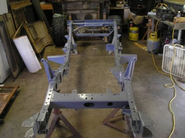

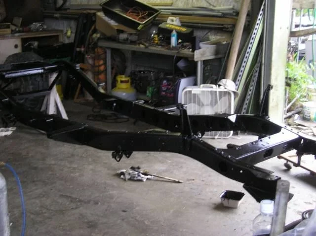

After prep we started getting it ready for the POR - 15 process.
1. Marine Clean
2. Metal Ready
3. Grey POR - 15
4. Black Chassis Coat
These are pics of after the Marine Clean

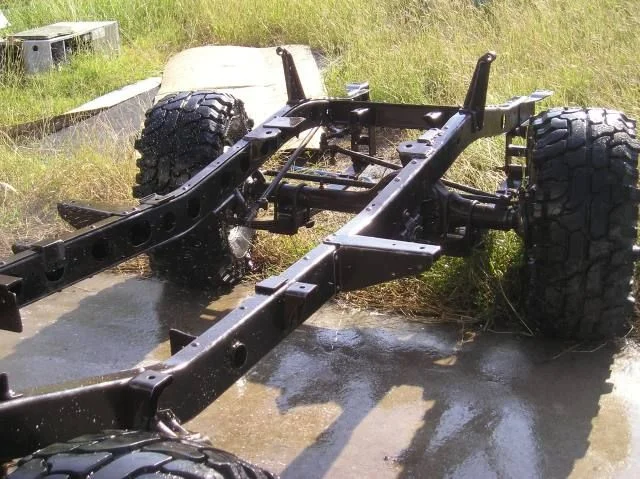

And then the Metal Ready.
This caused the frame to have some Flash Rust...

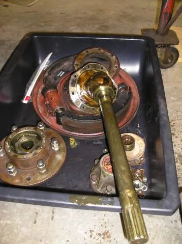

- Then we removed the axles and suspension -
Edit: The flash rust is not a bad thing, it is a sign that the Metal Ready properly etched the metal. Plus POR15 sticks to somthing with a tooth much better than smooth metal.

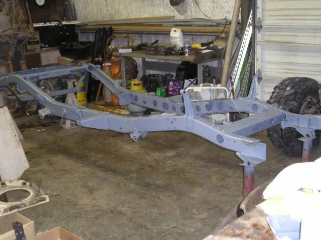

After that we put two coats of Grey POR - 15 on.....

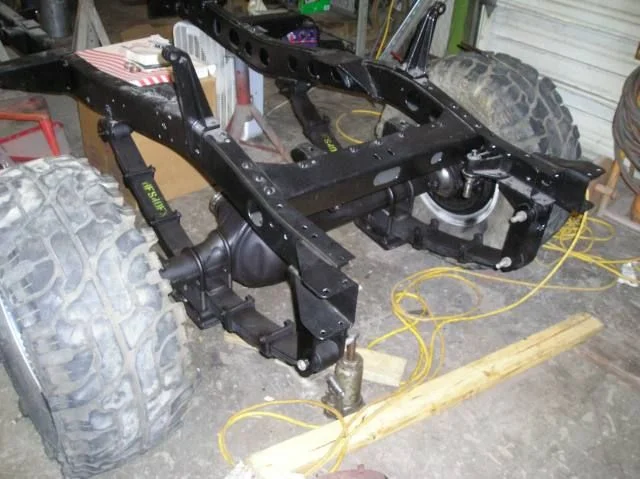

Next came the Black Chassis Coat made by POR 15.
Which we put on two coats of also...

Summary of the POR 15:
It adhered great and would highly recommend it.
Here is the amounts that I bought to use:
I ended up buying 1 gallon of Marine Clean, 1 gallon of Metal Ready, 2 quarts of grey POR 15 (easier to put the black chassis coat of a grey color rather than another black that way you can see all the areas missed better) and 2 quarts of black chassis coat. You should ,in the end, have a little left over which I ended up using on some smaller stuff including the gas tank. Better to have a little left over than not enough.
If yall have any questions about the POR15 let me know
Here is a link to POR 15s website:
www.por15.com
-my64fj40

Posts: 1,625
Started working on the Front Axle next....
__________________
"Jeep, it's what's for dinner."
1964 FJ40- 406 SBC - TH350- HFS 4in- Detroit in rear- 35s
Build Thread:
http://forum.ih8mud.com/showthread.p...87#post1089087

Location: Corpus Christi/Austin, Texas
Posts: 1,625
One more of the stuff I pulled out of the front.
I ended up rebuilding the whole axle:
-All Bearing
-Gaskets
-Knuckles
-Brakes
-Etc..

Here is a pic of the gears from the T-case and the adapter,
forgot to post with the other T-case pics...

I started going through the brakes next..
Put all new:
-wheel cylinders
-shoes
-return springs
And on the drums and drum plates I did a little prep with a wire wheel, then painted them with a galvanizing compound, and then a high temp paint.
__________________
Build Thread:
my64fj40 is offline   Reply With Quote
Old 04-23-06, 05:09 PM   #27 (permalink)
Site Addict
my64fj40's Avatar
Join Date: Aug 2005
Posts: 1,625
Also had all the drums turned...

After I had the front axle done I mounted it onto the chassis.
I made the stupid mistake of mouting the spirngs the wrong direction.
Don't worry I fixed it.
__________________
Build Thread:

Then I started the rear axle..
__________________
Build Thread:
Old 04-23-06, 05:41 PM   #30 (permalink)
Site Addict
my64fj40's Avatar
Join Date: Aug 2005
Posts: 1,625
Got some goodies for the rear axle:
Later model shafts off eBay
and a
Detroit Locker
The rear axle also got all new bearings.
