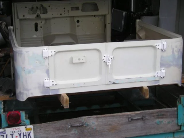

O.K. finally found a place here in Corpus that would sell DuPont paint products to me..
After talking to the old feller paint expert he told me this is what I need to do..
Put a couple coats of
Corlar 2.8 HG-D which is supposed to be highbuild
If it doesn't smooth out quite the way I want it too then I already have some other highbuild primer to go on after that
Then go with 2 or 3 coats of Imron 5000 Low VOC 3.5 HN
This Imron should be bullet proof

Picked up some paint supplies and got the cobwebs cleaned off the body..
Hopefully will get to paint this weekend

Join Date: Aug 2005
Location: Corpus Christi/Austin, Texas
Posts: 1,625
Still geting this thing ready for paint..
Mocked up the tailgates, latches, sparetire carrier hinges, and latch for the carrier. Had to drill new holes for just about everything since the new panels and channel don't come predilled..
For my new c-channel where the part that the spare tire carrier latches too apparently had a backing plate on it as well. I thought I was never going to get thrugh those 3 layers of steel
Forgot to get a pic of the carrier while I was there, just the tailgates..
Next time I get to the shop and actually remember my camera I'll shot a pic of it mounted.
