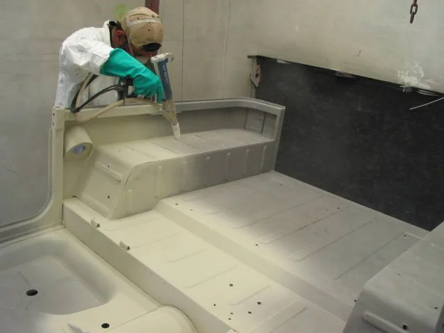

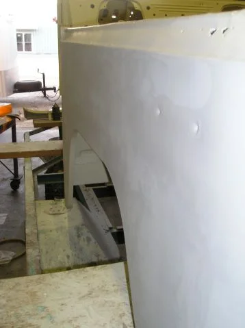

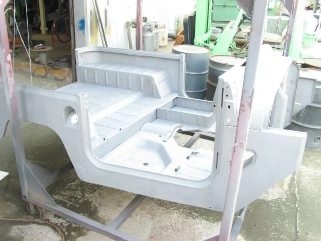

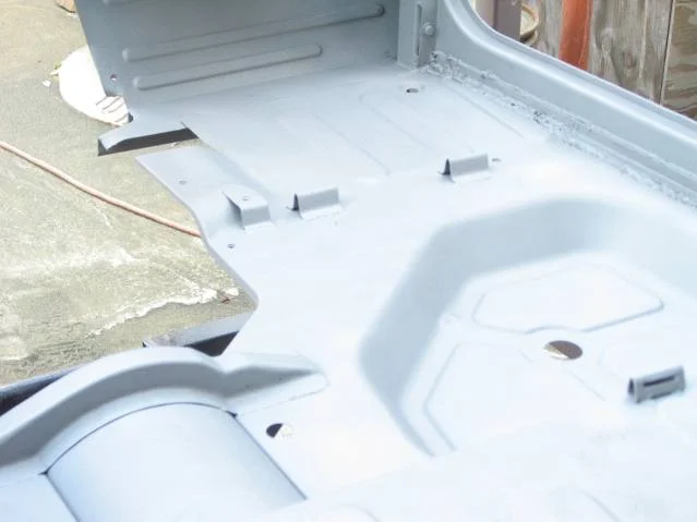

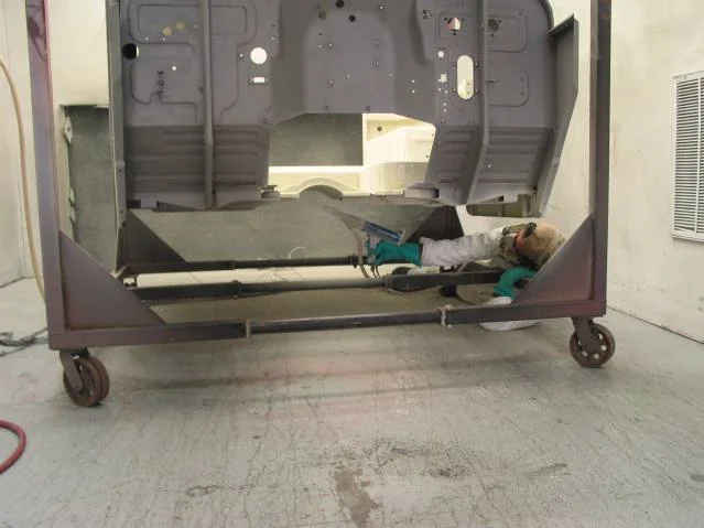

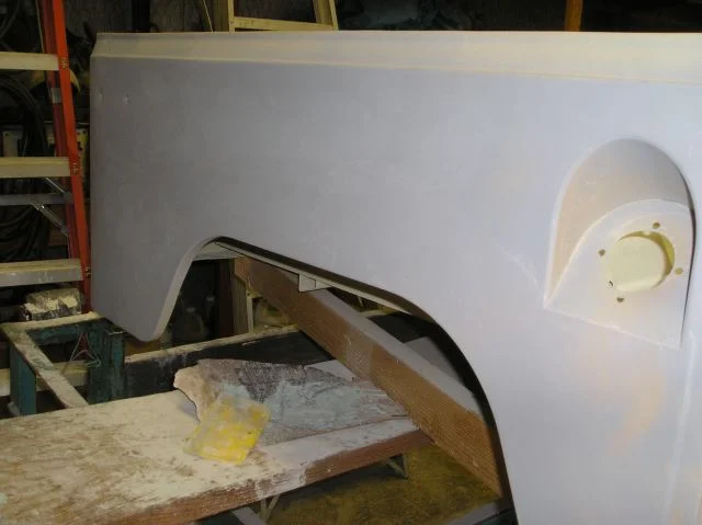

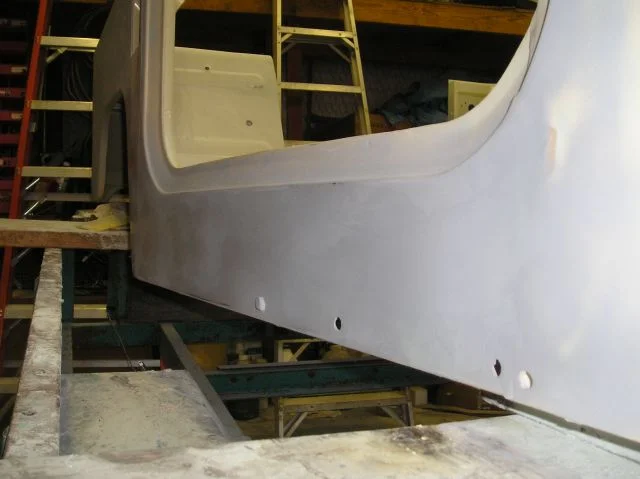

Got some pics from the powdercoat guy of what the tub looked like sandblasted and as they were painting it...
This is some pics of it blasted....

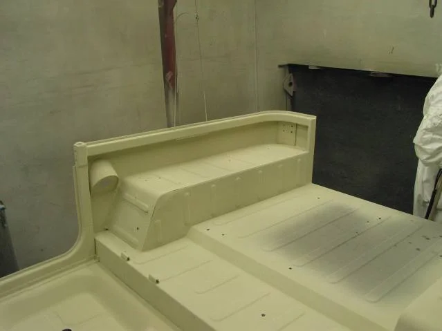

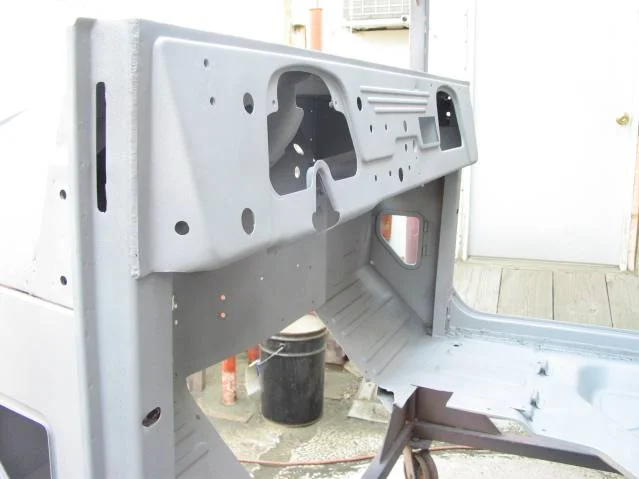

And here they are coating it...

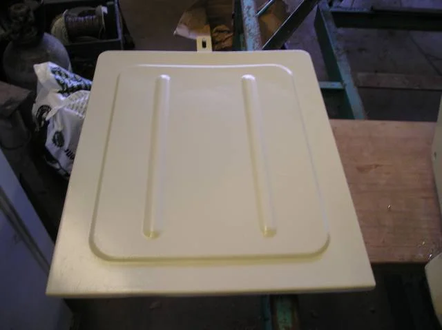

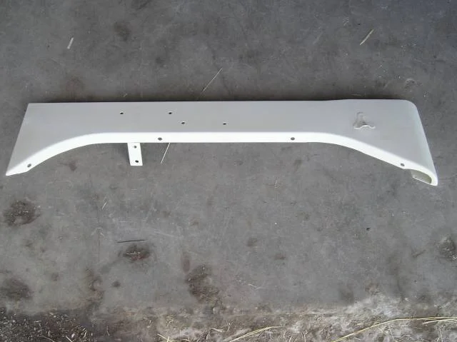

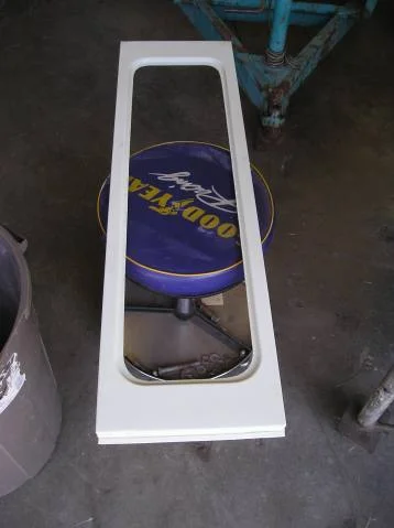

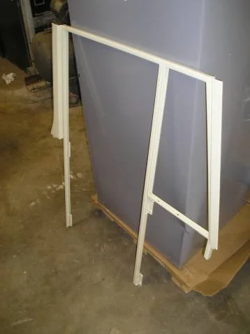

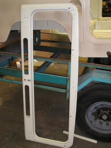

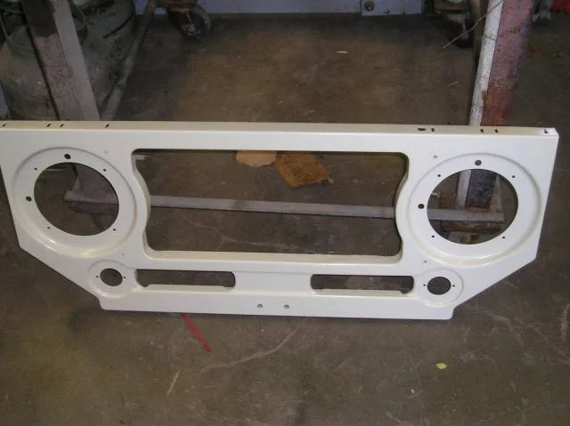

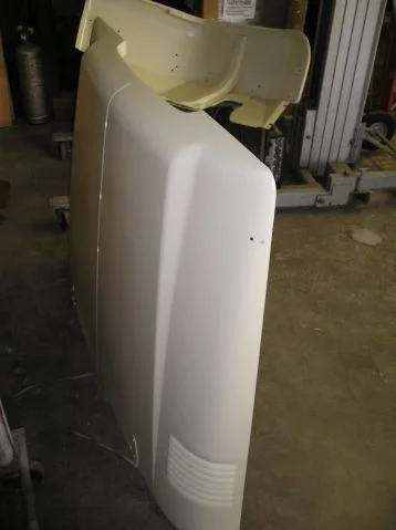

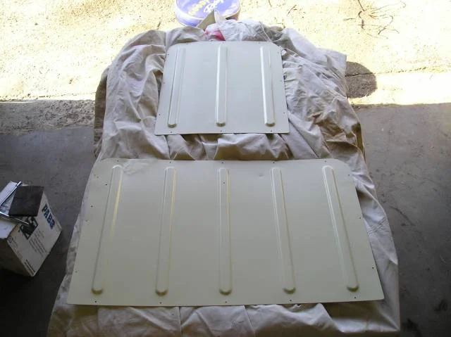

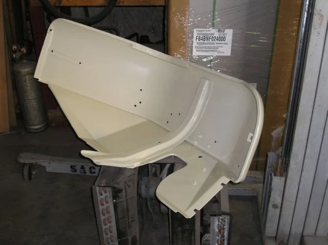

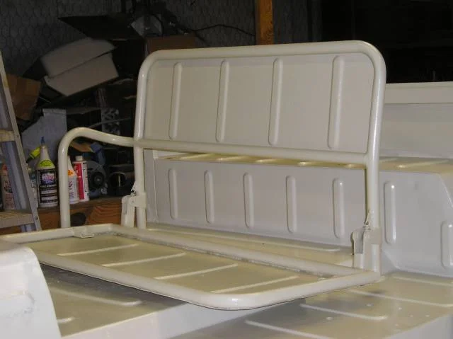

Also got back a bunch of parts for the cruiser back from sandblast and prime...
(Sorry for the terrible backgrounds of my shop)
Here's a list so far:
Running boards
Both parts of rear bi-fold
Both rear tailgates
Tool box lid
Windshield frame
Tranny Hump
Aprons
Front Bib
Inside Door Frames
Backs to stock seats
A Jump seat

A couple more...

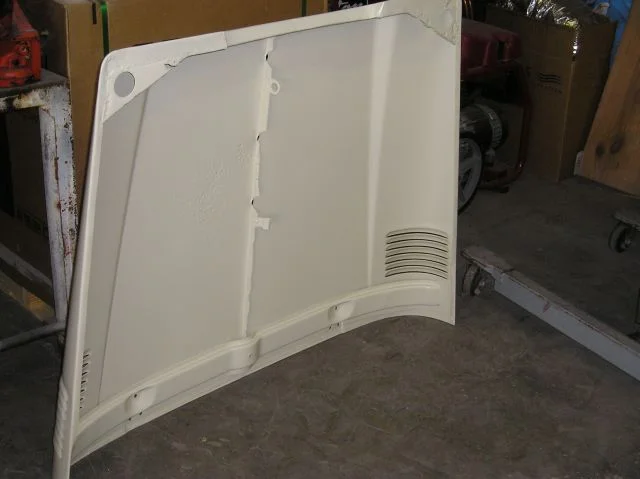

Few more...

Last ones...

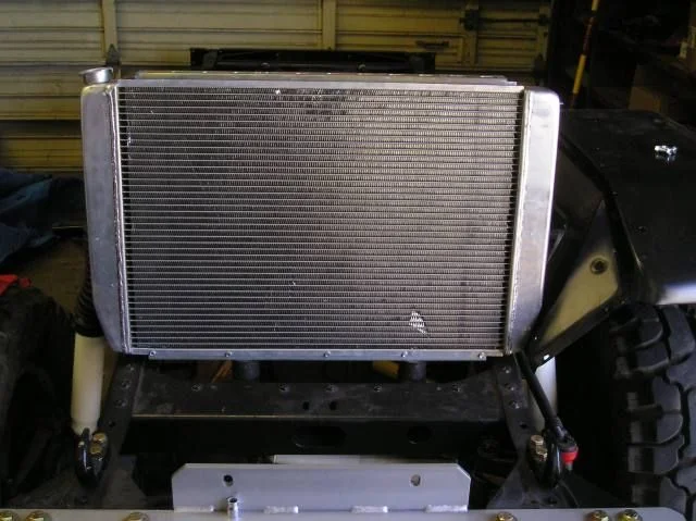

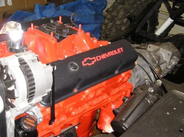

Location: Corpus Christi/Austin, Texas
Posts: 1,625

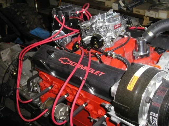

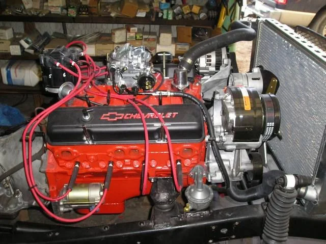

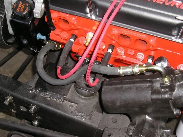

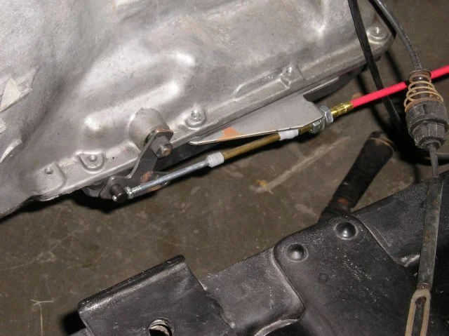

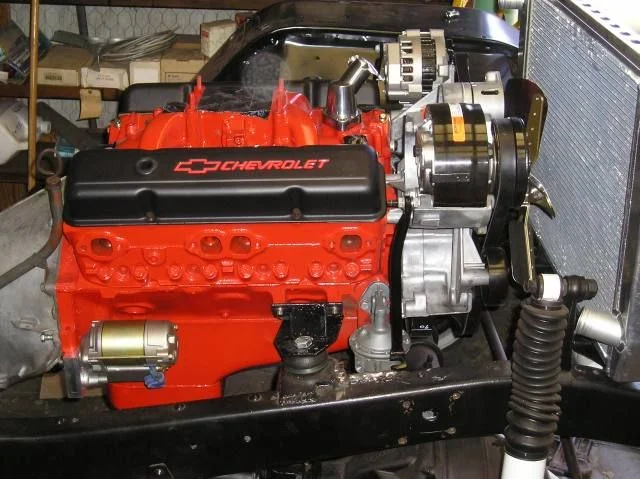

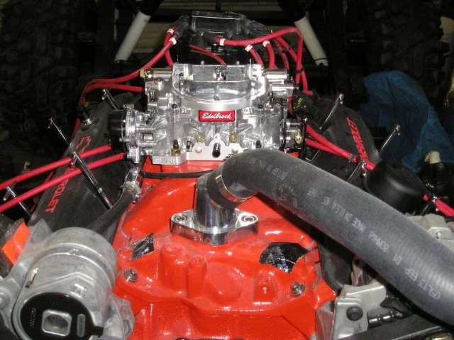

Here's some updated pics of the engine..
I did a couple things to it:
Got some decent valve covers
Put thermostat and housing in
Put spacer along with flex fan in
Installed a mini-starter
Installed Torque convertor bolts.
Made a support for the radiator and installed the radiator. I make some supports that run to the front of the tub from the top of the radiator once I get the tub back on the chassis.
I can't wait to crank her up

Powdercoating the body.. Interesting, The color looks really close to stock.
What are you doing for the rubber on the bifold? resuising?
Looks good. Keep the pics coming. I need to start on my 64 one of these days.
__________________
1964 FJ40 | 1966 M416 | 1976 FJ40 | 1985 BJ70 Volvo Power| 1997 FZJ80 | TDI commuter car
Rising Sun
; Former CLCC
You should be able to delete your own thread. Communists abound
Real Change is here --> Cato Institute
wesintl is offline   Reply With Quote
Old 05-19-06, 07:59 PM   #74 (permalink)
Site Addict
my64fj40's Avatar
Join Date: Aug 2005
Posts: 1,625
Quote:
Powdercoat as primer only...
Going to put a finishing primer over that and then a Imron topcoat..
SOR sells some rubber that will work for the bifold
The rubber for the hard top side windows is the same type as the window in the bifold so I just going to get that and trime to fit...
Not sure what I'm going to do on the sides of the bifold though..

Ok thats hard core.
How much thickness does the powdercoat primer add? Does it cover OEM spot welds?
__________________
1976 FJ-40
2001 UZJ-100
Pain is just weakness leaving the body.
"Do not go gentle into that good night.
Rage, rage against the dying of the light." - Dylan Thomas
Ullr is offline   Reply With Quote
Old 05-19-06, 08:50 PM   #78 (permalink)
Site Addict
my64fj40's Avatar
Join Date: Aug 2005
Posts: 1,625
Quote:
Originally Posted by IanB
Ok thats hard core.
The powdercoat doesn't seem to add a whole bunch of thickness since it is only a coat of primer... Normally it is the topcoat that adds the thickness
Not sure how to expalin it, it added a nice layer. Slightly More than normal paint. But you can still see the OEM spot welds just fine, which I'm undecided about keeping or not...
I think the cruiser should end up having a good coat of paint on it in the long run...

Got to do a little work on the engine today...
All I need to start her is a battery, fuel, and I still need to hook up the return for the power steering...
Does anybody know where I can find the nipple for this gear box, I got the one from JT but the threaded part is to big
Also still waiting for the Ram Horns to get back from ceramic coating
They had a color that was supposed to just about match chrome, so I couldn't resist adding a little bling to engine

The conversion line from JT did match but they didn't crimp the fittings on the hose at the right angles so the line has a little twist in it, but I think it should still work o.k.

Also got the shift cable hooked up for the tranny...

Got a few things back from blast and primer today...
They did a good job, but I wasn't expecting to find little pinholes blow through on the doors
And to think they were not even visable before blasting....

Now for some good news...
Hood and one fender...

Fender....

Did some body work also...
Gonna start sanding some of this high build primer off tomorrow...

Well i finally got my engine started..
It started out kinda tuff getting all the wiring set up right and i also set up my oil pressure, water temp, and tach hooked up so I could watch over teh engine as it broke in..
And did I mention that I started it the first time with no exhaust manifolds on
It was cool watching it shoot flames out, but I got worried that I was going to burn the wires and such so I found some old ramhorns to through on there..
Once I got the timing set she starts as soon as you touch the key, My timinglight showed it was at 6 degrees, not sure what is normal for my 400
Got scared a few times because I started hearing some terrible screaming sounds, luckly it was only the Power steering pump asking for some more fluid..
The oil pressure is real consistent at 50, but the water temp still worries me a little.. I get started and run her up to 2000 RPM and she was running around 210 degrees, I put a fan blowing on the front the radiator and that brought down to 190 degrees..
Would running distilled water instead of antifreeze cause the temp to be higher???
I'll get some pics tomorrow, forgot the camera (too excited about starting her)
