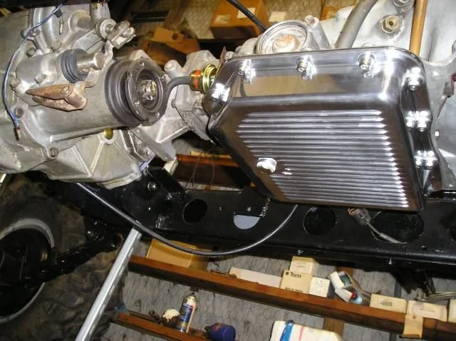

After the two axles I took the tranny (TH350) to be rebuilt. As I came to find out I didn't have some of the special tools needed.
I used a Raptor rebuilt kit, so I guess it can be considered a Raptor Transmission.
This is a pic of the T-case and tranny installed along with the axles, suspension, and driveshafts, steering, and Mini - truck powersteering.

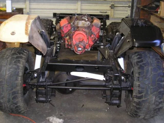

In this pic I'am mocking everything up for the new engine.

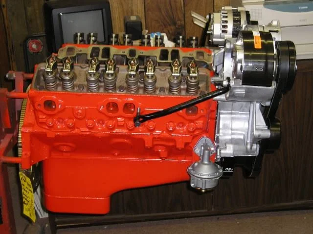

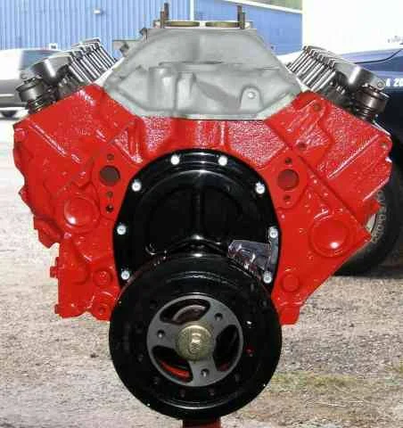

Posts: 1,625

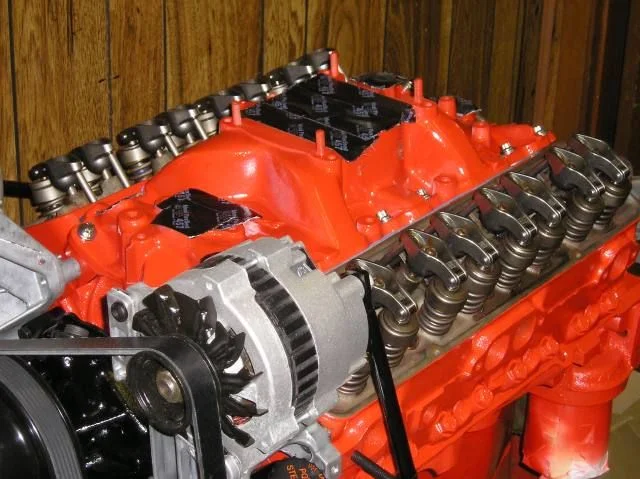

And here is the some pics of the new engine.
Sorry I can't help but show her off...

Posts: 1,625

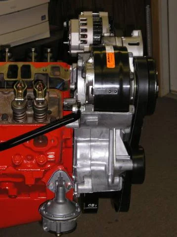

ANd here she is after putting a GM Serpentine Kit on...

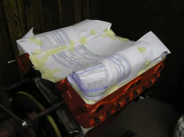

Posts: 1,625

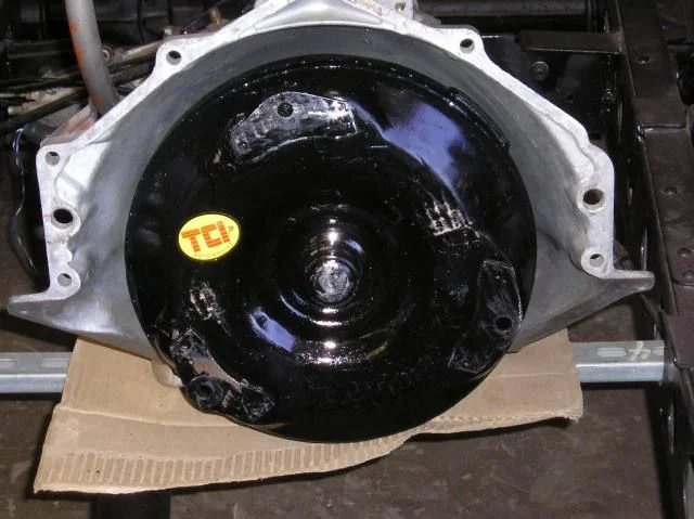

Then put the intake on.
I didn't like the way the Edelbrock intake was lookin with bare aluminum so I decided to give to a couple coats of high temp paint and a clear coat.
Then I went ahead and put my TQC in the tranny.
And dropped the engine in with it,,,

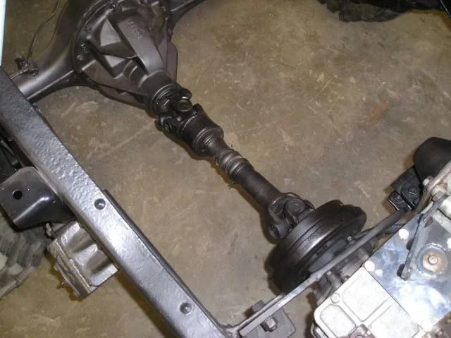

Posts: 1,625

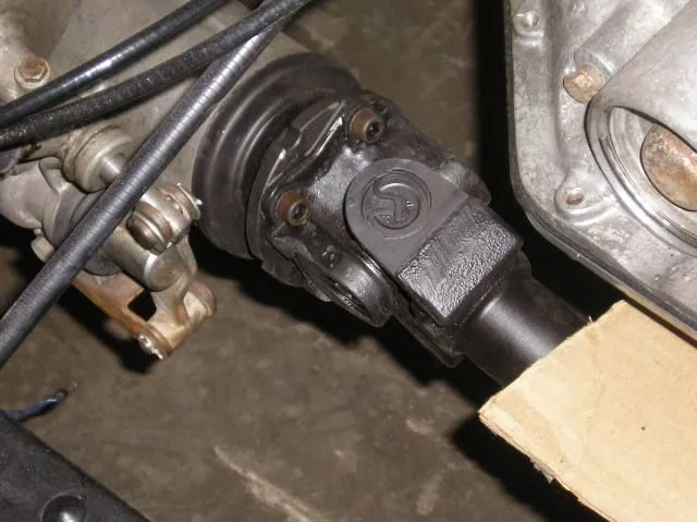

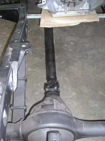

Put some new U-joints in the driveshafts, ended up making the rear one a little longer. And also put an AA kit on the front so I would have to modify the tranny drain pan, along with new ujoints...

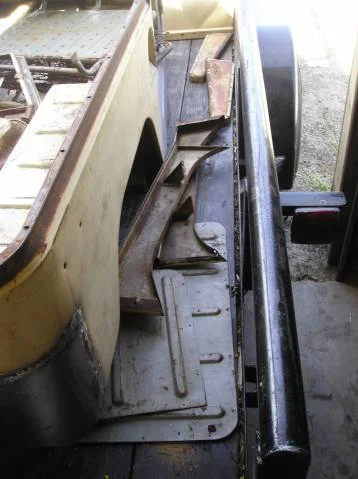

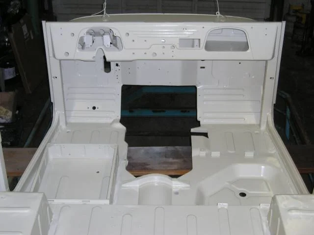

Posts: 1,625

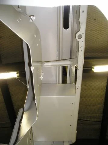

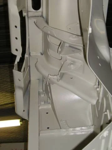

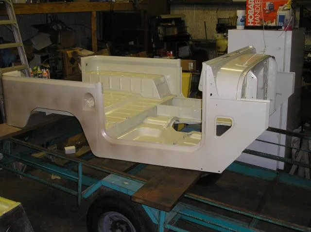

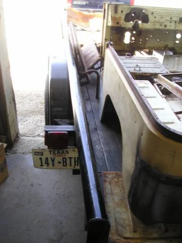

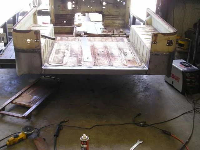

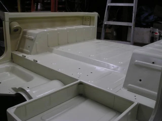

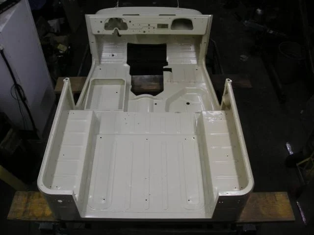

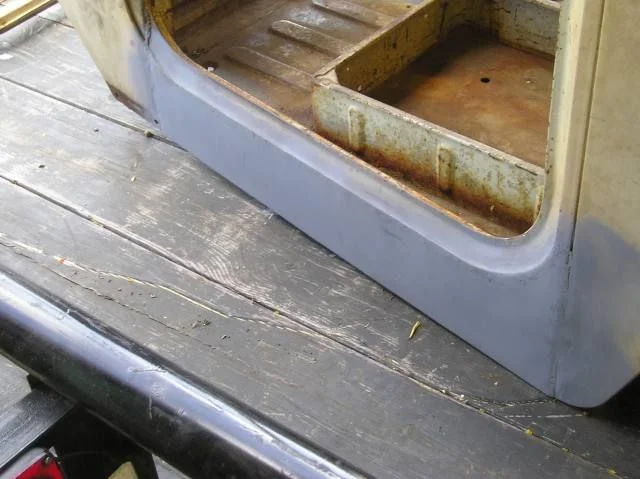

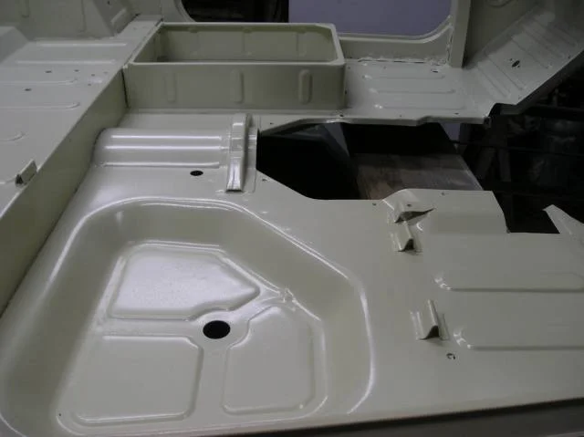

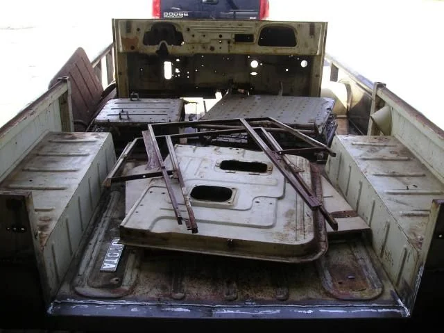

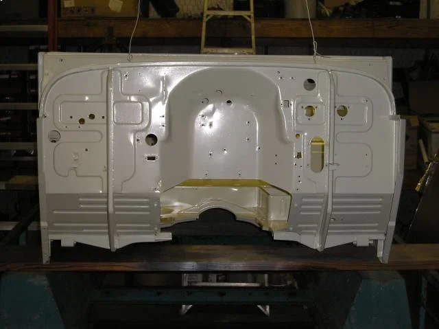

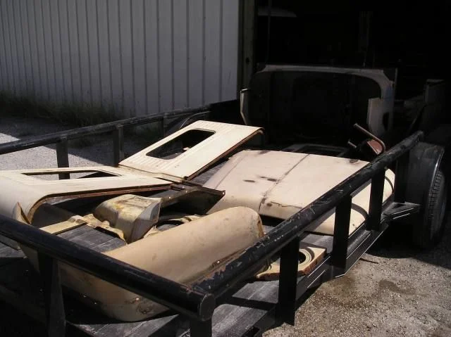

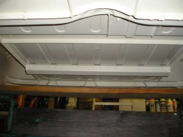

Here is some pics of the body work I did...
I replaced:
1. Metal under the doors on both sides.
2. The rear sil including a new c - channel
3. The rounded c-clips on the rear of the cruiser.
4. A few little spots that I welded up.

Old 05-06-06, 03:20 PM   #50 (permalink)
Site Addict
my64fj40's Avatar
Join Date: Aug 2005
Location: Corpus Christi/Austin, Texas
Posts: 1,625
Then I through everytthing on my flat bed and took it to sandblast and prime.
The place the did this for me was a powdercoat business and luckly they have a oven that the tub would fit in to. SO............

Uno mas...

Old 05-06-06, 03:24 PM   #52 (permalink)
Site Addict
my64fj40's Avatar
Join Date: Aug 2005
Posts: 1,625
And while that was being done I took a vacation up the Dallas..

Old 05-06-06, 03:26 PM   #53 (permalink)
Site Addict
my64fj40's Avatar
Join Date: Aug 2005
Posts: 1,625
And by the way all the body pieces that I used came from REAL STEEL CRUISER PARTS.

Old 05-07-06, 05:18 PM   #54 (permalink)
Site Addict
my64fj40's Avatar
Join Date: Aug 2005
Posts: 1,625
Then we got the tub back from sandblast and powdercoat prime....
__________________
"Jeep, it's what's for dinner."
1964 FJ40- 406 SBC - TH350- HFS 4in- Detroit in rear- 35s
Build Thread:
http://forum.ih8mud.com/showthread.p...87#post1089087
my64fj40 is offline   Reply With Quote
Old 05-07-06, 05:20 PM   #55 (permalink)
Site Addict
my64fj40's Avatar
Join Date: Aug 2005
Posts: 1,625
Here's a couple more....
__________________
Build Thread:
Old 05-07-06, 05:51 PM   #56 (permalink)
Site Addict
my64fj40's Avatar
Join Date: Aug 2005
Posts: 1,625
Here's a closer pic of some of the body work...
I'll still have to use a little layer body filler to make it look perfect though...
__________________
Build Thread:
Old 05-07-06, 05:55 PM   #57 (permalink)
Site Addict
my64fj40's Avatar
Join Date: Aug 2005
Posts: 1,625
The cool thing about this epoxy powdercoat primer is that since it is applied in a powder form that electrical charge can suck that powder up into every little crevice and such...
Can't wait to get the rest of the cruiser back
__________________
Build Thread:
Old 05-07-06, 06:38 PM   #58 (permalink)
Site Addict
my64fj40's Avatar
Join Date: Aug 2005
Posts: 1,625
Anyone know where I can find a Good well known distributor for a decent price for my 400 SBC. The engine builder told me it needs to have a vaccum advance.
Went by some local shops looking for one, couldn't find any, but ended up buying these to replace the stock reflectors..
