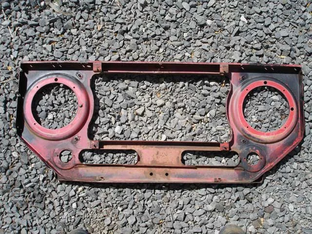

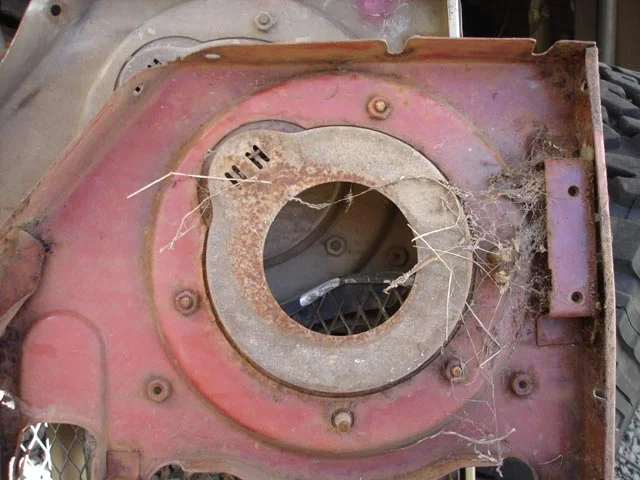

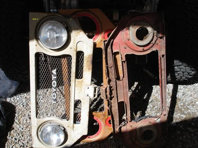

I put the metaltech fenders on and decided to not have fender mounted turn signals...kinda fun.
Decided to breed a 78 front bib with a bib from the 60s. Sure I could have just drilled two holes but that wouldn't have been a real pain in the ass
**No salvageable bibs were harmed in the making of this thread.**

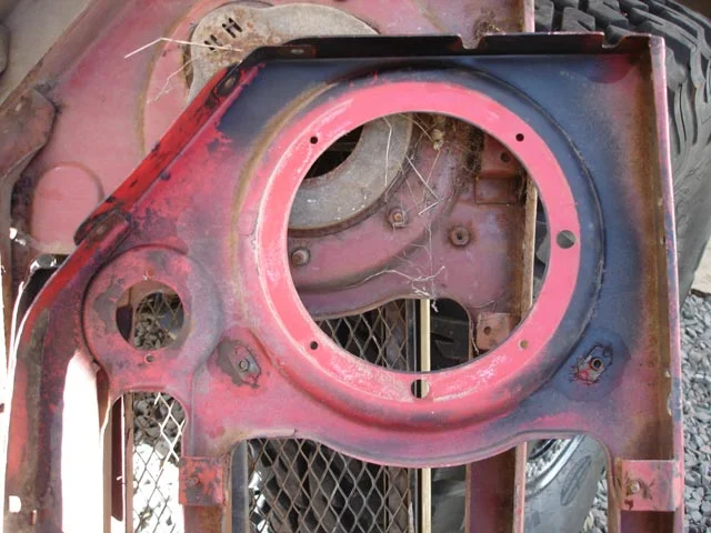

new and older...

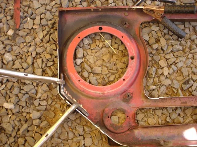

Added the bar stock to the edge to reinforce the corners and clearance them a little bit for the tires. Sure I could have moved the bump stops but again...that would have been the easy fix...
you can see in the top left corner of the 1st pic, the self clearancing the tire did.
Spiders!! I hate spiders - get off!!! hehe **no spiders were harmed either

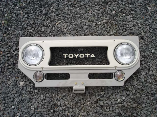

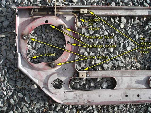

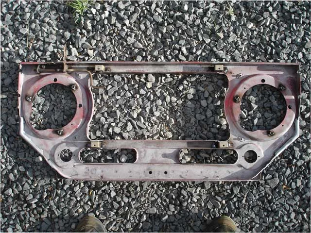

The older style grill screens are angled on top and go beyond the top of the bib. To fit the newer style, you need to move the brackets over. I wanted the hood latch so it's bracket was moved over as well. The headlight buckets on the newer style bibs are slightly different so you have to add the cutout, drill the big holes bigger, enlarge one of the old mounting holes, and add two more. I rewelded the nuts to the back of the retro bib.
before and after:

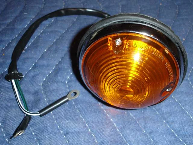

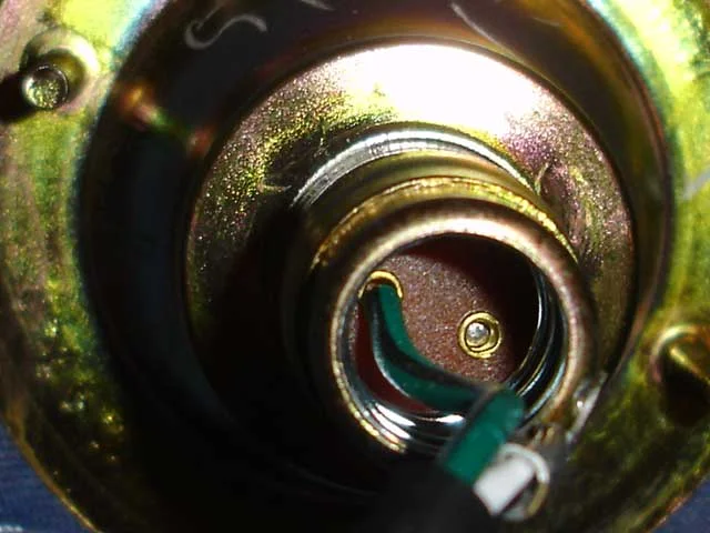

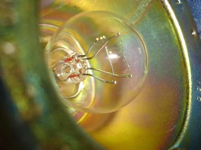

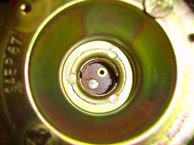

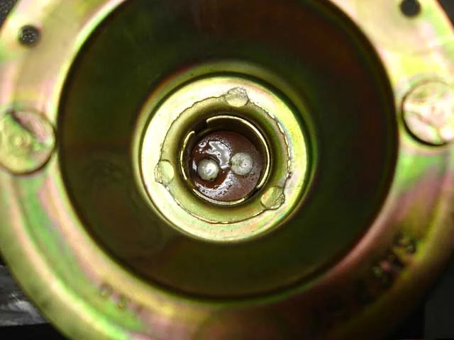

those crazy Toyota engineers :hillbilly
should have been a single filiment but hey, I'm not telling them. Must have been a caryover from the FJ25 days. hint hint
to make the bib light act as a running light and a turn signal, just add another wire (pronounced "war" for those Texans out there. )

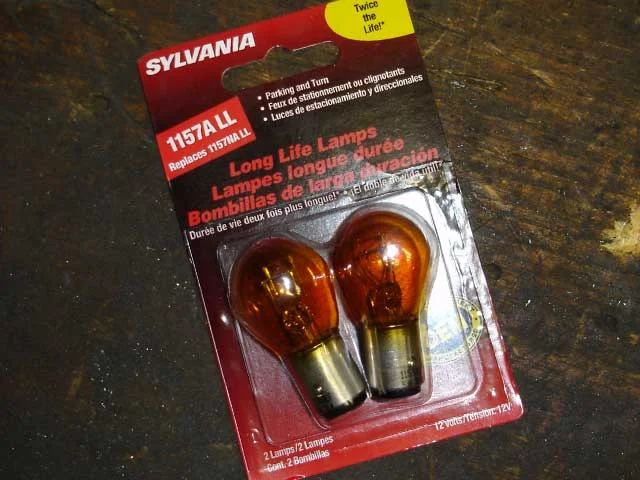

Looks good Mike....
Now get some clear lenses from whoever...and run an amber bulb... 1157A

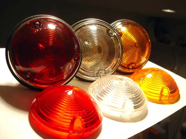

parts from cdan - you rock cdan!!
and...all sorts of lens options - you ROCK Steve!!!

There is plenty of room for the older style buckets. I am just odd like that plus the 45s get pissed when I steal parts off of them.
Check out the clear Poser

Nice mod, I did not know toyota offered three different lense options.

Quote:
the reds are 25 taillights.

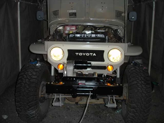

pretty sure you can figure this out but I like pics
and per Poser's request - amber

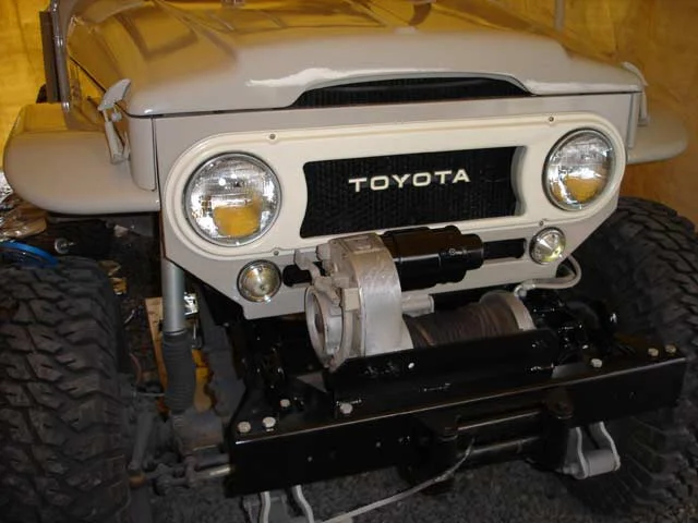

update...

i like those metaltech fenders too. nice combo.

thats tight. i like the lights

Quote:
Originally Posted by pbgbottle
do you have any part #'s for those lenses i would like to try the dealer here in canada i am in the process right now of starting the same project , but have not got the bib lights yet because i wanted the clear lenses . great job bib looks awsome,CDan has no pm .right now ???
lenses aren't available oem anymore...specter has them for a small $, but mike's repro's were done by a mudder when they repro'd the 45lv taillights.
__________________
