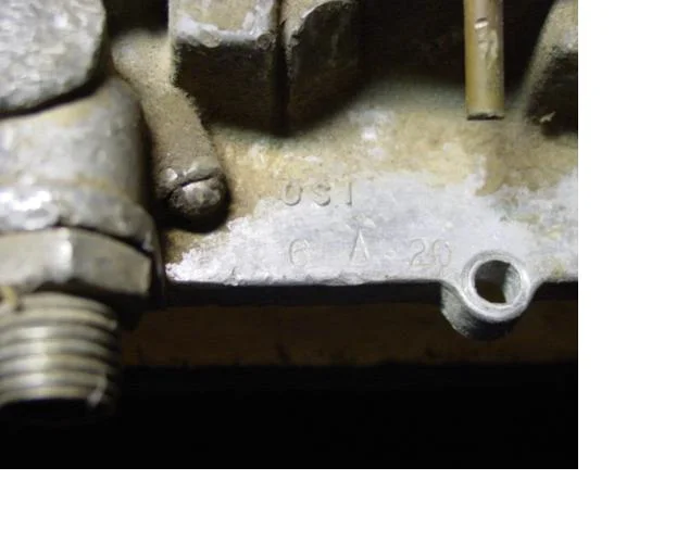

Here is a January 20th, 1976 carb.
It is stamped 6 A 20
We know it is a 2F carb because of the vac secondary design, so it has to be 1975-1987.
We know it is from the 1970's because of the simple design and tall insulator block.
Therefore, 6= 1976.

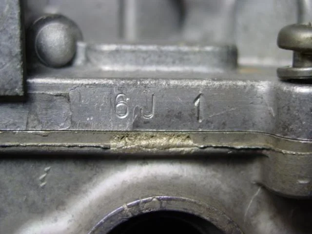

Here's a 1987 carb. Note that the stamping location is changed from top surface to front edge of air horn. The location changed about 1979.
The code translates to 1986 October 1st. That means the truck is registered as a 1987 model year.

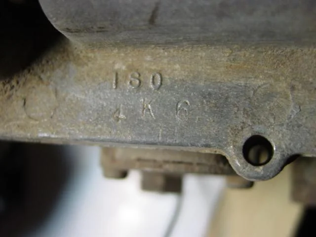

Here is a typical 70-74 F carb.
The code is 4 K 6.
Translates to 1974 Nov 6th.
The carb was built in 1974, but it is a 1971 model, because it has a part #tag of 60202, and had cable linkage and no fuel return line.
