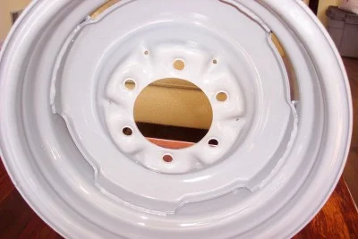

I had my stock rims widened here in the East Coast at Wheel Works in Burlington NJ. He did a great job and they balanced fine and drive fine. They are costly and I spent about $80 per wheel to get them widened. Thats $400 for a set of 5 so its not cheap.
Here is a pic after blasting and powder-coating:
AndrewT
