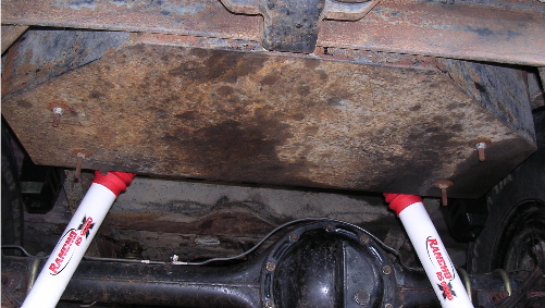

so, I have one of the 22 gallon man-a-fre rear auxillary gas tanks under the rear tub on my FJ. works great.
BUT..... I cannot seem to find out the answer (man-a-fre website does not have it listed from what I can see), nor have I taken the tank off to see, but does that spare tank have the setup on it for a sending unit so I could hook up a gas level gauge? if so, I would like to get another generic sending unit (like on my front tank) and hook it up to a gauage in the truck. just poking around, you cannot see above the tank so no way to tell. __________________ SoCal FJ - 1974 FJ40 | Trail Photos | Parts Wanted & 4Sale My FJ is better than your honor student SPECS: SBC 350 | 4spd | Front discs | Saginaw | 33's | 3" lift SUA | Rancho 9000's | Detroit rear | Dual gas tanks | BeCool aux fan | Sliders | Onboard air | Stamped Bezel |

if your talking about the tank under the rear or a 40... man a fre didnt make those.. they were from conferr... some have the place for a sending unit some dido not.. They were using them as a transfer tank that fills you stock tank.

wantatlc: It actually depends how long you have had the tank. The newer tanks we get out of Australia do come with a sending unit. If you do have the older Con-Ferr unit, I'm not sure if it will have one or not. Companies like autometer make universal ones you can add, but you have to know what your doing when modifying tanks.

![]() that being said, without pulling it, anyway of telling if it does? it came on the rig from the PO. BTW, this thing looks pretty old.... outside is all rusted over and inside has rust so I need to pull it and get it cleaned and lined (are new ones aluminum)? __________________ SoCal FJ - 1974 FJ40 | Trail Photos | Parts Wanted & 4Sale My FJ is better than your honor student SPECS: SBC 350 | 4spd | Front discs | Saginaw | 33's | 3" lift SUA | Rancho 9000's | Detroit rear | Dual gas tanks | BeCool aux fan | Sliders | Onboard air | Stamped Bezel |

yeah, now when I go look, it is NOT a skid plate. it is the tank itself. 4 bolts hanging low AND I can see the gas outlet hose coming out of the tank versus coming out of a hole in a skid plate then going to the tank.

Yes I took the aux tank, used a hole saw to cut a hole just big enough to fit the float and rod in, figured how the rod needed to be bent, drilled holes for the cap, cleaned the tank about a million times, RTV around the holes and screwed the cap down. Doesn't leak and works well.

That sounds like my old gas tank. It bolts to the body with four long bolts. That tank had a sender hole in it.

When you say it bolts to the body, which part of the body? I think I might have the same kind, mine bolts to the floor with three very long bolts that go through the tank itself. There are tubes welded all the way through for the bolts to pass through. Mine does not have a hole for the sending unit though. How is everyone's elses tanks attached to the body? Does it mount to the frame or the floor of the tub? |

That's the tank I have and I was worried that it would get ripped out by a rock. So I made some brackets out of angle iron and welded the angle iron to the tank. Then I bolted it to the frame for a more solid mount so I use a skid plate for the tank.

Thanks for the pics. Mine looks almost exactly like that, but I guess all of them are probably that shape. Have you noticed any problems with the bolts warping the floor with all that weight? Since mine's out of the car right now I'm thinking of doing the same thing greenfox did, or I might make up some heavy duty tank straps to support it like a jeep tank. Where in Socal are you located? I'll be interested in learning how you set everything up once you're finished. |

Mine seems fine on warping the floor. All there are are LARGE fender washer (above and below) spreading the weight across the floor. I notice no ill effects above or below the body. BUT, after looking at greenfoxes setup, I suspect (as I always seem to modify my stuff) that when I take this out to clean it out, paint it up, I will get some simple angle iron and add some reinforcement as well. not that I really need it, but m0re becuase if it is out.... that is an easy project for me so WTF? BTW, I am up in North County..... I have a prety full Aux tank, but after all of this, I am going to start drawing from it and run it dry and do the job ASAP as I can still run off the main (then swap and run off the aux while the main is done). I called a few radi places today and range seems to be $100-180 to clean, prep, line a gas tank locally. I thought of doing it myself, but this seems to be a lot of toxic crap (cleaner, liner, etc.) and I have no means of disposing of it, so it is a project I must pay to have done. __________________ SoCal FJ - 1974 FJ40 | Trail Photos | Parts Wanted & 4Sale My FJ is better than your honor student SPECS: SBC 350 | 4spd | Front discs | Saginaw | 33's | 3" lift SUA | Rancho 9000's | Detroit rear | Dual gas tanks | BeCool aux fan | Sliders | Onboard air | Stamped Bezel |
