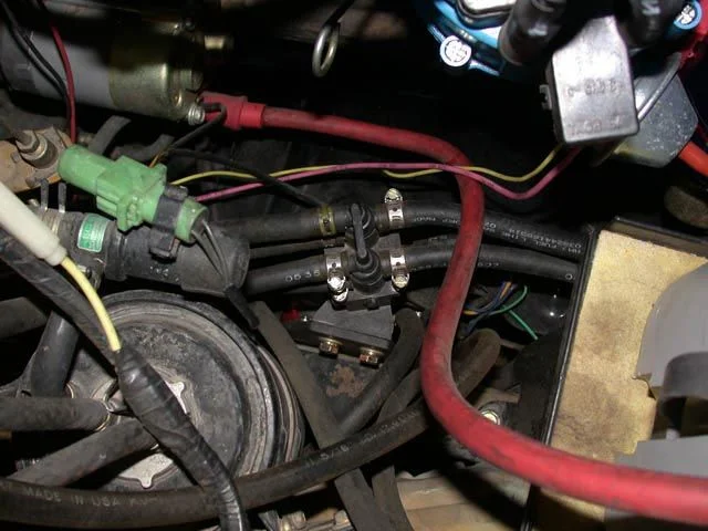

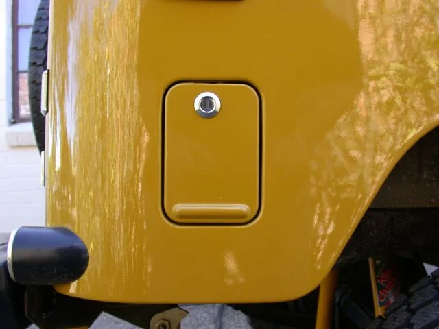

Fuel Door Location
Inside the Wheelwell
The Pollak Fuel Switching Valve

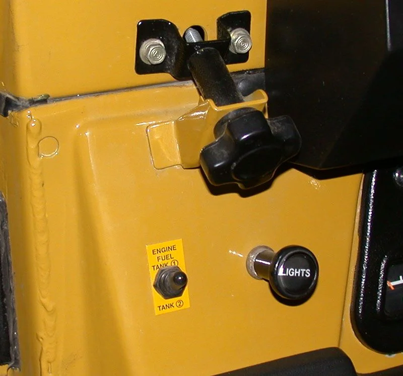

This is where I put the switch.

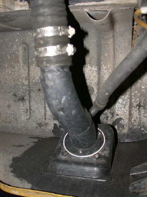

here's mine, I found an old confer unit and modded it to fit......
