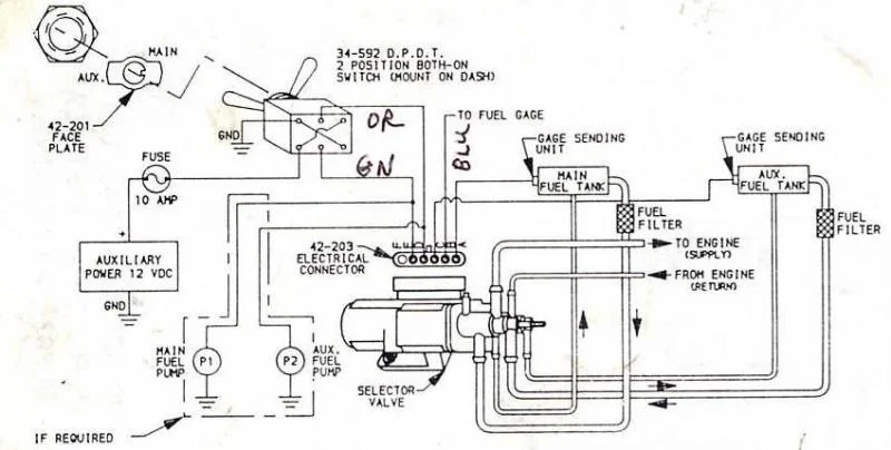

wiring 2 tanks to 1 gague?
so, I got to thinking and wonder if this will work?
if you ran both leads from the sending units on 2 different tanks (your main and the auxillary) to a 2 position turn knob and then from said turn knob on to the post on the after market gas gauge on my dash that is currently setup to read just the main tank, could you not then turn the knob and switch between readings from 2 tanks? NOTE: both tanks would use the same brand/style sending unit made to work with the same style/brand gague on my dash so perfect compatability.
BTW, I know there are cool systems mentioned that with the flip of 1 switch can change tanks and use 1 gas gauge.. but you can see I already have a menchanical handle in place for selecting bewteen my 2 tanks and this setup I purpose, if possible, would only require a $4.00 turn knob.
can anyone with better wiring knowledge confirm if it is infact as simple as adding a turn knob between the gauge and both sending units to make it possible to flip flop between 2 tanks on 1 gauge?
if it is possible.. what type of turn knob configuration do you need? (i.e., SPDT - single pull double throw)

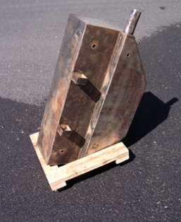

wantatlc: It actually depends how long you have had the tank. The newer tanks we get out of Australia do come with a sending unit. If you do have the older Con-Ferr unit, I'm not sure if it will have one or not. Companies like autometer make universal ones you can add, but you have to know what your doing when modifying tanks.
Steve-O.. I'd say I have confirmed my tank has NO hole for a sending unit (I was able to get in a very awkward postion under my rig with a flashlight and saw over a frame rail). so, I was curious, if I install my own.. are there baffels in place in these old tanks that would determine where you can cut a hole? I have seen pictures of the newer tanks with the sending unit off to the far right (drivers side)... but wonder on these old ones with no hole if I can place it similarly or will you end up right on top of a baffel and screw yourself? or, are the old ones like this baffel free so I can place the hole about anywhere with no issues?

Yes I took the aux tank, used a hole saw to cut a hole just big enough to fit the float and rod in, figured how the rod needed to be bent, drilled holes for the cap, cleaned the tank about a million times, RTV around the holes and screwed the cap down. Doesn't leak and works well.
how did you avoid the baffels? did you just get lucky or did you locate them somehow before making the hole? please advise if you can.

Are you able to look through the filler hole? If it's like mine, I can see the inside of the tank through the hole and see the other end, so I know mine doesn't have any baffles.

If there were baffles, I assumed they would probably go from top to bottom, to give the tank some structural rigidity as well, but have holes or slots to allow gas to pass through without sloshing back and forth. But I could be wrong, since mine doesn't have any.
Mine tank looks almost identical to yours from what I can see, with the fuel filler tube coming out near the top of the passenger side of the tank. Meaning even if the baffles were attached from the top, they should large enough that you'd still be able to see them. The filler tube is pretty wide, I'm able to look inside and see a good portion of the opposite side of the tank. If you had a little mirror, you could probably look at the entire inside if you wanted to.

it appears, as per answers from this topic my 2 tanks will work with 1 gauge using a SPDT switch (which I also got today in a paddle switch configuration... wanted a turn knob, but were impossible to find) between the 2 sending units.
