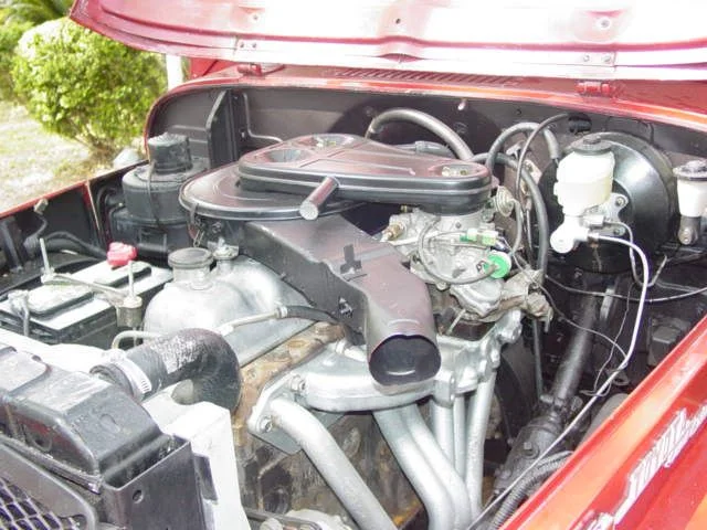

I worked on the truck for 10 months in my spare time. I have gone through everything now, creating a dd
Primary use:
DD/ business marketing tool, tinker toy
Secondary Use:
Touring Fla, camping, fire roads, and novice 4x4 events.
Driveway Mods Completed:
Rustoleum DIY oil based paint
Vintage 15x10 Vector wheels
33 x 12.5 x 15 Firestone Destanation AT
JTO Disc front brake conversion
1.5” wheel adapters (4)
2” wheel adapter (1)
LCR4WD Disc rear conversion (Poser)
Speed Bleeders (4)
4 Runner booster w/external vac check valve
80 series master
hard lines
soft lines (6)
Old Man Emu 13 front leaf springs
Old Man Emu 14 rear leaf springs
Old Man Emu bushings
Black Diamond shocks (4)
Greasable Spring Pins
Greasable Shakle Bolts
2” Shakles
Extended U bolts
MARK's OFFROAD HD U bolt skid plates (65SWB45)
4* caster shims
oem tie rods
oem relay rod
Center arm rebuilt
tres (5)
Black Diamond Stabilizer
Knuckle rebuild
New bearings (8)
rebuilt warn hubs
Rebuilt asian carb (fj40jim)
oem pcv
oem air filter
Edelbrock Sor 2 piece header
Tpi4x4 metal manifold gasket
Sor mid pipe
oem muffler
Sor tailpipe
1200* high temp silver rattle can paint
74 4 speed tranny
2f bell housing
72 3 speed transfer rebuilt
vac to manual transfer controls
Parking brake rebuild
74 drive shafts
oem drive shaft hardware
74 3rd Flanges and oem seals
asco clutch
asco pressure plate
oem Throw out
oem Pilot bearing
oem Clutch fork
oem clutch fork boot
oem fork pins
oem clutch ball
clutch master
clutch slave
clutch hard lines
Resurfaced flywheel
oem flywheel bolts
oem motor mounts
Flowed radiator
oem hoses
oem radiator cap
Oem tank repaired
fuel lines
Fuel petcock
Sylvania Silverstar headlights
Oem b/u, signals, side markers
Interstate Battery
Wix fuel filter
Wix oil filter
Shell Rotella 15w 40
Gates green stripe belt
Oem tail light brackets
71 oem steering wheel
Adavance / Discount auto round taillights
Oem rear step
Oem rear bumperettes
Confer rear hitch
JTO front Bumper
oem tow hooks
oem bumper supports
dash cap cover
oem license plate holder w light

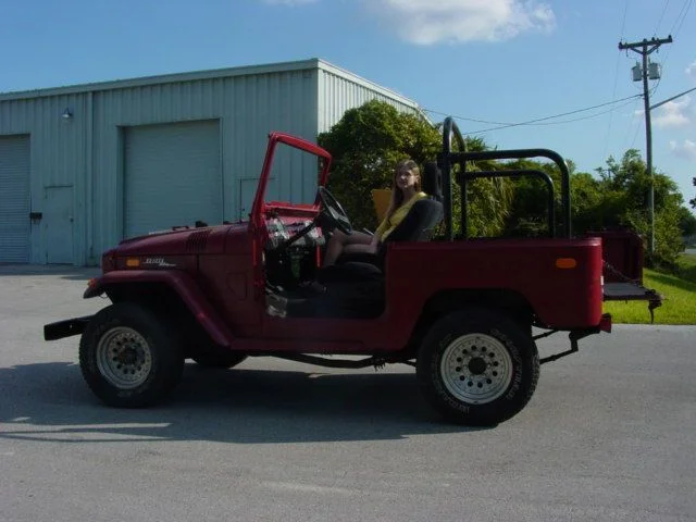

before pics

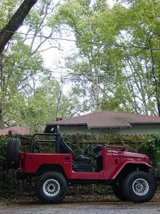

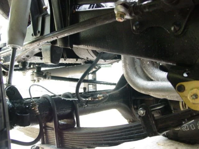

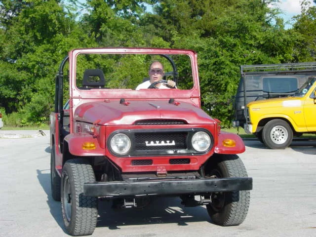

after pictures

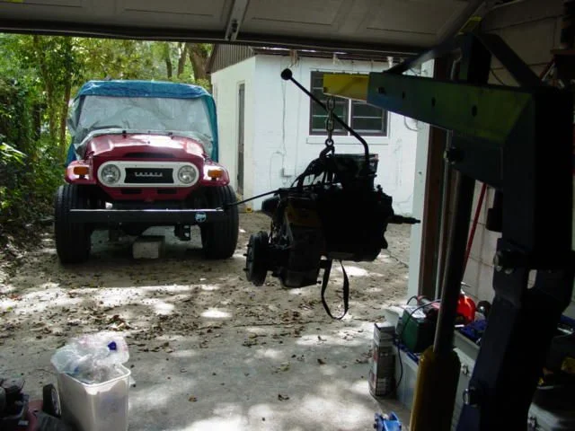

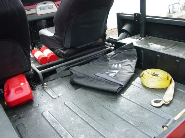

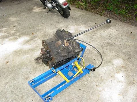

Looks good but i got to ask, is that a motorcycle jack under your tranny in the last pic ? I never thought of that myself.
__________________
Proud Patriot Guard Rider
Only two defining forces have ever offered to die for YOU, Jesus Christ and the American GI.
One died for your soul and the other for your Freedom
Looking for a hardtop for a 45 lwb. Along with all hardware.
krzyabncanuck is offline   Reply With Quote
Old 03-07-06, 06:46 AM   #6 (permalink)
North Florida Cruiserhead
mel lowe's Avatar
Join Date: May 2005
Location: The Sunshine State
TLCA# 19409
Posts: 2,034
krzyabncanuck-
yeah I used a motorcycle jack to help install/ remove the tranny.......
sams $69.00
I also used a 2 ton cherry picker.......
sams $169
I was able to complete everything with the help from these and a few other
floor jacks.

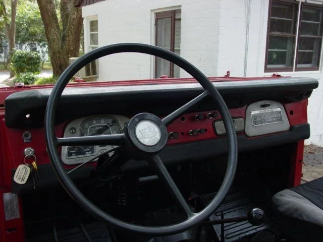

looks good
make sure you put the bezel on the right way

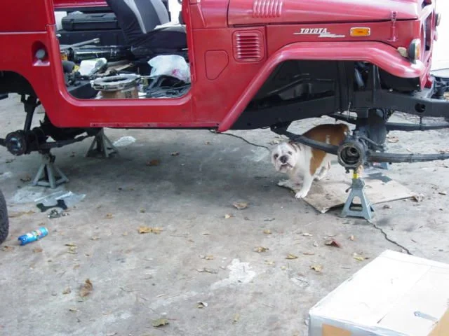

Nice rig! Cool Bulldog too. I miss mine.

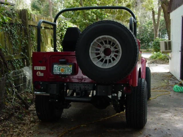

Posts: 2,034
land cruiser steve- I am driving the cruiser to st simons island in april....... wanna meet at the ga pig for lunch?
fl cruiser- almost ready
I have been "road testing" the cruiser this week.....
all is good
need to:
install lights
install seatbelts
install windsheild
wire guages (2)
I have the parts, yet no time to install.......
SLAMMING AT WORK!!!!! Weekends are the busiest. ALSO
This weekend is "parents meet the parents"....... and I plan on
driving a few more "test miles" before leaving the city limits....
FOR SURE next event....
gathered a few trail parts:
spare birfs
spare hubs
spare flanges
spare dshaft
tow strap
I did deliver a 2 pizzas today in the cruiser......
fun in the sun

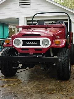

crusin' round town
jim c- my carb is working PERRfectly thanks dude
merv came by to see flo
