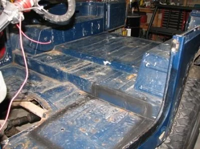

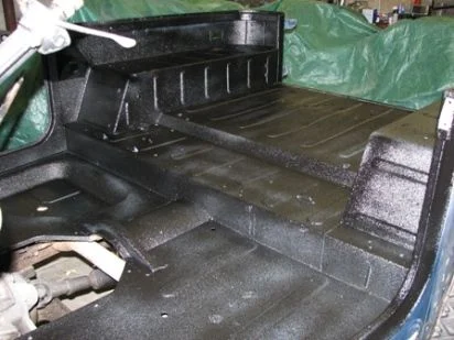

Hi all.
I figured I should put in some sort of liner in the 40 while I had the cage out, So here it is. This is my first time doing such a project so bare with me.
Its an epoxy paint liner, You can brush/roll/spray, I sprayed, The palce I bought it at sold it for ~$60, I could have bought a colored liner at $80 + ~$40 for the color, I was going to go with blue but I told my wife it would be around $55....Most of us know what I was trying to avoid
But first off there is a bit that will go into doing a spray in bedliner, First off I filled some minor holes in the boy from fender flairs with some POR15 puddy, It seems to work out nicely. Secondly I removed ALL the bolts even the soft top snaps and marker lights.
More to come

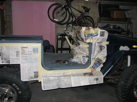

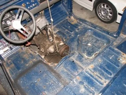

Then I set about on sanding all the parts I was going to paint, It suggested 120-220 grit. It took some time to get all the nook's and cranny's but I hand sanded all the tight areas while the compressor filled. After that I vaccumed out the rig to get all the debris out then I used acetone to clean up all the paint dust and have a good clean canvase. Now I masked off ALL the area's I didnt want lined(belive me if you think it might get liner on it cover it!) After I masked off I gave it a prime to cover all the bare metal and I let that sit for about an hour to cure a bit.
I remover the jack box or whatever its called, If someone wants it let me know, I drilled all the spot welds and plased the welds.
Now comes the fun part....

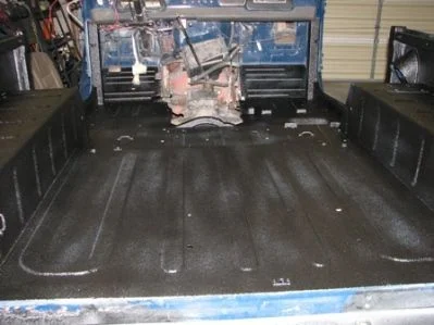

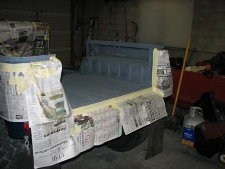

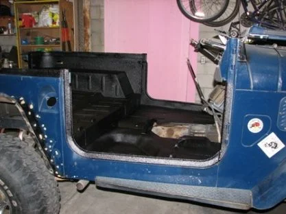

So to the fun part!
When I finished the masking I made sure I had everything ready to go, I have the regulator on the compressor set to ~45psi, the acetone was ready for clean up. I read and reread the how to on the liner, The sprayer would only hold about 1/3 of each mix, ther are 2 parts to the mix. I started to mix up the 2 part and let me tell you it was some of the most foul stinky stuff I have smelled in some time. I got it all mixed up and put the Schutz sprayer together and try it out on the rear doors first to see how it worked, I cant tell you how nervous I was when I was just about to spray for the first time, But after the first few pull's and with everything going well, I finished the rear doors and headed to the tub, I had to make 3 mixes total and had a little left over but I couldnt use it.
Here is what it looks like, It will need about 72 hours to cure due to the temp.
I didnt spray the trans cover due to not knowing if I will need to patch some holes for the NV4500 install.
Well, I think it was a great day's work and also a great upgrade!
If you have any questions feel free to ask, Im sure I missed something.
Have fun

Looks real good. I like how you carried it around to the outside where the doors seal up. How long did it take you to lay it all out?

I figured I would do it around the door frame because it is kind of a area that might get scratched up easier.
The lay out went fairly quick, Only about 30-45 min. for masking, I knew what I wanted to get painted by the time I finished sanding.

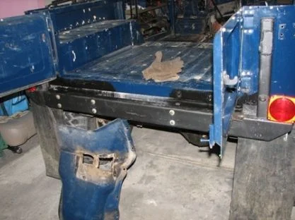

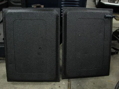

Here are the doors, I simply layed them on some cardboard and masked off the latch.
I think I will use this again on the trans cover and under the tub.
Good luck
